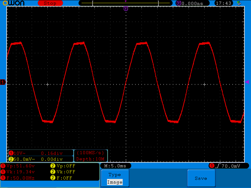

While measuring stuff I noticed the input VAC looks clipped? I didn't see this before while dealing with power transformers.
Is this normal?

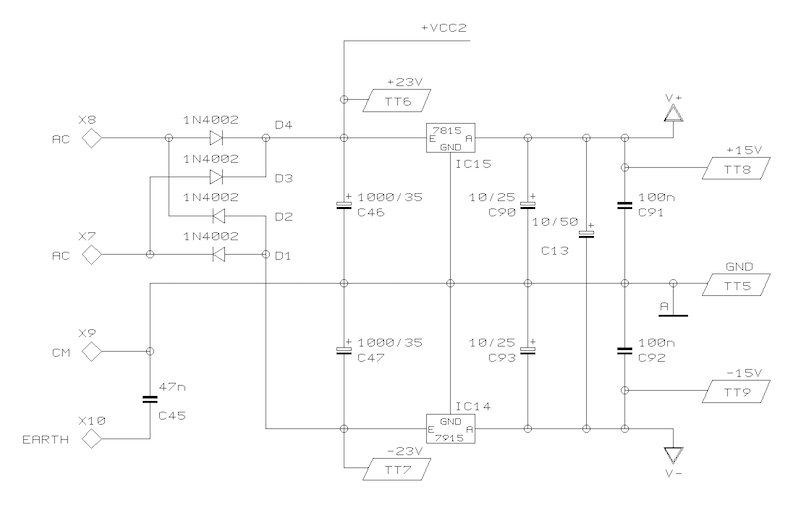

The transformer seems to have a 37VAC rms secondary center tapped for two 18.5VAC rms output. I see written on the transformer that secondaries are at 18.3VAC / 0.4A so that makes sense.
The whole unit draws about 35mA /230VAC. Works at about 8W total power consumption. Or about 100mA per rail with only two LEDs lit up.
For some reason the top side of the LEDs don't light up, the ones indicating input/output signal presence. Must check the daughter board.
100mA per rail from 400mA that the transformer can deliver seems pretty decent. Doesn't seem that there's something wrong with the power supply.
I just don't understand how come the signal is clipped.

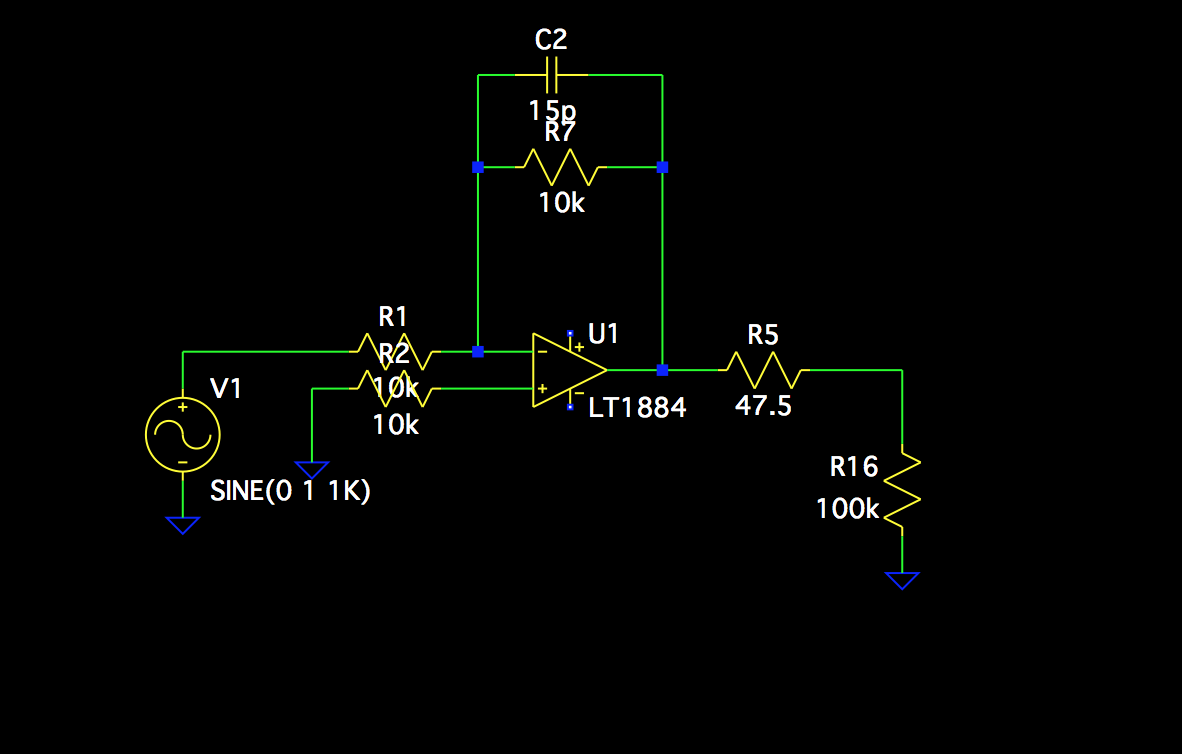

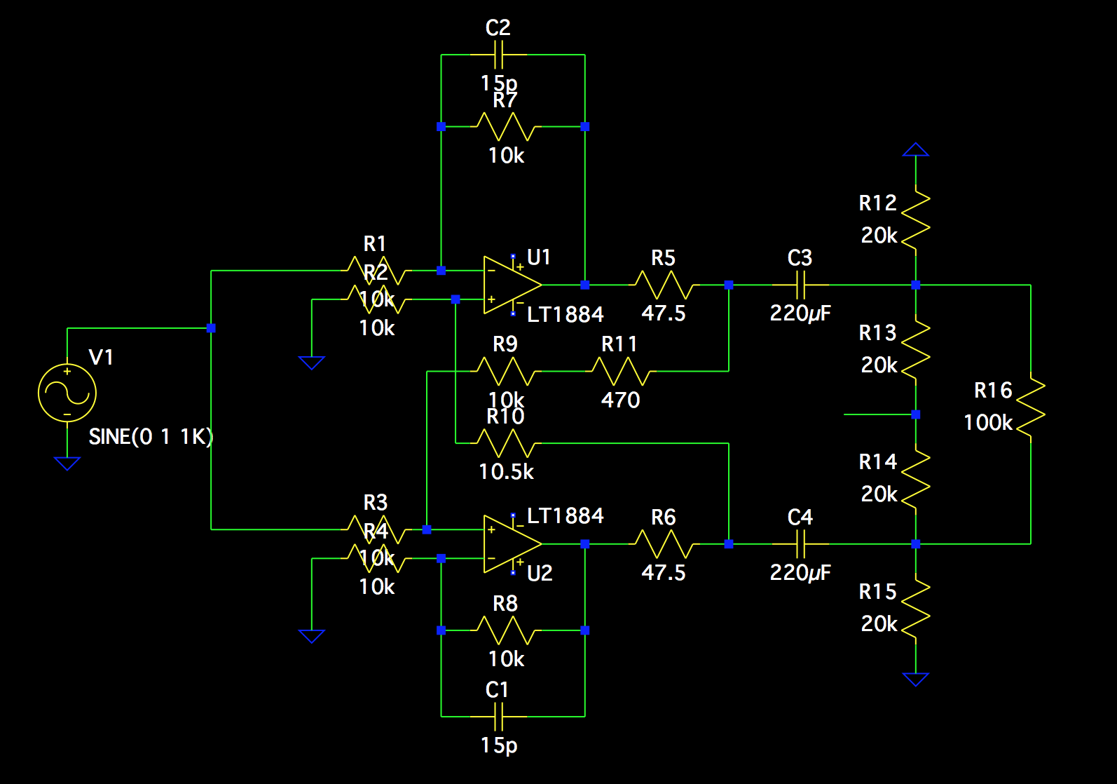

Since I don't have a balanced input into my amp I was thinking of removing some components from the circuit. The adapter cables I use put one line at ground, therefore rendering one output op amp useless (as I see it).
Also the symmetry adjustments serve no purpose at this point.
Can I adjust the output circuit like this? I attached before/after of the circuit.

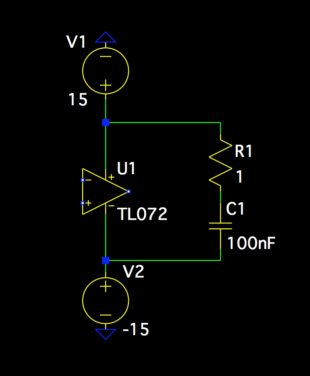

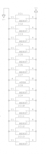

The 'blanket' will be noisy power supplies - so what Xoc1 said. Except instead of 100nF across the quad opamps' power pins I'd go all-out and fit a low ESR 'lytic there, at least 470uF on each.
470uF? Isn't that like many orders of magnitude higher than what is usually used? Like 100nF?
I tend to favour rail to rail. A 100nf ceramic is ideal but I would perhaps include a series 1 ohm 0.25w carbon resistor to eliminate any possible ringing... which is highly unlikely tbh.
You mean like this?
I'm making the order for parts tonight so I might as well do it right. But I don't like going overboard with values. Like 470uF, I don't understand why a value that large would be beneficial in that spot.
Yes like that. There isn't always a right and wrong over issues like this, many have their own methods and solutions. There will already be decoupling on the PCB, probably small electros ? Adding the 0.1uf just clamps things down at HF where the electros start to lose effect due to their rising self inductance. The series resistor just tames any tendency for any voltage spikes on the rails causing ringing.
You'd be surprised...

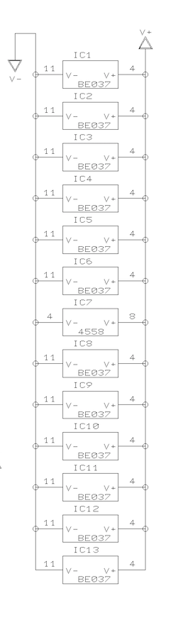

I found nothing on the pcb.
The only capacitors from the power supply are the two main ones behind the regulators, another two after the regulators on each rail, with ceramic 0.1uF bypassed and another 10uF between the rails.
To be hones the 10uF one is all the way where the first op amp is, probably because the traces go to the op amps from there.
Also the schematic shows only what I mentioned. So no bypass at op amp location.
Ah, forgot.
I will buy new op amps as they are cheap. 4$ for all 12 quad TL074.
I can't buy the more recommended lower noise higher slew rate ones as they are expensive and cost adds up.
But I could get 4 different ones for output or crossover duties if some would be more recommended than the TL074 ones.
Must be dual supply.
TL074 are JFET-Input.

Op amps have no decoupling, the ps is crap, -14.5V on the negative rail.
General purpose electrolytic capacitors in the signal path.
Fuse has been bypassed with a wire kind of used&abused unit.
All this and you're still saying to keep it stock and listen to it like it is?
