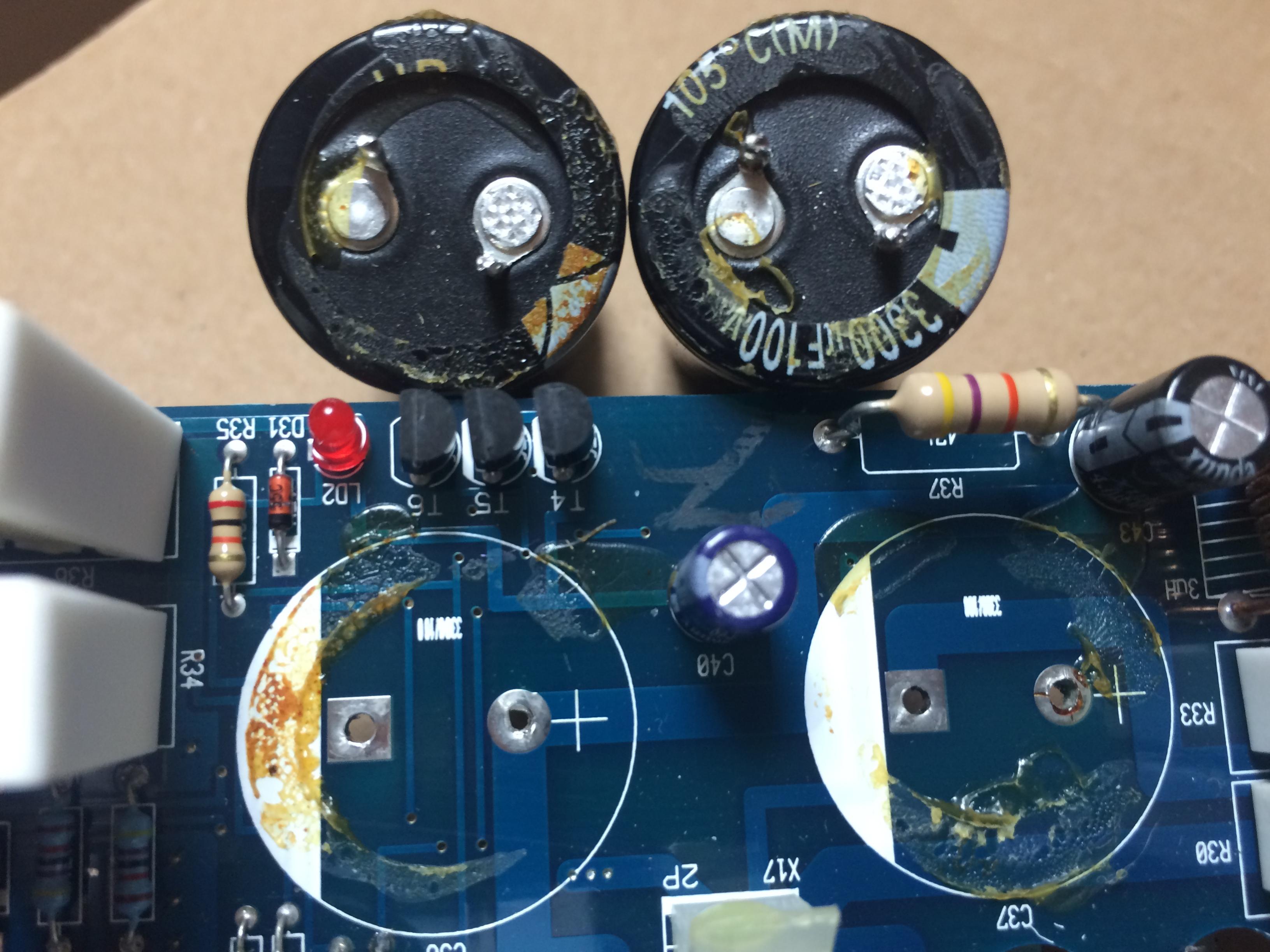

The bad channel died completely so I decided to open the amp up. I got out two big caps shown on the picture. Is it how leaked caps supposed to look? Or is it some kind of paste which is used during assembly?
To follow up on this. Replacing the caps did not fix the problem. That residue on the board does appear to be some glue.

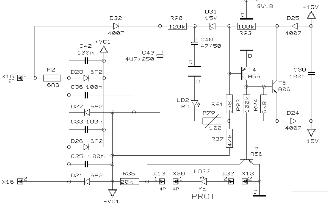

On further testing I have seem to localize the problem to the power module (?). It's schematic is given on the picture below. Connectors X16 go to the toroidal transformer.
The measured voltage across two diodes D25 and D24 is not 30V (as it is on a healthy channel) but is around 22V when the amp is turned on and then slowly drops to 11V or so.
Since I would like to avoid replacing every element in this thing, any ideas on what could be bad inside this module?

Hello,
are you sure that it is the power supply? If the amplifier has failed components that are shorted or parasitic, it could be causing this voltage drop you are seeing.
unless you isolated the psu from the amp itself? if so i would check for failed capacitors with a capacitance check, there could be a cap intermittently shorting when it fills above a threshold which would cause a voltage drop. (and would discharge when you turn the amp off, essentially resetting itself.)
If you had not isolated the psu i would suggest doing so if possible.
Hello,
you could try that, i would suggest isolation by somehow removing the +15 and -15v feeders from the load, and leaving the diodes in. Since i dont know how the circuit will act without the diodes (probably no difference with them in or out, but just to be sure)
judging from the schematic: the psu unit feeds its load with the +15 and -15v outputs (the ones coupled to C30) which these "15" values are in refrence to a ground (the ground seems to be the -VC1) So what you could do after you isolate the psu is measure the -15 to ground (dmm lead one on ground and dmm lead 2 on -15) and the same on the positive 15 side (reference it to ground) this would give you more insight into which side has a failure (pos side or neg side) IF the psu is to blame.
E.G. if -15 to ground measures fine (-15v DC) and +15 to ground measures fine but then dips. you know there's an issue with components that are on the +15 side.
Another way to test would be to check the amperage flowing out of the rails.
(just a note, regardless of the polarity of the rail you are testing, the black dmm lead goes on ground all the time. Even if the rail is -15v. Because with the black lead on the ground then your voltage should be negative, this is ok)
If the psu is fine, it seems like theres something awry in the components downstream of the psu. (obviously, i dont really need to tell you that) but does the amp show any other symptoms?

First the whole schematic.
Here you see that there is a separate +/- 15V supply circuit.
Measure the voltages before and after R40 and R41.
Calculate the current flowing through these resistors.
I do believe that Behringer made an error in writing that the supply is 17V. Either 15 or 17V. Not that it matters a lot; as long as they are there.
I never had an A500 in repair but let's see if the power supplies are OK.
Next step is to isolate the problem.
My first guess is either a bad zener diode or the following cap (eg. D34 en C64 and/or D33 and C63)
