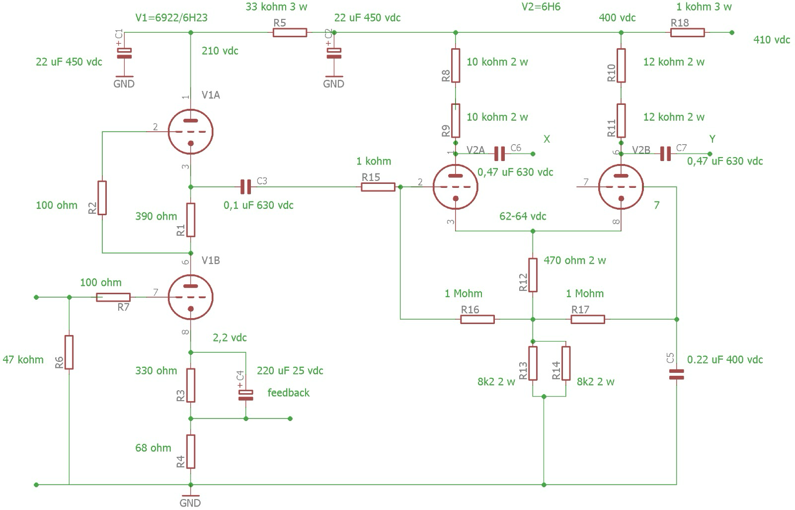

Yes the cathodyne is always balanced, provided it is symmetrically loaded. In that circuit you can see that as far as AC is concerned, the cathode is loaded by R2||R5 which together make 20k, which matches the anode resistor R4. (R1 and V1 are very high impedance so they have negligible impact on balance in this example).but in the meantime, do you think your analysis would hold for a Cathodyne used to bootstrap the load on the i/p valve?
http://www.r-type.org/articles/art296d.jpg

Was it almost universal though? I haven't done a survey! Certainly it would not have been a scam. Amplifiers got more powerful, so more would be using bigger bottles that need more drive voltage, which a cathodyne might struggle with. And the cathodyne has always foxed a lot of designers -Byrith is a perfect example- whereas the LTP was well established early on. So I guess it may have become just another 'design trend' to use an LTP.Peter & Merlin, do you think the almost universal move to the LTP in the last of the great valve/tube amps was a marketing scam?
A LTP with a high impedance CCS as it's tail and with equal plate impedances doesn't need any adjustments, nor is it sensitive to tube differences. Can't state for the Paraphayse, though.LTP and paraphase is dependent on some measurment to adjust, and are sensitive to tube differences.

"A LTP with a high impedance CCS as it's tail and with equal plate impedances doesn't need any adjustments, nor is it sensitive to tube differences."
True as long as the triode halfs are similar. But it's also a more complicated setup
I'd say that in a wide range of applications both LTP and Concertina are fine. My usual approach is:
- anything that requires <= 20Vp for the output tubes, I use Concertina
- For the rest, LTP.
Many many years ago it has been shown here that even with rather dissimilar triodes, such as half a 12AU7 and half a 6922, AC symmetry is granted. It is really easy to comprehend: If the plate current in one triode rises by some amount, the plate current in the other triode consequently falls by exactly the same amount, and vice versa.True as long as the triode halfs are similar.
