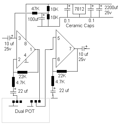

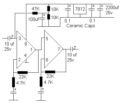

Please find attached picture. It's working when 1st amp is set GAIN = 1
Any REMARKS ?

Hi
what is this supposed to do?
-- > using preamp for mini sub
Why two cascaded stages?
--> Prior to this I was using single amp But I did not get good effects.
Why only 12Vdc supply?
--> I am using 15Vdc supply.
I do this all for my hobby. I am not an electronics man.
how this preamp works ? I don't know but It's sounding good for me. In general term I used Dual POT/CONTROL which has 6 pins as shows in attached picture.
