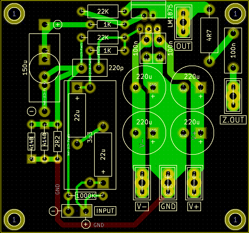

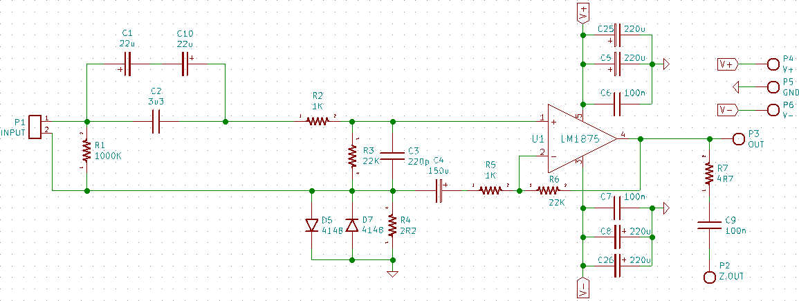

Hi AndrewT, could you have a look at my LM1875 schematic and PCB layout? I searched everything I found in this forum about LM1875 until now and final set for this. But I need to make sure it's ok.
My input cap will be ERO MKP1841 3u3 + 2 x Tantalum 150D 2u2, this combo sound best on my other amp so I still want to use it again.
My feedback cap will be Tantalum 150D 150u.
Other parts will be Pana FC + Dale CMF55.
Thanks!
Thanks!
Remove C1 & C10
Remove C25 & C26
Experiment with C3. Maybe as high as 1nF. Small steps, 330pF, 470pF, 680pF
R4 may need to increase, maybe higher than 10r.
Add L||R between output and speaker terminals.
replace D5 & D7 with power diodes. Try 1n4001 or similar.
Remove C25 & C26
Unstable amplifiers have a sour tone and extra heat (fingernail size thermal interface of LM1875 won't forgive that). Therefore we should add the output filter parts as AndrewT indicated, so that we don't have a hot amp with a sour tone.
I would really appreciate it if everyone would go ahead and add the Thiele-Small output filter.
After adding the stability helpers, then the finish-up job of adjusting the gain suitably, is much easier and with a more productive outcome.
If snare drum is PFFT!!! and the audio is boring, the gain is too high.
If female singers are terribly angry and the amp is too hot, the gain is too low.
