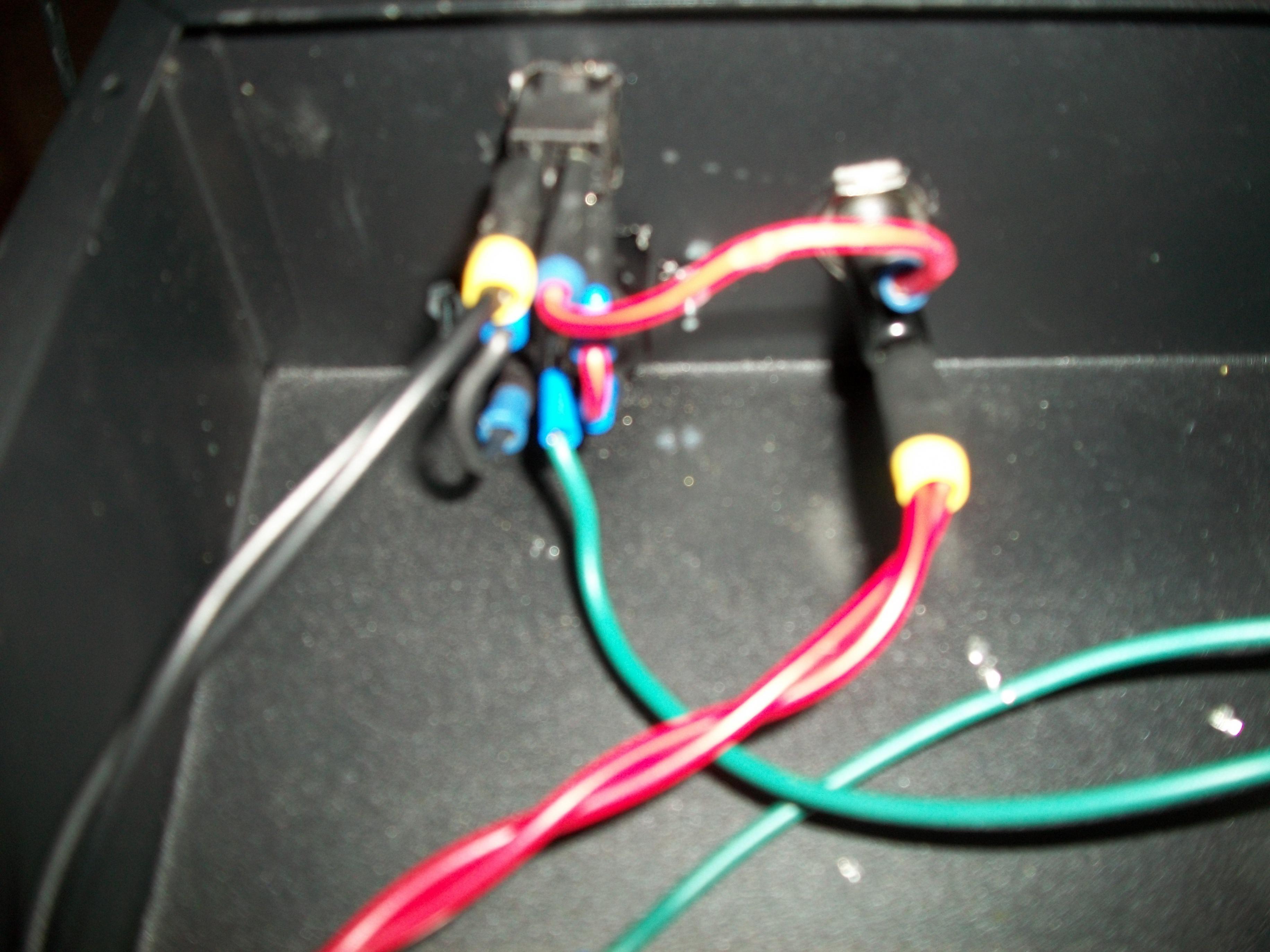

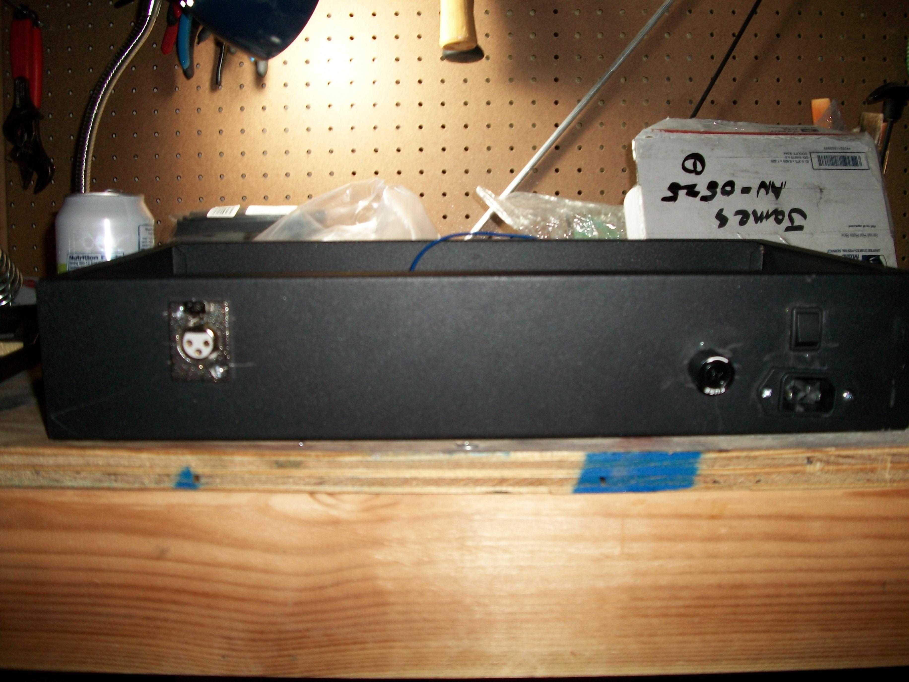

So my first step was to deal with the power supply case. Sadly, I did not think this through, and focused only on the backplate--installing the ac jack, switch, fuse, and power out jack. I had no idea how to get the proper sized holes, so did some experimenting with a friend and ultimately came up with the photo below using a drill and a dremel. Note the various scratches and the slightly misaligned plug. My thoughts on tools: a drill with good bits is necessary. The dremel is very, very useful as a cutting tool (use the drill for the corners, the dremel to cut the rest), and useful if a bit tricky to use as a grinder, to get a close fit for the jacks and such. I believe that a good set of files would be helpful for this and possibly easier, so will pick one up the next time I get to the store.
If you read other build guides (this is a great example for an F5: http://www.diyaudio.com/forums/pass-labs/188691-illustrated-guide-building-f5.html) you will see the right way to do this. Not only do the back/face plate, but the bottom (and sides, if necessary). Lay everything out, make sure you are comfortable with where it will all go, and put in all holes, including in the base plate! I did not do this, and have a few extra holes as a result. Also, don't drill late at night after an extra glass of wine.
Were I to do this again, I would look for a combination plug/fuse holder/switch on a rectangular plate, as that would be much easier to mount. And, of course, I would lay out the various pieces prior to any drilling. On a positive note, it ultimately worked, but better aesthetics would be nice!

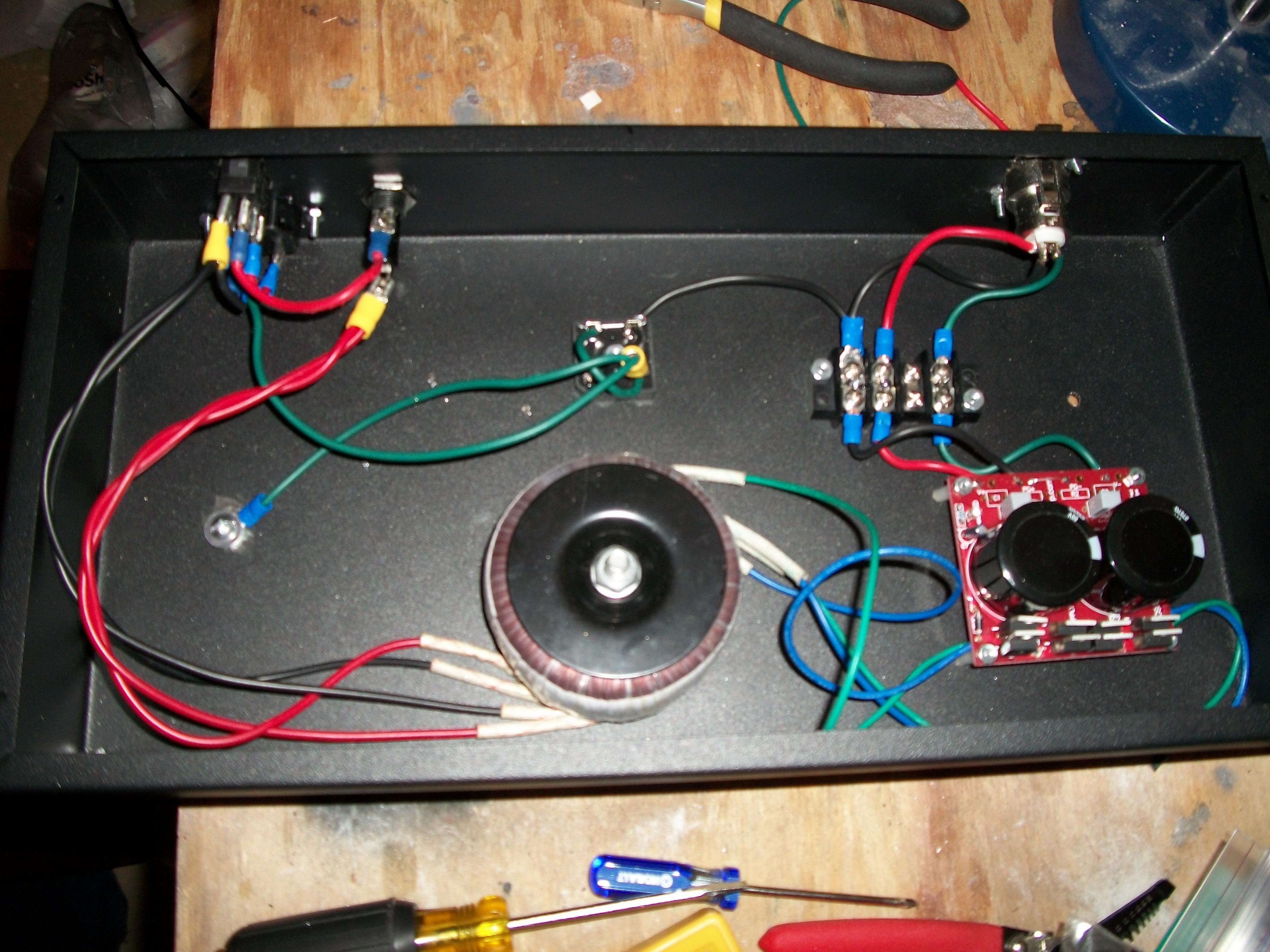

This will be my last post for a bit. The next steps were to put together the pcb, and do the wiring.

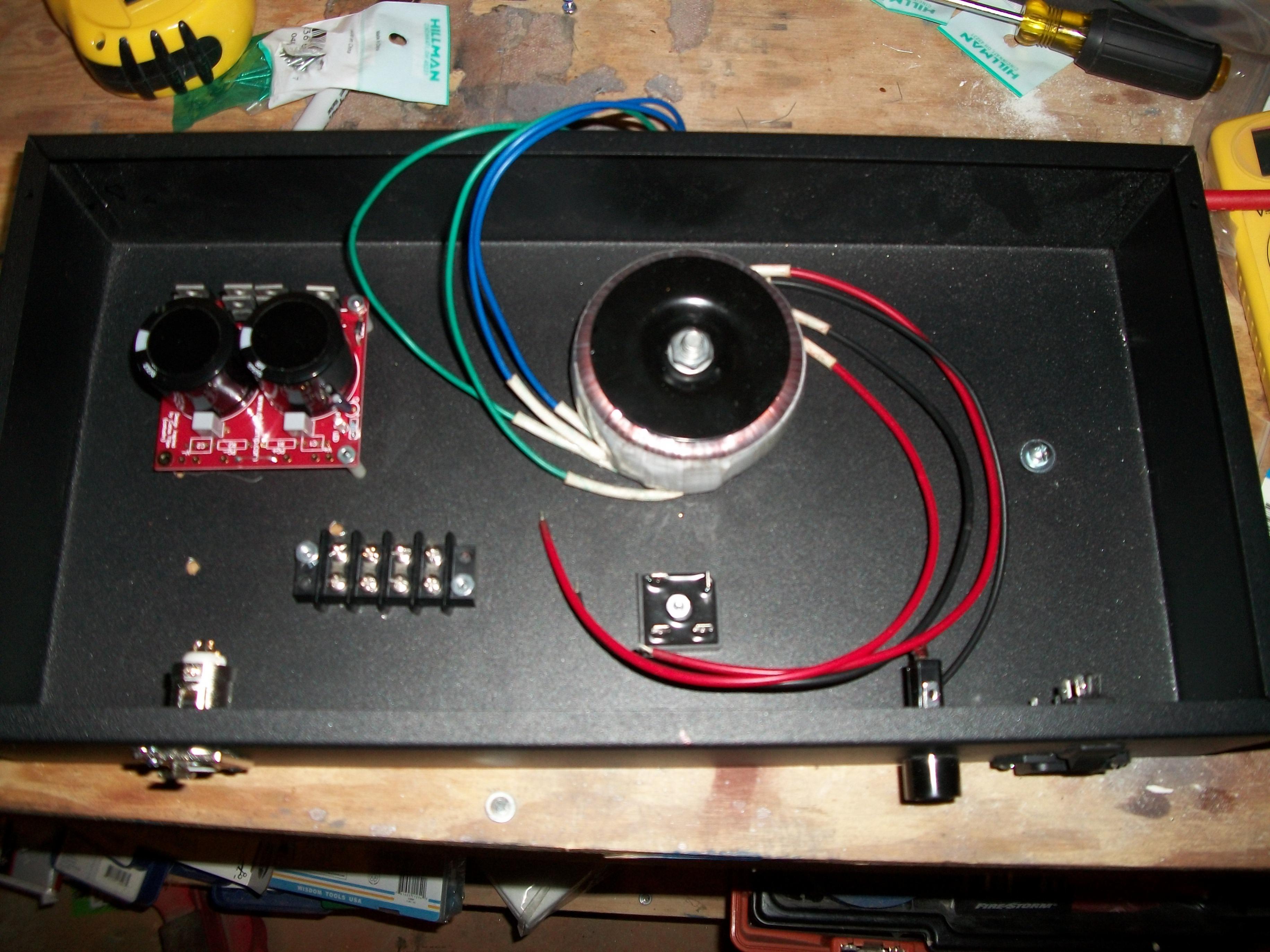

I borrowed the approach of budwiser (see http://www.diyaudio.com/forums/pass-labs/156397-pearl-two-148.html#post2988977 for discussion and link), getting the PS-KIT from chipamp.com (Chipamp Power Supply Kit | Chipamp.com). This kit requires a few changes to be used in this project, but they are simple--see the manual at http://www.chipamp.com/docs/lm3886-manual.pdf. The kit has two ground outputs; they need to be jumped (giving one). It also has a resistor/capacitor pair just prior to the output (1k resistor, .1uf capacitor I believe) that must be left off. Full disclosure, comparing the power supply diagrammed in Wayne's original "how to" Pearl II guide to that of the chipamp, there are two additional pieces left on the chipamp that seem inconsistent--the 2.2k resistor and another .1uf capacitor. I left them on to be consistent with budwiser's build, but I am not sure what they do. It does work, so there is that. Soldering this up, which was a source of worry for me, turned out to be a snap.
As noted in the BOM, I got a transformer with 25V secondaries (that is, it takes wall voltage and converts it to 25V). This is not what is recommended, but I could not find a transformer with 22V secondaries anywhere. I am hopeful this will not matter, but we will see.

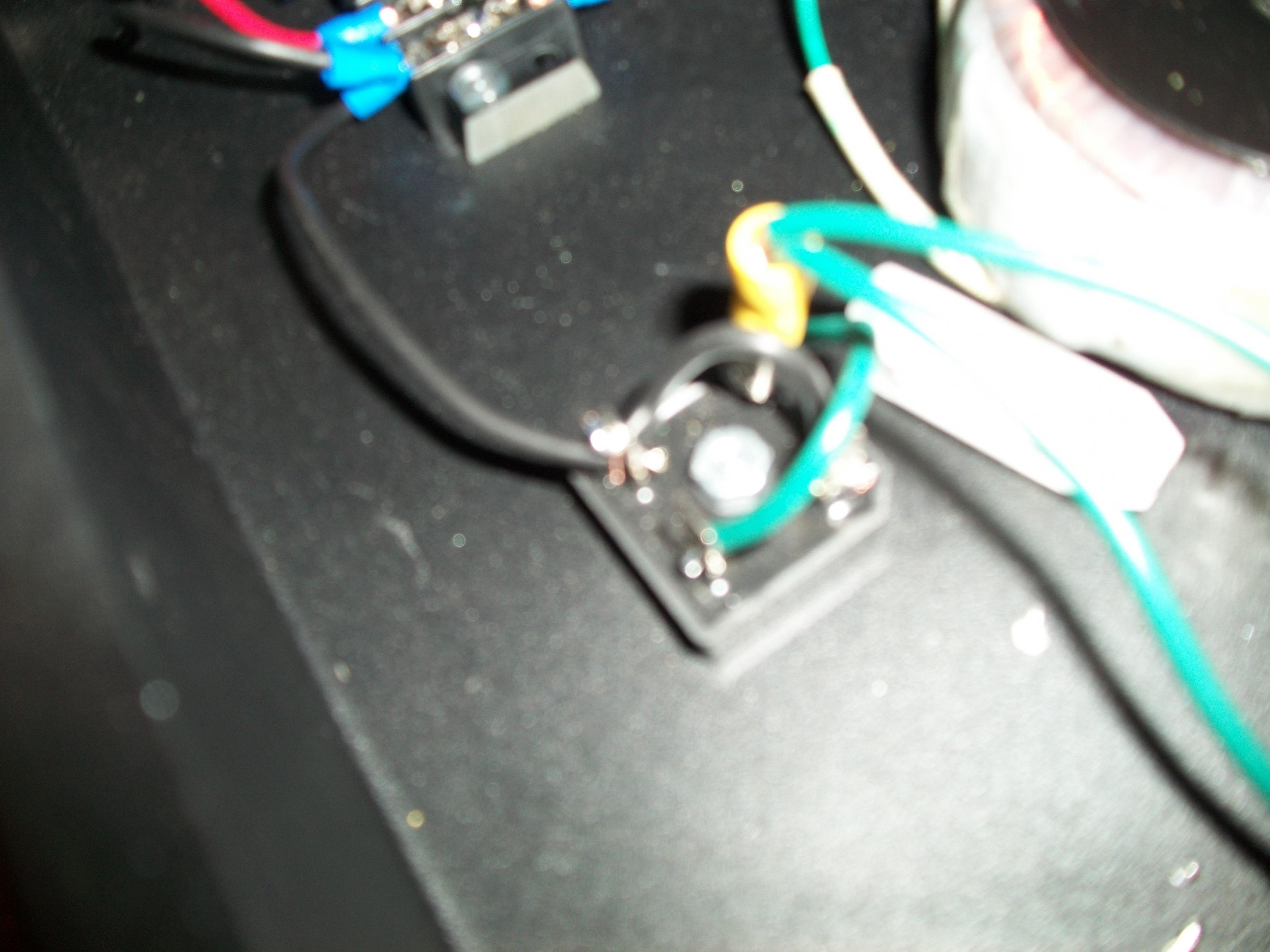

The last step is wiring it together, following the schematic from Wayne and budwiser's photos. It is quite straight forward, with one exception for me. I did not test to make sure I had the right pairs of secondaries (both pairs use a blue and green wire, I belive you can test their continuity but my MM does not have a continuity tester). I misinterpreted a suggestion and picked the wrong pairs. End result--many blown fuses, lots of resoldering, and a day's confusion, but eventually I realized that was where things were going wrong (using the disconnect it all, add one piece to the chain approach, wait for fuse to blow). The picture below is where I am at this point, with 35.6V at the output. This is higher than called for due to the higher V transformer (28-35 is recommended) but hopefully it will work. As noted above, re-reading the guide when I got the link to it to post above made me realize that with all the taking apart and putting back together of the wiring to diagnose the blown fuses, I had left the connections with wall voltage very poorly insulated, which is dangerous. I will fix this. But what you see below is the first actual working circuit this beginner has put together. Try not to laugh at the bad wiring!

One question - is the housing/shell of the XLR jack attached to any of the pins? You need to check.

Is there any particular harm in leaving the RC snubbers in place on the Chipamps power supply board?
What voltage are the electrolytics in your PSU? Just trying to make sure the higher voltage from your secondaries will not blow them within a short span of time. I had 40V ones first, but the 39V rectified voltage in my PSU (from 24V secondaries) was too close to their limit for me, so I exchanged them for 63V ones.
I am pretty sure they are 50v, but will check.

In this pic, your ground isolator (made from rectifier bridge block) is that missing one link? I am talking black wire from IEC socket lands at it but its diagonal pin is not shorted with that black wired pin. May be there but I could not see in the pic clearly.
Best luck!

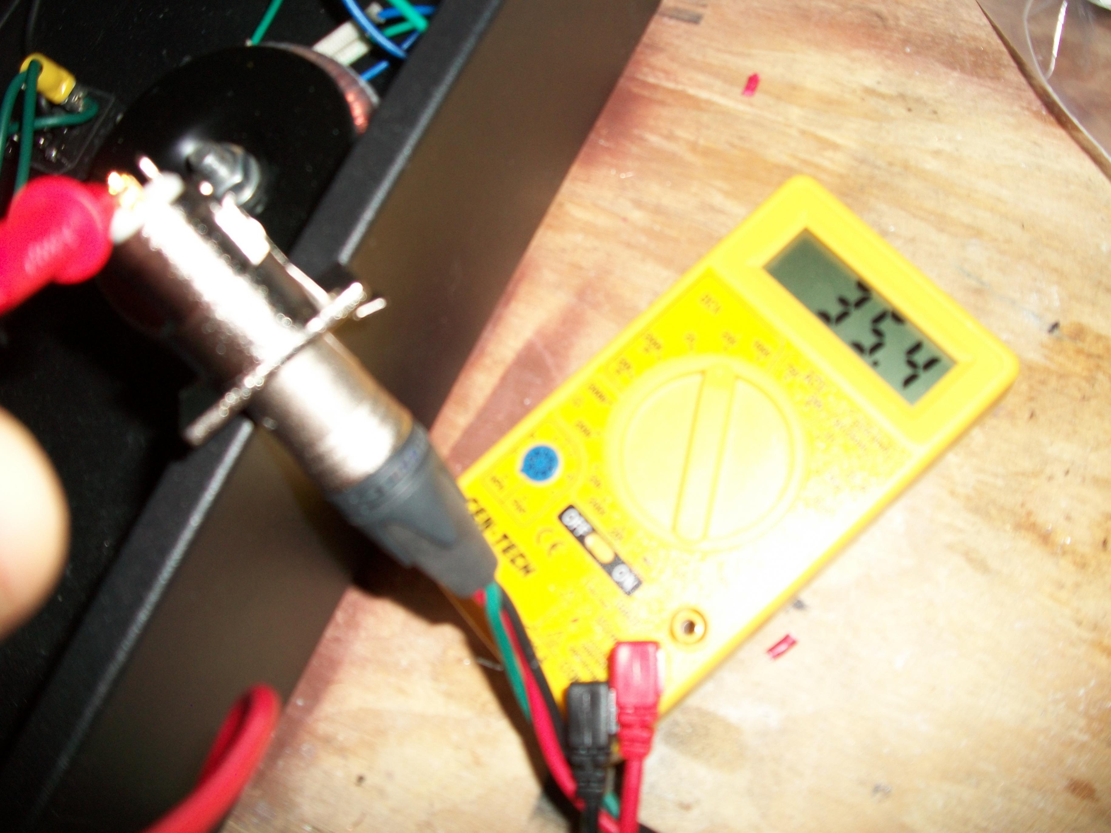

A few additional pictures of the power supply wiring, and one of the result--this is the voltage at what will be the power jack for the Pearl II box. No excuses now, have to start on the amplifier.
With the black lead of your DMM on the black (GND) of your PSU output, measuring DC volts, verify that you have +35v to your red out (V+) and -35v to your green out (V-).
If so, continue to the regulator portion of the RIAA boards.

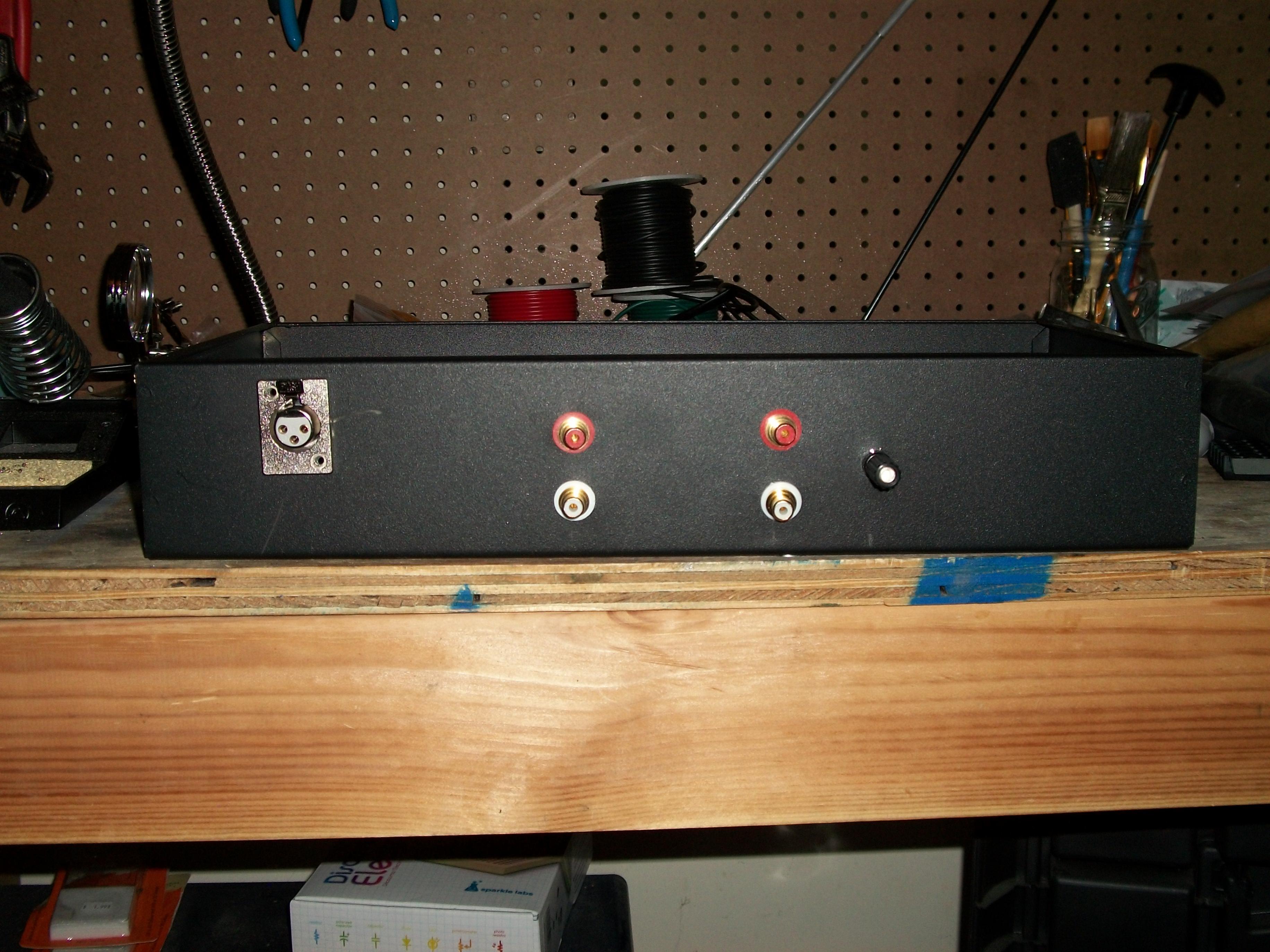

One more small step--many fewer (if not zero) mistakes with this one. Slightly bent case around drill holes lead to rca plugs not exactly straight. One dremel oops around xlr jack. Really, not bad compared to power supply case. Also put in holes for pcb and terminal block.
Nice! If you want to straighten the holes of RCA then use 10mm nut bolt with two thick washers around holes. Remove RCA sockets and use these nut bolt washers. Just tight it around each hole to make it straight. Or additionally use plier to make it (bolt) exact vertical to surface. Refit the rca sockets again. This will protect coating on the surface too.
