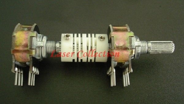

I found a 4ch stepped pot (vishay/Dale) here witch is not to pricey:
Dale 23 Step Serial-Type Balance Potentiometer (Stereo)_Volume Control_Accessories Kit_Analog Metric - DIY Audio Kit
What do you think of it, 10K on the Bosoz output
I also thought about a gear rig to couple two 2ch stepped pots, but it will require quite a lot of work and I'm not really sure this will be as well balanced as with a single pot.
Another solution is using an Alps RK27 4ch pot
look on ebay for same , but with smd resistors
ook Alps
something like that?
Balance XLR Dact Type 21 Stepped Attenuator Potentiometer 10K | eBay
ook?? good, bad?
ook Alps
ook?? good, bad?
politely said - worse
regarding ebay - you need to use some shorting link service - ebay links are gibberish on board
Arf😀 at least I learned a new expression 😛
-->so Alps, out!
What about the coupled dact thingy?
-->so Alps, out!
trying them all , I refuse to put more greenies in resistive attenuator then on what I wrote - cheap ladder with SMD resistors
that cheap thingie is almost good as best pro conductive plastic audio faders , while only thing which will surpass them , Zen Amount wise , is good AVC
ook is politely written word which you can write here , but it ends as row of stars
coupled DACT - need to see exactly on what you meant ; for me - DACT is brand , not type , while ppl are often using the term contrary to that
