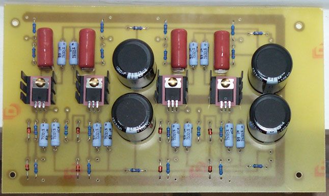

Just a little question about the Bosoz, Shall I substitute the irf610 with irf630?
yes ; little more capacitance to fight against , but nothing to worry
maybe just a bit darker sound

Just two need to be matched - the ones that make up the differential pair. Fairly close matching wouldn't hurt on the cascodes, but is not necessary.
And although the boards allow for heat sinks on the differential they are not needed. Cascode limits the voltage across the differential to ~6V (10V reference - Vgs of the cascodes). It would probably be a good thing to replace the cascode voltage references with 20V zeners.
I understand, it's the input transistor (if I'm not wrong) so no matching with its second board counterpart.
So Q2 and Q3 are the cascode and Q4-Q5 the output fets?
Q4-5 are the differential pair that need to be matched within each channel, do not need to be matched to the other channel. Yes, Q2-3 are the cascodes. Qx is the CCS.
So Qx delivers Constant Current to the differential pairs Q4-Q5 (amplify voltage difference, not actual voltage) and Cascodes Q2-Q3
