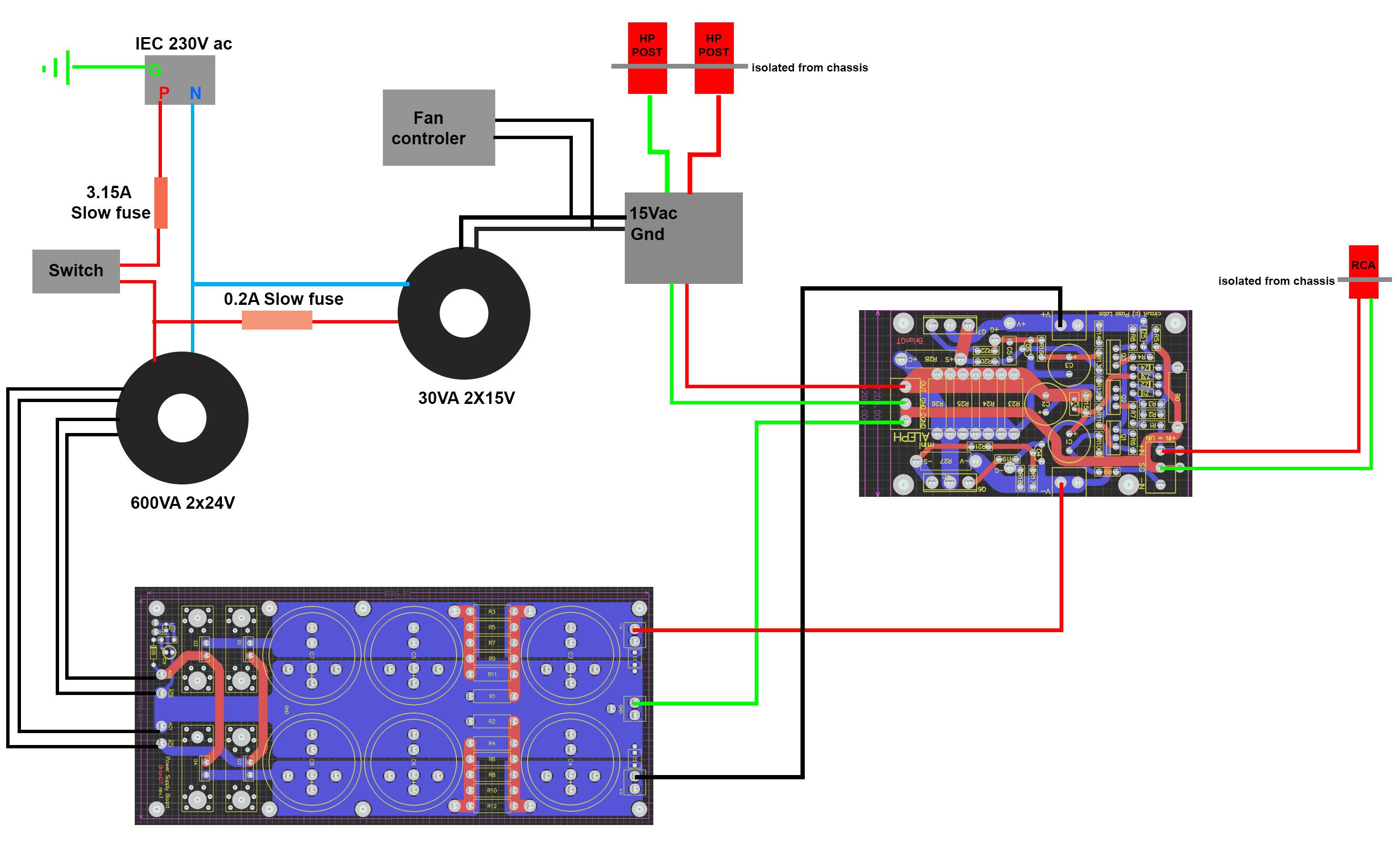

Also please take some photos of how it's currently wired, perhaps with all our eyes we can see something you may have missed.

I'll go take some photos, but I have to dismount the sinks from the bottom plate as it's quite crumpled in here 😉
output connections on psu
input connection on amp board (notice gnd green wire connected to Cgnd)
Main/power switch/trafos connections (blue is Neutral, brown Phase)
Speaker protection board and fan controller wiring (from 30VA trafo)
Main wiring (fuse linked to "P" of the iec inlet), notice the blue wire witch links IEC gnd to chassis
Overall pictures of the transformers
Overall picture of the amp in it's current state.
I know that wire are a little messy, but it's only a test rig, I'll attached and organize wires when all works

Ok, I've made new testings, and I discovered that the green wire witch goes from psu gnd to main amp board Cgnd was shorting the fets to ground, If i remove the green wire from the psu, the amp powers up, fan rotating and relays clicking, the psu outputs 32V dc;

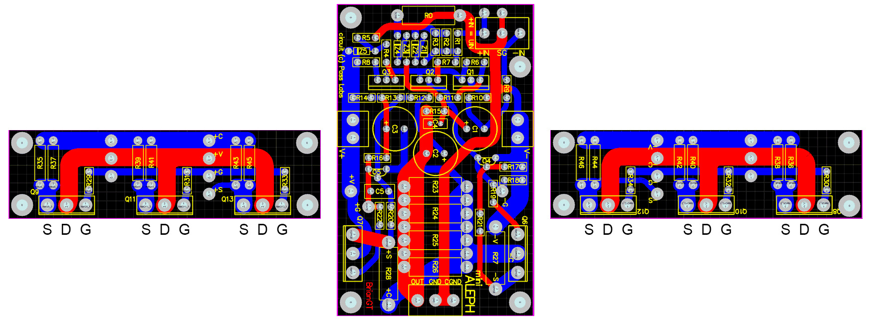

TEST2: Continuity

On Amp board V+ and V- inputs (not connected to psu)
V+ to +V (on header board) = continuity
V+ to Fets (irfp240) "D" = continuity
V+ to OUT = no continuity
V+ to Gnd = no continuity
V+ to Cgnd = no continuity
V- to -V (on header board) = continuity
V- to -S (on header board) = continuity
V- to Header board res = continuity
V- to Fet (irfp240) "S" = continuity
V- to Q1 (irf9610) "D" = continuity
V- to OUT = no continuity
V- to Gnd = no continuity
V- to Cgnd = no continuity

please - clarify "V- to Q1 (irf9610) "D" = continuity"

There's continuity between V- amp input and Q1 drain (Q1 is one of the three irf9610 fets on the board)
Here's a reference picture of the amp board, It will be easier to know what i'm testing.
aha
found schematic from start of the thread
D of Q1 is on neg rail
