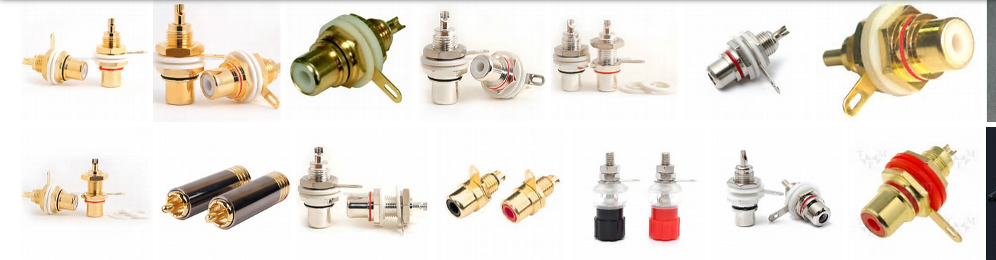

NO !For RF protection, coaxial cable outer conductor must be connected to chassis.
Not on one point with a capacitor (which is not a capacitor at RF) but over the entire connector periphery.
as explained in post47
the coaxial cable is being used as a signal connection on both the core and the outer. Neither of these signal conductors gets tied into the enclosure.the example that you have posted is for a two wire connection using the core for one half and the outer as the other half.
This coaxial cable connection is not a screen around a pair fo signal wires.
The coax outer is the signal wire.
Many forget that a coax is a two wire connection and as a result forget that the outer is a signal wire.
The two wire signal connection must not be broken: it is required to make two connections to the source and to make two connections to the receiver.

Coaxial cable is used to connect signal on the core and signal reference on the outer which is ground.
In order not to have RF coming from the outer conductor going inside the amp, you must strongly connect the outer conductor to outside chassis.
If you don't want to have signal return connected to chassis, you have to use three conductors cable and three pins connector with the outer conductor connected to chassis.

Can you see that a coaxial cable used for a signal connection uses the outer and the core as signal conductors?The use of uppercase and exclamation points usually shows an argument defect.
The outer is not an exclusive screen/shield. It is a signal conductor.
