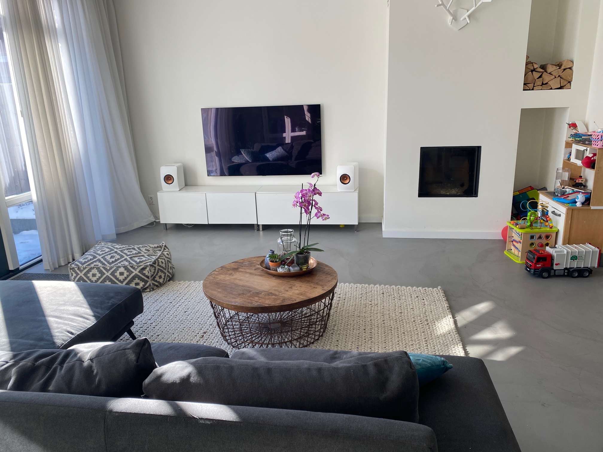

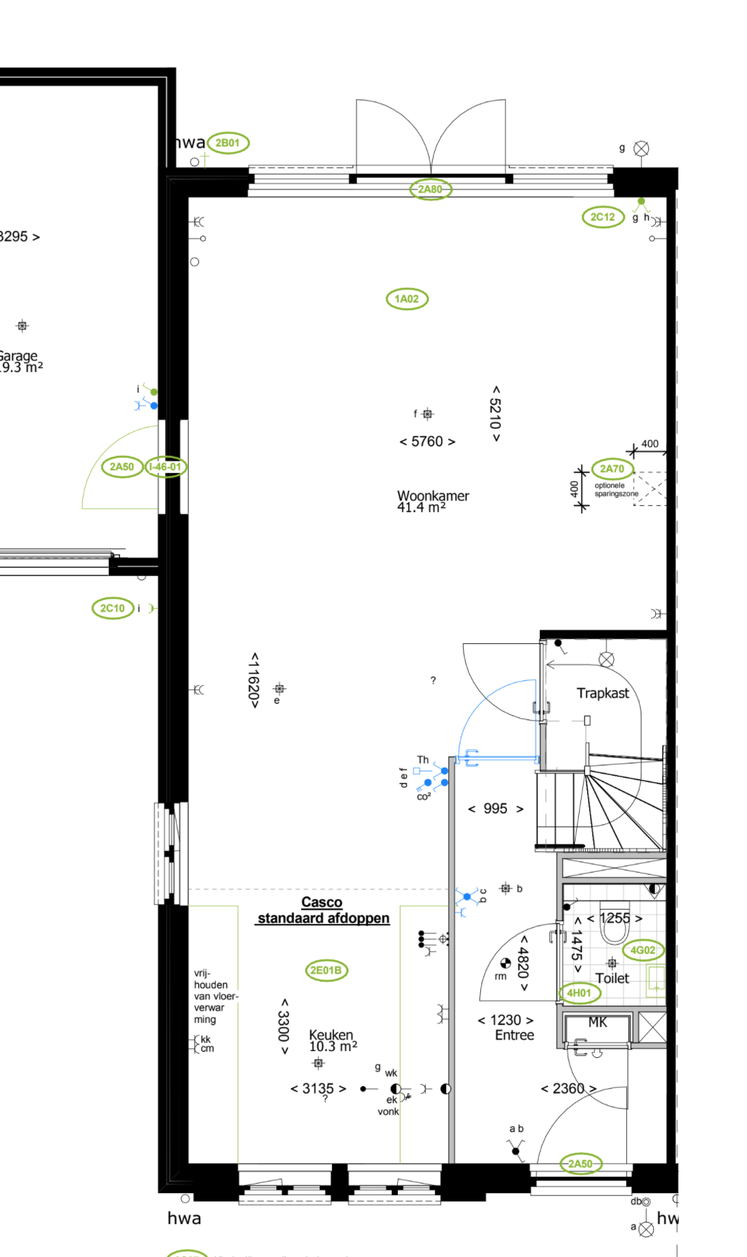

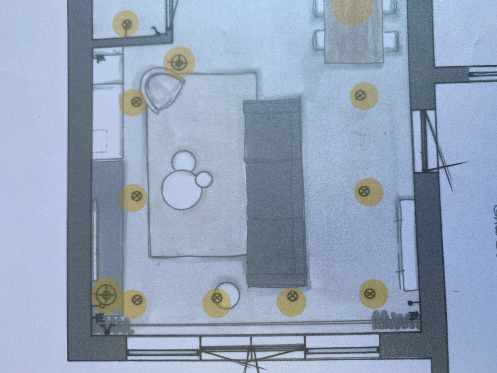

The livingroom (with open kitchen) is L-shaped. On the first attatchemt you can see the floorplan (all the measurments are in MM). The wall to the garden is mainly of glass, great for light (and horrible for sound). We have a very thin curtain, just for a little bit of privacy.

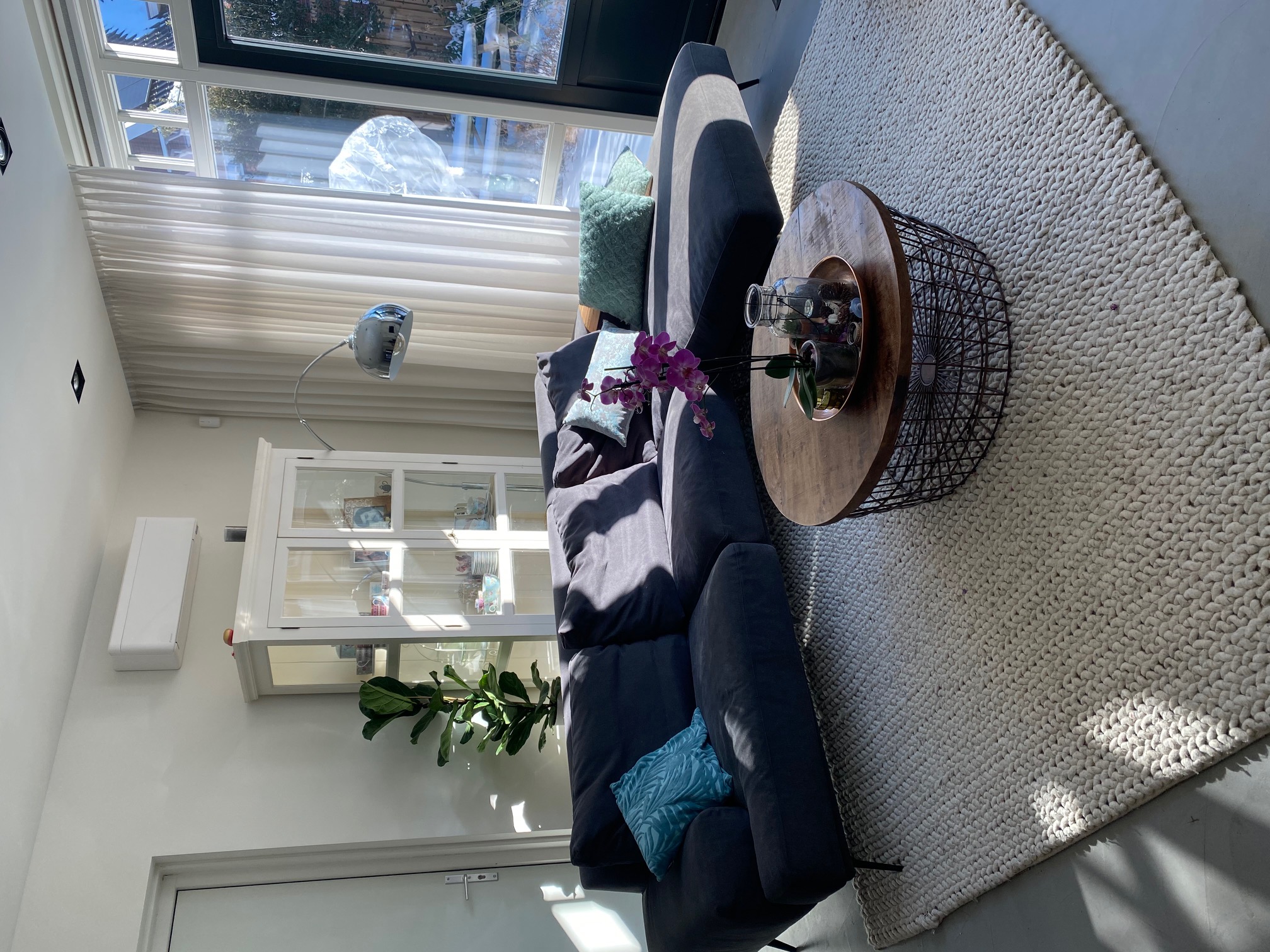

On the photos, you can see that in the corner (close to the stairs) we have a fireplace. The area that is for the TV/speakers and cabinet are around 300/320 CM. The current white cabinet is 240cm. The speakers are like 230cm apart. I have tried stands before, but it didn't impact the sound a lot. This is also safer for our two years old boy.
My right LS50 is damaged since a month, but that is not the only issue I have. I will repair this one and reuse it (on my desk in my home office).
I'm sitting like 300/350cm away from the speakers. I have included a photo of the back wall.

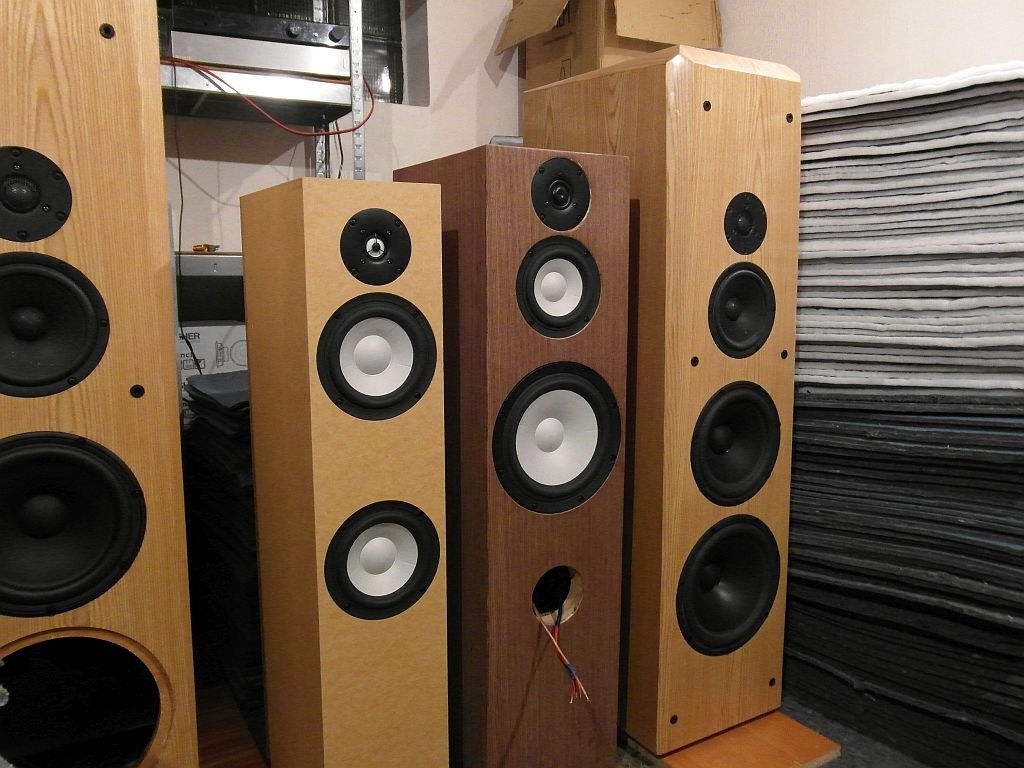

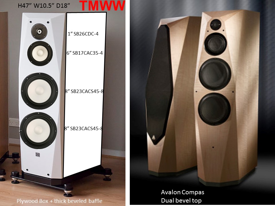

SB_Acoustics has a medium cost line of speakers with white aluminum cones which could help maintain the white HT style in your home. Imagine white speaker cabinets similar to the attached white Avalon design, and white cone speakers. You can construct cabinets just slightly deeper than your fireplace, and include bottom wheels to move them further into the room for greater 3D-soundstage effects for critical listening. There are a few passive crossovers for these drivers, but you will need to adjust them to your room. Bi-Amping with a woofer equalizer simplifies the crossover work.
To reduce edge diffraction distortion I favor large 1.5" - 3" radius quarter rounds machined into the cabinet edges .... not a good match to your main HT cabinets. One could construct modest 0.25"-0.5" edge rounds next to the woofers up to the midrange, and large 1.5" - 3" radius bevels above. ... the Avalon edge bevels are a closer style match to your main cabinet.
8in SB23CACS45-8
6in SB17CAC35-4
1in SB26CDC-4

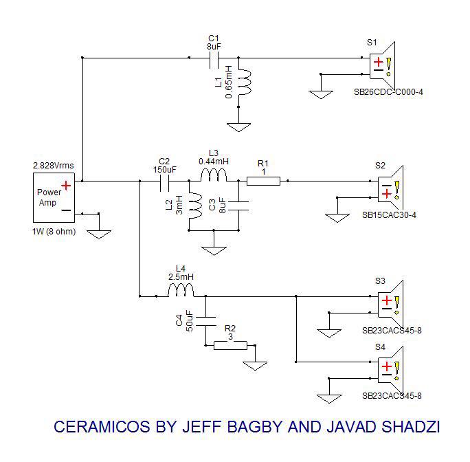

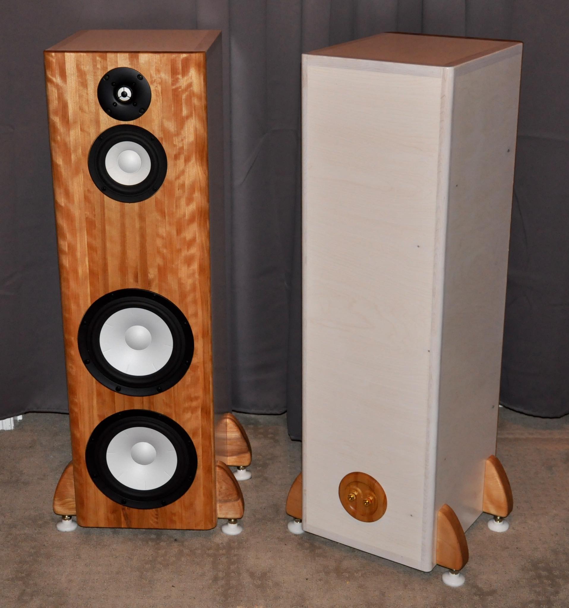

Ceramicos by Jeff Bagby and Javad Shadzi
3-way using SB_Acoustics drivers.
Enclosure volume is 2 cubic feet sealed, medium stuffing around woofers, mid enclosure is heavily stuffed. Center of tweeter is 3" from top of baffle, center of mid is 8" from the top of the baffle, woofers are located below doesn't matter, baffle width is 12". Enclosure ID recommended would be 36" tall x 10.5 wide x 9.5" deep. Google should find additional info.

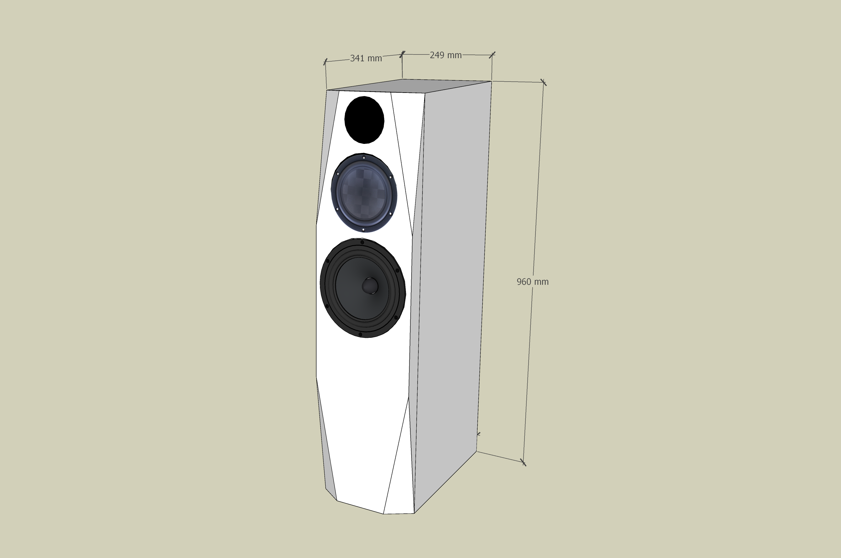

The plans posted by LineSource look really amazing. An Avalon/Vimberg Mino clone will look great in our room. I'm just playing around now with modelling a speaker that usees the Bliemsa T34B, Satori MW16 textreme and Dayton RS225. The first two drivers have great reviews. The dayton looks really good when we take cost into account and it should work in a small cabinet of 35-37 liter..
To make the design of the croosover easier, I'm also ready more about the Hypex FA range. This will make adjusting the crossover point and slope much easier.
Again, I wil first learn the room and the mesurments.. and then look further into the design... But I cannot resist playing around in winISD and SketchUp. ;-)
