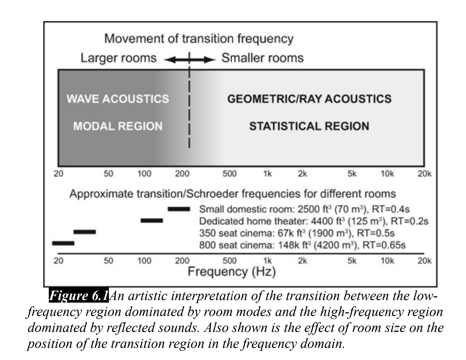

Moving the Kefs to a desk is a little odd. That sounds to me like he thinks they're bad at low frequencies so he demoted them to a desktop system. He's definitely dealing with a modal problem caused by using a single 13" subwoofer. He might also be suffering a boundary problem with the Kefs. If he addresses those issues he'd be much better informed on how to approach DIYing main channels.

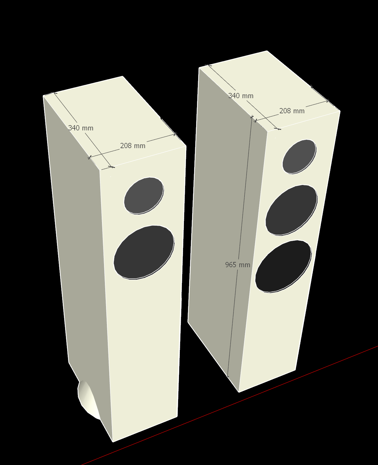

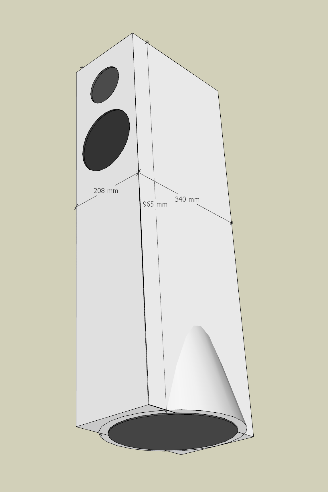

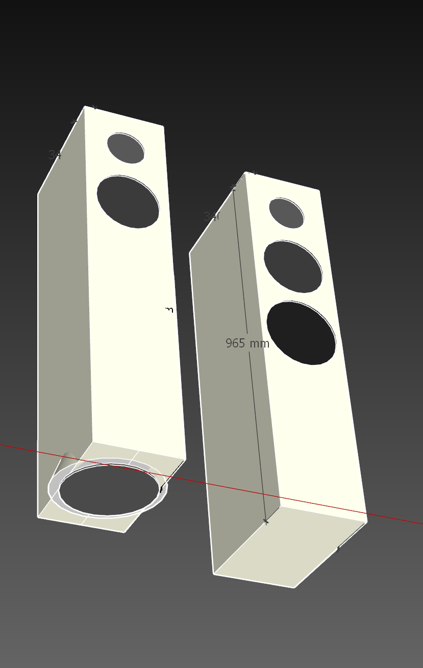

The plans posted by LineSource look really amazing. An Avalon/Vimberg Mino clone will look great in our room. I'm just playing around now with modelling a speaker that usees the Bliemsa T34B, Satori MW16 textreme and Dayton RS225. The first two drivers have great reviews. The dayton looks really good when we take cost into account and it should work in a small cabinet of 35-37 liter..
To make the design of the croosover easier, I'm also ready more about the Hypex FA range. This will make adjusting the crossover point and slope much easier.
Again, I wil first learn the room and the mesurments.. and then look further into the design... But I cannot resist playing around in winISD and SketchUp. ;-)
