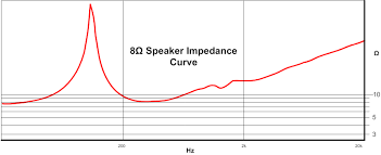

However, it is the impedance at the mid/bass frequencies which is important because that is where the majority of the music power resides - and that basically equals the impedance of the woofer i.e. 10 ohm.
It is too easy to overthink this. If you consider that the impedance of a loudspeaker varies widely with frequency you will realise that a few ohm here or here make no difference.
All that is necessary is that the impedance remains above 4 ohm over the majority of the frequency range in order to avoid damage to your amplifier.

Thanks for that image of the 8ohm speaker impedance curve. So, basically the impedance ratings you see with speakers are the minimum impedance they offer across the normal frequency range?

Regarding the speaker impedance curve:
Impedance (Z) is the total opposition of a loudspeaker to the flow of alternating current. Impedance combines the effects of resistance, capacitive reactance and inductive reactance. As you saw in the graph I supplied, impedance varies with frequency.
If you measure the resistance (R) of your speaker's voice coil with an ohmmeter, you will find that it is about 75% of the rated (nominal) impedance (Z) of the driver. An 8 ohm driver, for instance will usually have a resistance of about 6 ohms. This tells you that impedance is something more than simple resistance.

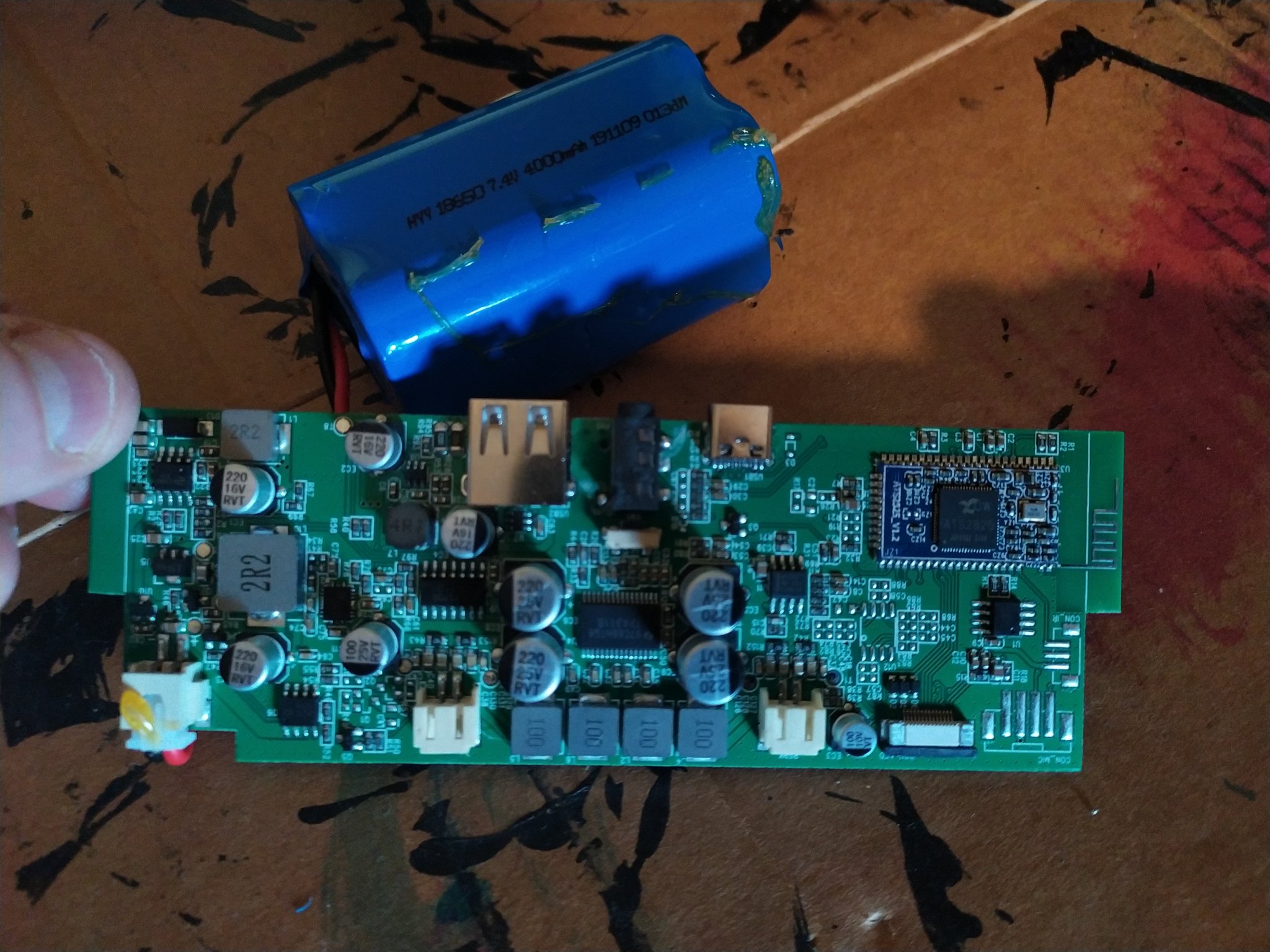

So it looks like I'm going to add the two 3.5mm jack sockets (jack 1 and 2 in diagram 2) and have it so either the external speakers or internal speakers are in use at any one time, never both, but always one or the other. I have a couple of 3.5mm jack TRS sockets with 5 pins which will allow switching automatically between the internal speakers and any connected external ones simply by plugging in a 3.5mm jack into each socket.
I'm concerned about interference from these speaker output jack sockets. The most convenient place to put the jack sockets are epoxed right onto the amp board and then drill a couple of small round holes in the casing for them (it's not a sealed section of the box). At this location they will be 1cm (10mm) from the line level aux input, and right up against the amplifier board.
Could the signal carried through those output sockets create sufficient electromagnetic interference to possibly interfere with the signal on the amplifier board, or the signal coming in through the aux inputs 1cm away?
Any magnetic field associated with the current flowing in the speaker output sockets will be much too weak to affect the signals present on the amp board or coming in at the aux inputs.
Perhaps you are thinking about radio frequency (RF) interference, which would not be radiated by your speaker sockets.
No, I was indeed thinking of electro-magnetic interference. I have read in some forums that crosstalk between speaker wires can be a potential issue above certain power levels (eg..'hundreds of watts') if the wires are right next to each other. THe power out of these outputs would be much lower (25 watts peak), but given the much greater sensitivity at an aux input or the pre-amplified signal on the board after the bluetooth signal is received, I wondered if that signal being so close to the board and line level input could be an issue.
On this photo, it would be the other side of the board, from where the USB socket is.

Regarding your mention of "crosstalk", I believe this would only be an issue with long lengths of speaker cabling when carrying large currents.
You may be surprised to learn that your average listening level is likely to be at around only a couple of watts!

I'll just add that there will be no long lengths of speaker wiring inside your boombox so what you're reading about potential cross talk is not applicable.
There will basically be just the speaker output sockets themselves, and there will be little chance of electromagnetic coupling between them and the rest of the circuitry within the boombox.
I believe I said earlier that you were overthinking things for this simple project. 🙂
