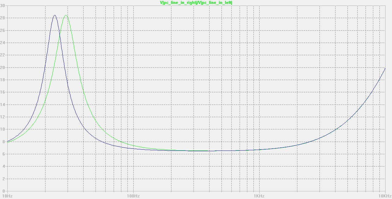

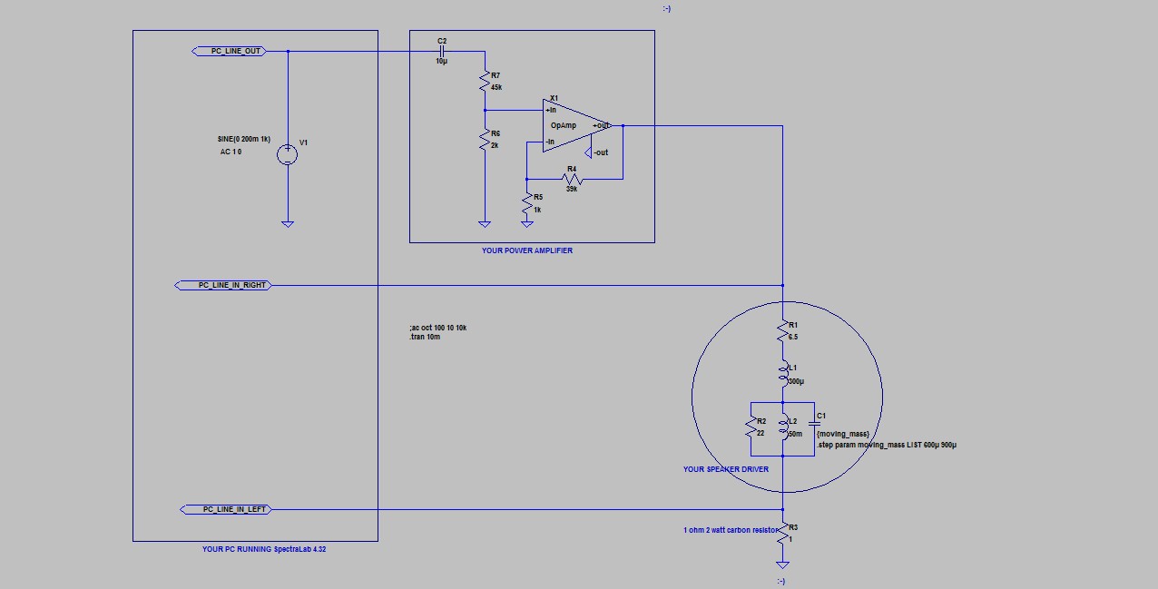

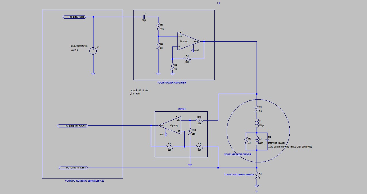

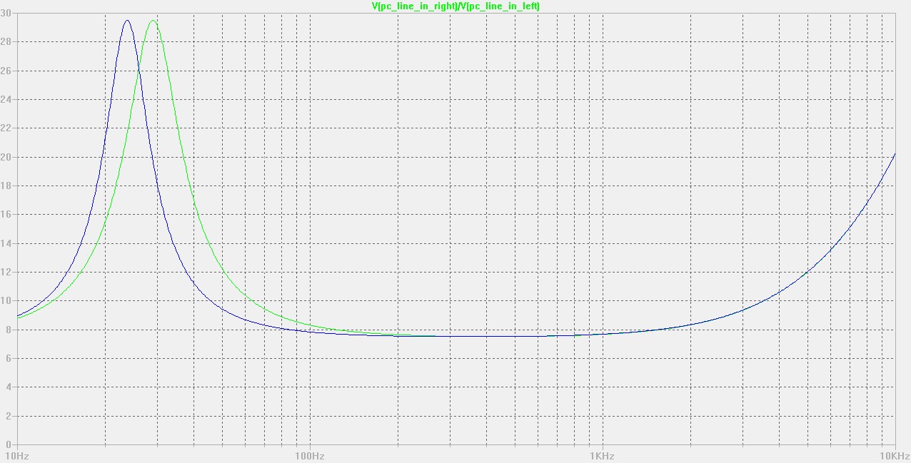

Now using a simple difference amp for getting rid of the 1 ohm error. The 25K resistors must be within 1%. Such resistors are about 1000x bigger than the impedance they connect. Their loading effect can be neglected.
True differential amp are thus not required.
A chip like the INA134 is inexpensive, this is a dedicated simple difference amplifier, and it has the high-precision 25K resitors built-in.
For the two INA134, I'm using a symetric power supply made of two 9V batteries. Not represented on the schematic.
Using a second simple difference amp for measuring the voltage drop on the 1 ohm resistor has a great advantage. This way there is no ground loop forming with the signal ground (the ground coming out the PC) and the power ground (the negative speaker out terminal coming out of the power amplifier).
Z measurement (SpectraLab 4.32 screen) (linear Y scaling).jpg208.1 KB · Views: 34

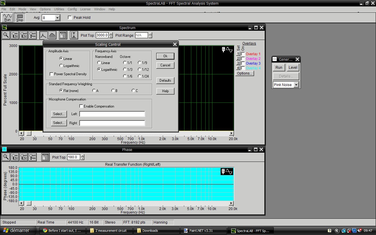

First I would like to thank you Steph for all your efforts for trying to educate me, and doing all the examples.
Regarding SpectraLab, I've downloaded it with the help of your links. However, the company seems to be quite dead. I have not heard anything in weeks in response to my inquiry. Unfortunately for me, I've a huge problem with using software with uncertain licence issues, and there is no sign that the SpectraLab is abandonware.
I've therefore tried to search for usable software for my platform of choice, and found "baudline" baudline signal analyzer - FFT spectrogram
It seems to be able to do many things, but if it can perform the dual-channel measurements I'm still trying to figure out, and I'm still waiting for answers to my questions on this subject posted at their message board.
If anyone with greater knowledge than me could take a look and see if it can perform the dual-channel measurement needed? I believe it does, but I would like to be 120% surtain before I start out trying to learn a new software. I just hope it will support my sound card.
It's free, and awailable for at least Linux, Solaris and Mac OS X. Sorry, no Windows in any near future as I understand it.
