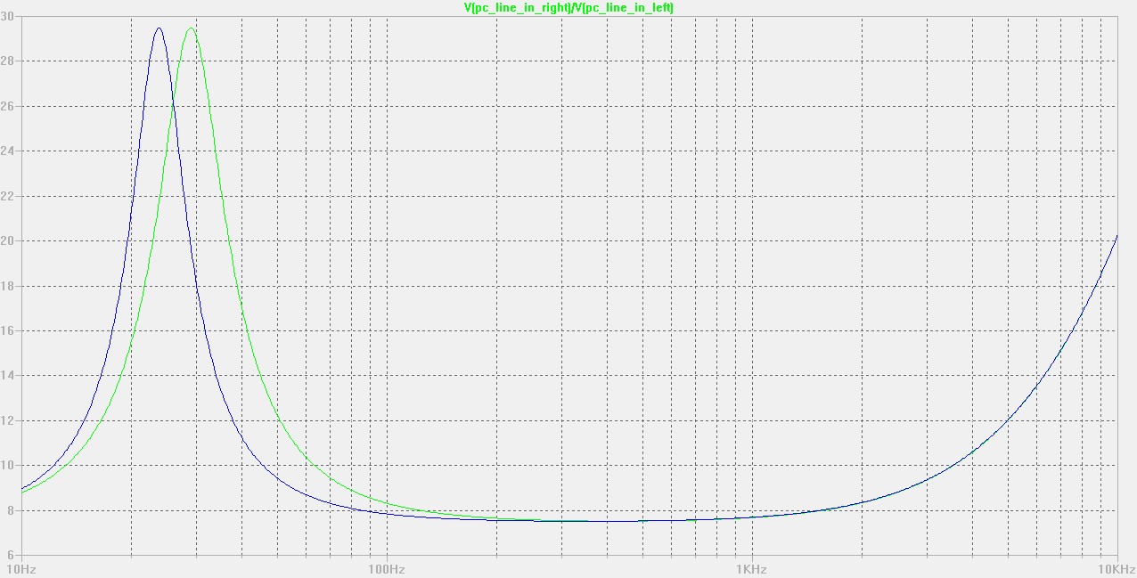

The new thread about trying to simulate a bass-reflex boss using LTspiceIV is here :
http://www.diyaudio.com/forums/mult...d-box-loudspeaker-spice-model-aes-1991-a.html

hi Buggsson,
here is the SpectraLab4.32 setup for measuring the T/S parameters using the additional mass method. Note the vertical scaling, linear 0 to 3000% which means 30 ohm if you are using a 1 ohm reference resistor. Main menu ... options ... scaling ... linear. The displayed curve is always 1 ohm more than the actual Z magnitude of the speaker. You may take it out manually in the calculations, or use a more complicated circuit using a difference amplifier (sensing the voltage difference on the speaker driver terminals) feeding the PC_LINE_IN_RIGHT input.
