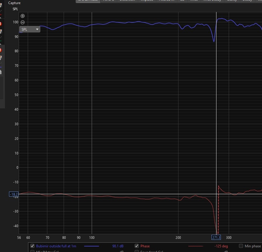

What is really puzzling me is full phase shift at 270Hz which is purely woofer related. Always the same thing I got; any XO or woofer alone. Always sharp phase reversal within very narrow 10 Hz range (approx from 256 to 275Hz). It results in sharp dip (like 10db) as in picture, or in uncontrolled peak with different measurements, but phase shift is always there and rapid.
If anyone is understanding this, and kind to explain, I appreciate 🙂
Resonance in a box?
https://vikash.info/audio/standing_wave_calc
There are probably better calculators out there.

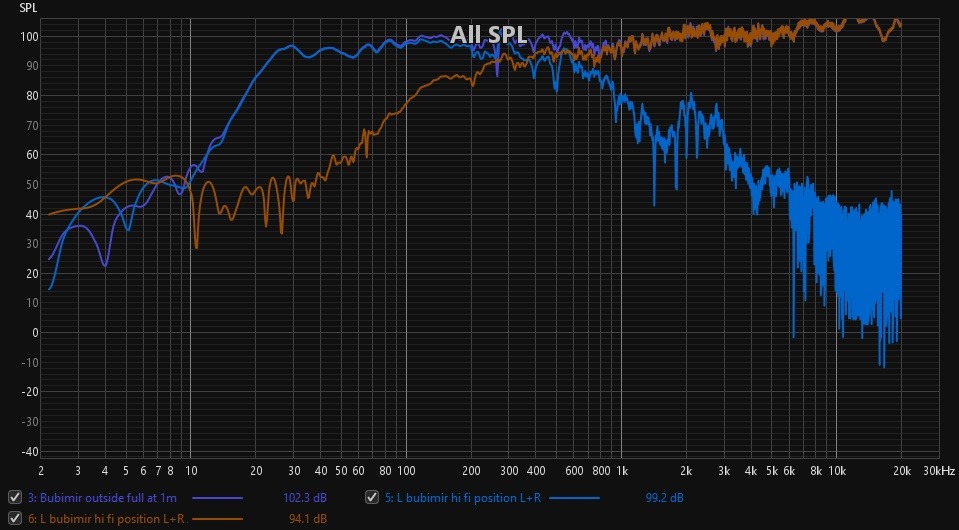

Hi, didn't make any without Xo at all. These are single drivers with 1st order at 410 Hz, through DCX2496 DSP plus sum response of both:Would really like to see any measurements without crossovers just attenuation/balance, as a baseline response (off-axis as LPF; baffle loss as HPF).
Thanks, this chart is helpful to me. It clarifies the "magic". Of course my starting point was actually "LX" minimally pass-filtered or not at all (in special cases shown in the gallery). I can imagine many widerange ~10" drivers with a single aircore, up-firing, yielding a curve not too different, just shifted. (Actually I've done a few vintage "fullrange" and modern drivers.) And a complementary front-facing fullrange, small-sealed or OB (capacitor if needed).

Dears, just to ask again; what do you think is cause of rapid phase reversal at 270 Hz and how to tackle this? Like in post # 61 above.
This is strictly woofer related, no XO influence.

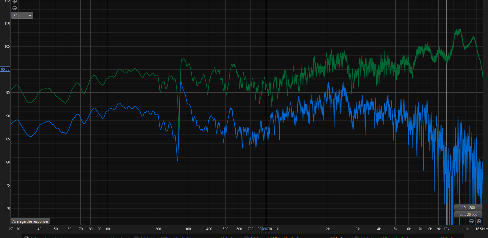

Another thing worth ironing (but much less of concern) is some peak followed by dip at about 2,5 kHz with the Eye. Other people measured that Visaton B80 driver and the same thing is present there (and speaker being in free air or different enclosure), completely independent from what I measured. Results are very similar (at least seems Visaton has good production spec consistency). Is it worth tackling this at all?
And the last, climbing response of widerange driver, below I plotted on axis and approx 30 deg off axis sweeps. I believe it is not good idea to do anything with that as I will never be exactly on axis to listen. Only idea that I like is might be to introduce one more B80 but firing upwards. Makes any sense?
Here are plots , on axis and 30° off (blue), they show all 3 issues:
