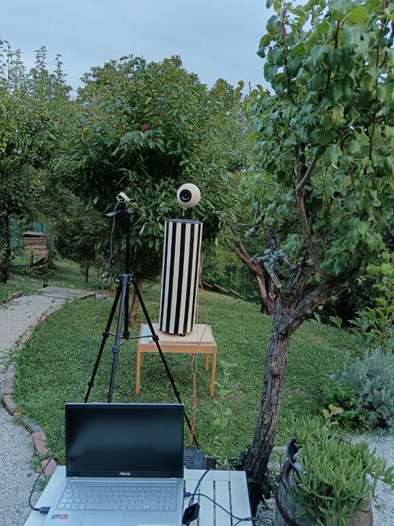

Small update, Finally I figured it will be necessary to take one speaker out in open space and continue, so far I was measuring room and the speaker, need to take one challenge at the time. Also I need to figure adjustable holder for the Eye so I can play with position of 2 drivers. When rain stops and I'm done with that, I'll report.

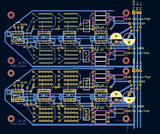

In the meantime I could not find satisfying PBC layout for classic LR active crossover, so I made one. It is modular and as many as needed blocks can be copy pasted to achieve almost any XO configuration. Here is PCB picture, think its good but comments are welcome. If anyone wants it I will publish KiCad file and explanation for convenience.

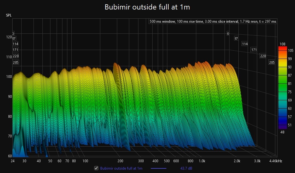

Finally I did what was supposed to be done at beginning of speakers measurement; took them out to the garden. Last night youngster neighbor who is very enthusiastic about audio helped me to carry one speaker and the rest out. Win Win, he helped me with lifting, I showed him some technology and explained, could be a beginning of beautiful friendship (Casablanca) . 6 pack of beers went into empty glass, we finished around midnight 🙂

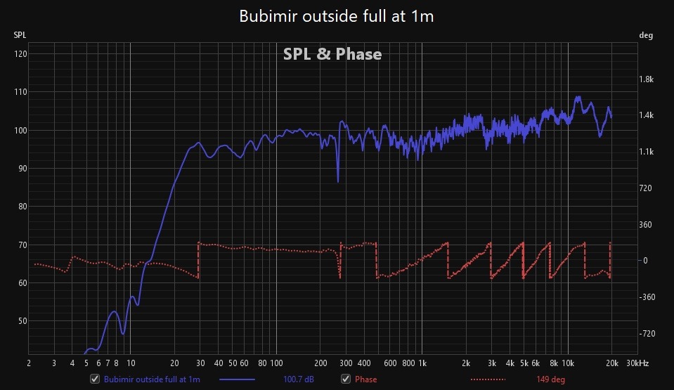

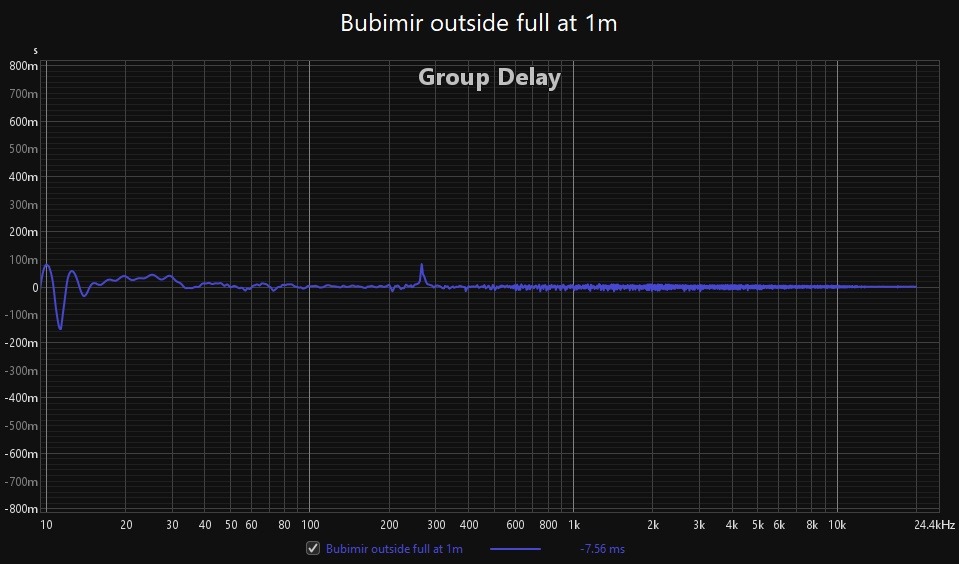

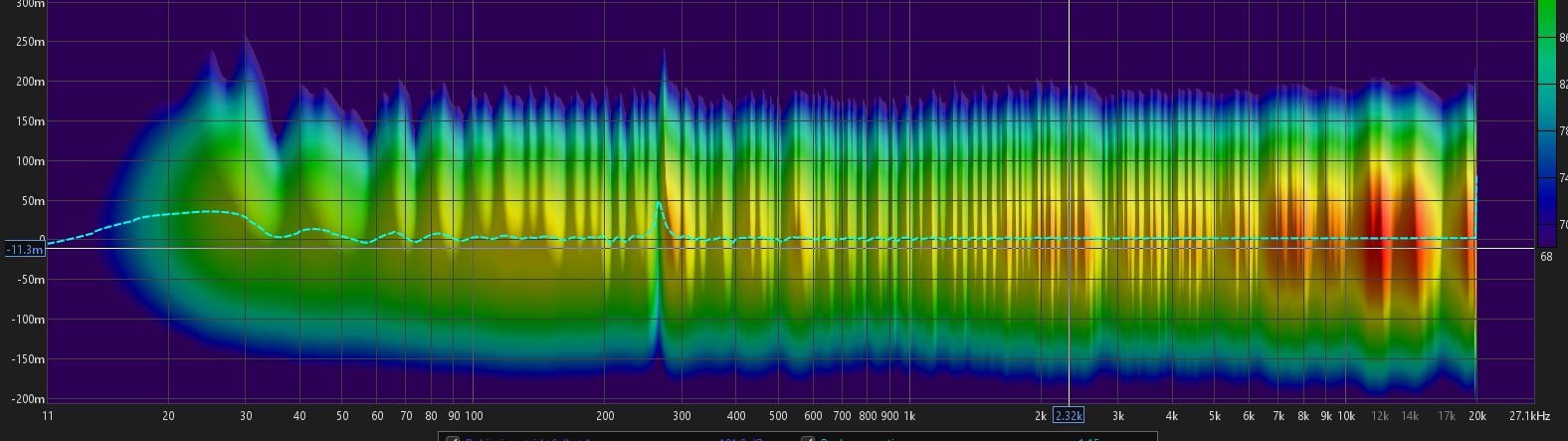

The measurements of speakers now make full sense, I was testing this in room in the winter and had horrible peaks and dips. Now finally here is speaker much better represented:
Comparing this (free space outdoor) with what I had before (posted earlier in this thread) in room measurements, 2 different worlds.
There is room for improvement but that is easy, X-O is active 1st order at 410Hz, i just need to elevate bass level a bit and apply very gentle filter to HF , if needed at all as this is on axis response, off axis B80 as 3,5 " driver drops dramatically, so just angling speaker a bit does it. We wil see later.
