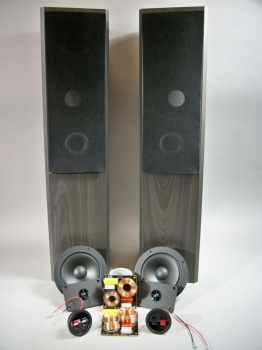

Very cheap $25+shipping. Generic x/o might need some work,
realign one of the inductors to be on its edge, possibly adjust
the tweeter level. Sand fill the bottom third or open it up.
