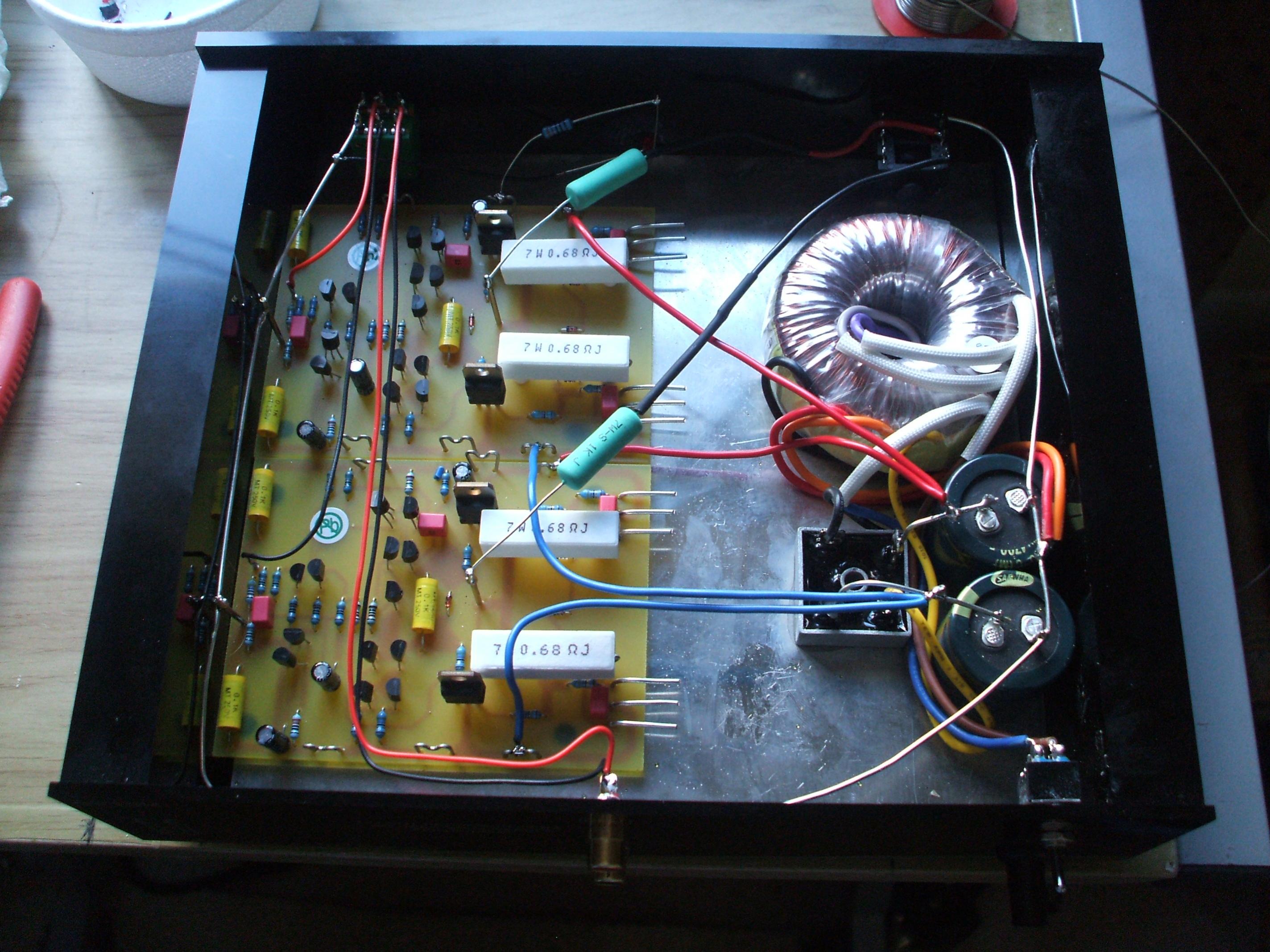

don't know what kind of glue this might be but i can guarantee that is extremely hard to remove form transistors. As about the heat transfer abilities of the specific chemical i also don't have any idea
The glue on the output transistors is hard, hopefully a thermally conductive cement used for adding heatsinks to computer ICs. I wouldn't even try to get it off the transistors, just replace them.
The transformers, rectifiers, PSU caps and standoffs are fixed with a contact adhesive, that is strong enough to enable the whole amp to be lifted holding just the transformer( best not do this.) I like this idea, save having PCBs wheer point to point is easy and is easier than drilling metal.
The top panel is fixed with a rubber based glue that is fine for normal use but weak enough to pry open if necessary, a bit of heat might help.

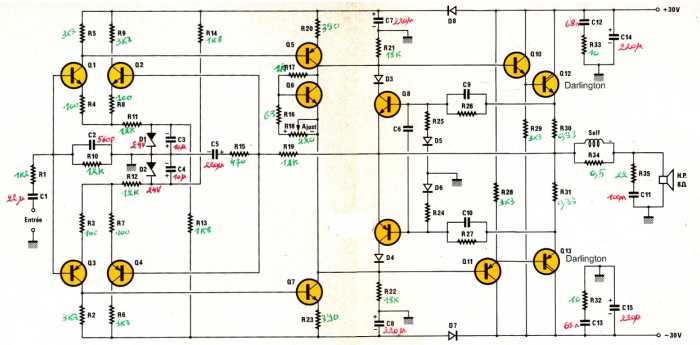

Hello east electronics,
Here is the schematic of one amplifier 2x25W...the power stage use BDV65B & BDV64B...and as you tell a Vbe multiplier for thermal stability.
It's a very good amplfier ! I use it since 30 years without problem !
Best regards
Best regards
The amps have changed along with the cases, and the layout and wiring is neater now I believe. Tying the wires up with cable-ties is a no-no and the thermal cement for the output stage is designed specifically for the job and bloomin' expensive! The transistors aren't the same now either it seems.. Casework is now Perspex and heat-sinks are 5mm..
Here's a current AP10P
this one is a Vintage NVA40, quite a different case and heatsink...
worth checking?
worth checking?
That NVA40 also has quite different wiring and layout to both early and 2014 versions of AP10P. Whatever you think of NVA design philosophy and assembly methods, this isn't the way to lay out a power supply for low noise.
Thanks Ian... I’m more concerned in personal safety and loudspeaker protection... this one doesn’t have any CE label.
I think NVA have only in recent years complied with product safety regulations and marked products accordingly. They don't even sell through retailers, as I understand from other posts here.
I'd assume its not the original wiring inside either. A lot of people now tinker with audio products and not all of them have any idea or respect for electrical safety, especially when converting products from foreign countries. If your mains power is floating (schuko plug type) your chassis may be unsafe without a ground wire and suitably grounded power socket. The NVA amps would not be approved for double insulated (2 wire) power so you would have good reasons for concern in most cases.
I'm not qualified to advise you on mains wiring but I would definitely seek out a local service technician who is familiar with the requirements for appliances like power amplifiers.
Loudspeaker protection is included in the form of current limiting and it is tuned to each model, by the look of the circuit. Naim and a few other UK manufacturers avoid relays this way and it does have advantages over relays which are forever screwing up the sound.

as you say below it is a 30VA thing. Very small even if it looks of good quality (i guess from RS catalogue). Yes my idea was to increase to 100VA not much more
It is a low power amp and designed accordingly. It does not get very warm. Probably a class AB design. I like the sound very musical
To conclude if i put the transformer bridge and big caps in a separate case it can work ? the concept seems the one of the Mission Cyrus Two PSX external supply below depictedPutting this new supply in a box made of actual steel - 3/16ths if you can get it - will pay dividends. Aluminium does nothing for magnetic fields, even if carved from a single billet. I wish amplifier manufacturers would remember this. And even toroids have a significant external field which is not necessarily equal in all directions either. It will pay to have your umbilical cord shielded too. Good luck

I see. Even if they carry DC voltage only ? i was so silly that i was thinking to screw a robust diodes bridge on the real panel so to keep AC wires to a minimum inside the chassis. The actual distance from the external transformer to the internal bridge could be limited to some 20 cm just to give a figure ... 😱
Re Bass: I often see claims here that the bass is much better, stronger etc with one amplifier compared to others, regardless of the amplifier power ratings, power bandwidths being similar or that the speakers may not even have a flat bass response much below 120 Hz anyway.
The frequency response of the amplifier is not likely to be the problem, nor will a bigger rectifier or more capacitance help if the transformer is deliberately small for low cost and inherent overload protection, as discussed. The rail voltages will sag regardless with anything more than light bass content in that condition.
You could test them with a 'scope if you have one - unfortunately, a digital voltmeter won't be very informative
If you fit a larger (higher current and perhaps voltage too) transformer to increase the bass capability, the question then, is what will now protect the amplifier from overloads and the speaker too, if the amplifier fails?
I see your points. This amp is designed and built for low power
But the output devices, if i am not wrong, are the same of the more powerful models ? they should be 150W parts ... very robust.
Regarding the bass, some low power class A amps sound more powerful than higher power rated class AB amps especially when the loads are tricky.
As i said above a more deep mod would take the guts out and put them in a new more conventional chassis ... for instance with a proper heatsink for output stages the only ones that should be under stress i guess
I am thinking seriously about this.
I still think that the good sound comes mainly from the circuitry and not from the unconventional chassis used. Maybe i am wrong.

from Internet ...
is not that enough ? i do not know what T the output darlingtons can reach ... but it should be well below those points. Am i wrong ?428 °F (220 °C) is the melting point of nylon 6 ... 509 °F (265 °C) is the melting point of nylon 66
