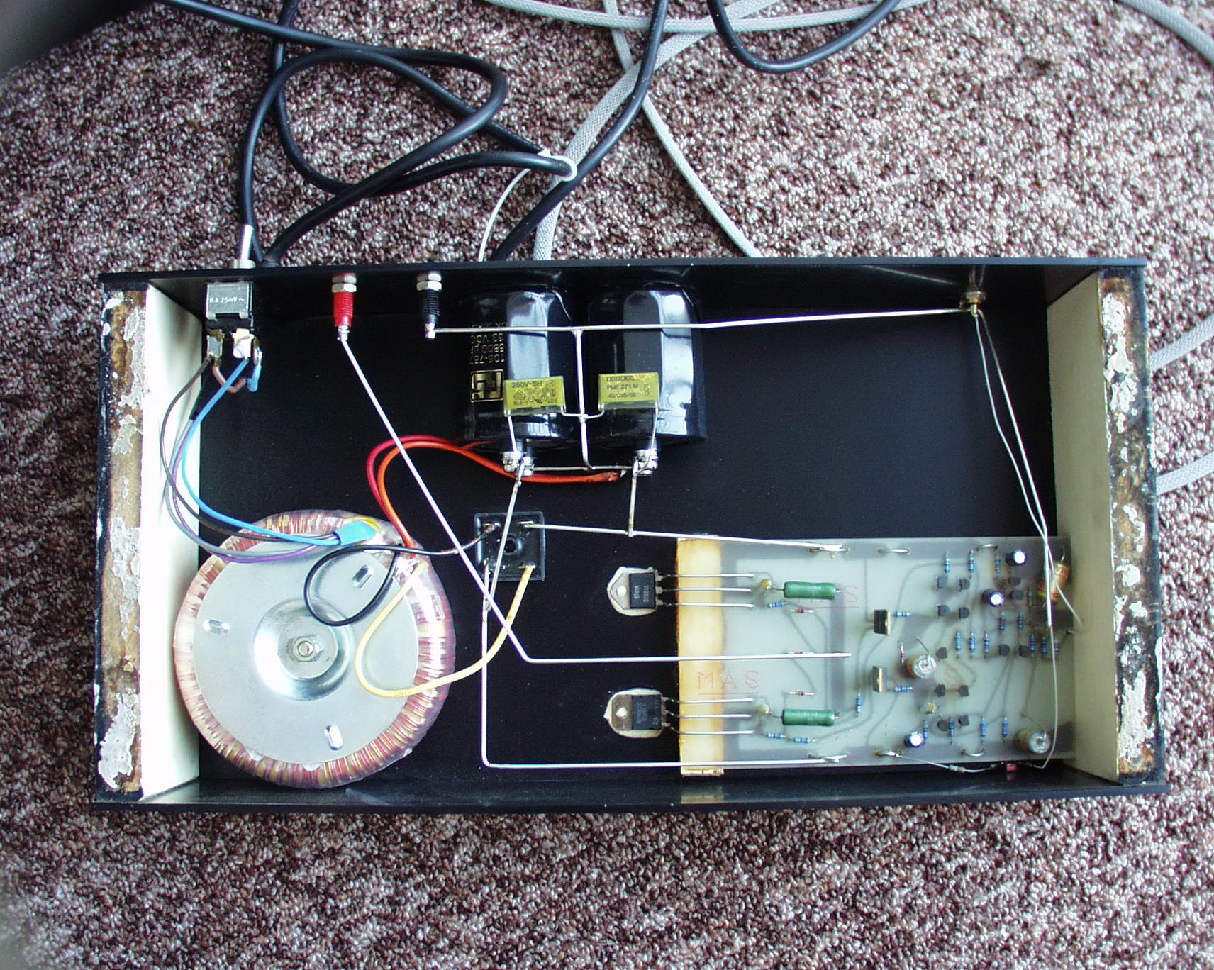

the heat sink is attached to the box with spacers to ensure some air flow instead of glue that was the previous fixing and the top cover was drilled in a CNC laser with 12 stripes 15 cm long each with a gap of 3mm to ensure ventilation ....
humble amplifier construction...

well not really the all box is made out of plastic , according to the manufacturer iron or steel or aluminum boxes effect sound for the worst together with the screws that hold the all thing together.
so his approach is plastic and glue .... about ground never existed inside the box from the first place

Sorry. The boards are glued back in position so I cannot easily make a drawing. Looking at the board you show, the only difference I'd not is that on mine the power rails are split and joined above board with wire links. Looking at photos of the bigger amps that i can find, this is so that the bigger amps can be powered with separate front and back end power supplies.
In order to get the best from an NVA amp you'll need to get the transformer away from the circuit boards, I found this messing about with the headphone version of the same amp. NVA's top of the range model has a transformer at each corner of the unit, well away from the eletronics. I had similiar a experience with transformer location with a kit amp that had a similar design. Also using an external transformer makes it a lot easier to have one or even two per channel.

let me explain this a bit ...
to have a more decent amplifier if we take as a fact that the design of the NVA at least for the input is perfect you need only a couple of things
1) to ensure the thermals either way one may be a proper vbe multiplier that will preserve thermal run away issues or simply run the in the maximum bias but with huge heatsinks ...Will take some hour to warm up but other than that stable ...
2) to remove the miller caps as very well known as sonic killers from the B-C of the output transistors After that serious oscillation is around the corner waiting for you that cannot be cured ( at least with the techniques i am familiar with )
To the above exists only one exception of a working amplifier that solved most of these issues the NP a40 ... biased at 800 ma per device given as a fact hat heatsink will manage that and while the darlington is too busy to handle the bias doesn't oscillate that easy even operating without miller caps on the B-C of the outputs ....
Other than the A40 i have never seen any amplifier based on these outputs that either performs or at least is safe enough ...
