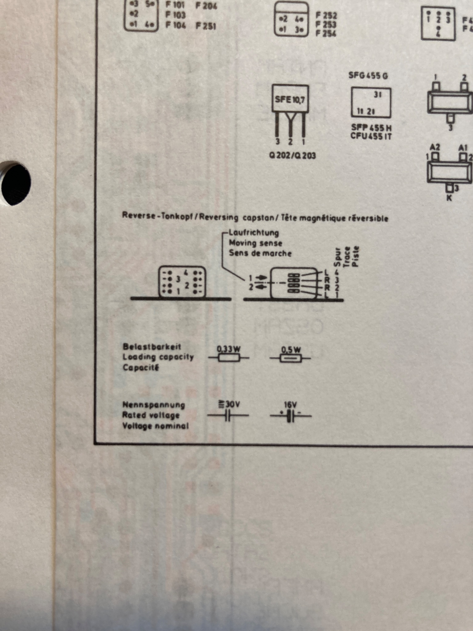

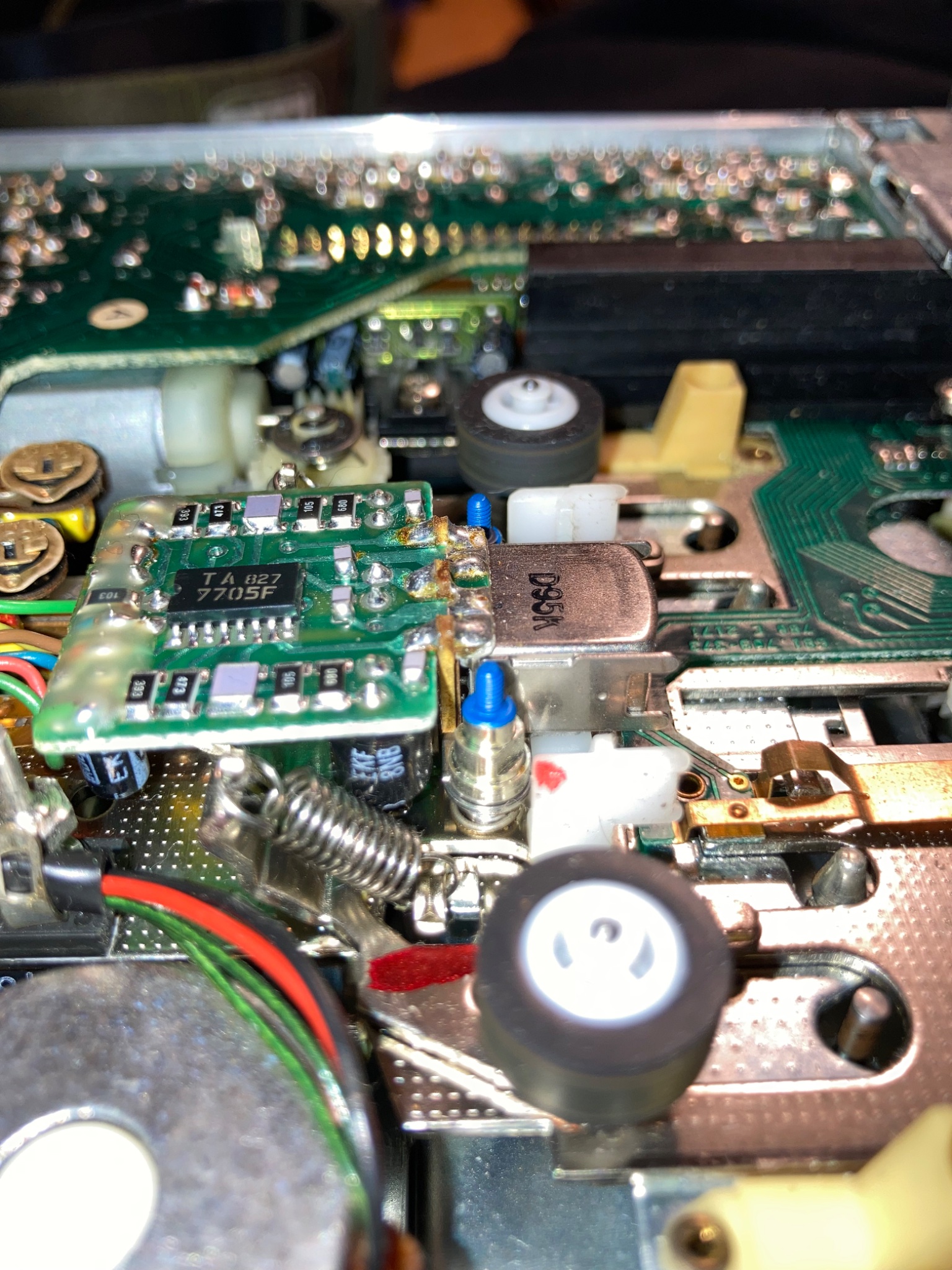

I measured resistance from head ground to
Channel 1: no reading*
Channel 2: 230 ohm
Channel 3: 230 ohm
Channel 4: 242 ohm
From the service manual (attached) channels 2 and 3 are right and channels 1 and 4 are left.
When playing a tape, this is the issue: playing side 2, there is audio in right side only; when playing side 1, there is audio in right side only, but playing in reverse. This is the signal from channel 2 in both scenarios (sides 1 and 2).
So that would mean channel 2 is working. And I’d assume channel 3 as well (same resistance). Not sure what’s up with channels 1 and 4.
So all in all, this seems to partly explain the issue (only right channel sound). But it doesn’t explain why it’s playing in reverse when set to side 1.
