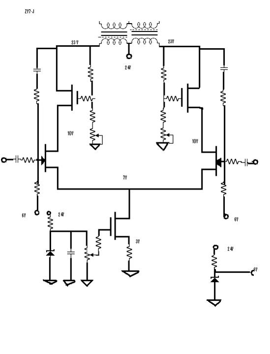

I have been working on ZV7-J
I will attach my block diagram. Let me know if this will work.
Perhaps we should start a new thread?

Since the Lovoltechs (still available) are depletion mode
devices, they will self bias with the input grounded. You
could consider replacing the current source with a resistor.
