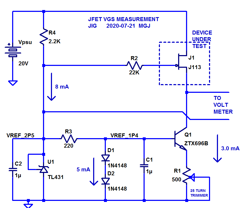

So your methodology is to sort devices for Idss.
Use devices for the CCS position with an Idss that is lower than your chosen cell current and trim with source resistance and then pick a device with a higher Idss for the cascode.
(Ref. Mark's suggestion at top of page)
Do I have that approximately right?
I thought so, when I published the circuit schematic and Gerbers for the "IPS6" input stage on the M2x power amp. It's at M2x post # 3,408 and the test method+jig is at # 3,377
Have to say, my favourite part of that post #3377 was:
However it may be true, that reasonable people might agree: it's reasonably likely, that others will probably get reasonably similar results.
You weren't a lawyer in a past life were you? 😆
Here is a link to the thread page: M2X
Here is Mark's measurement jig for anyone wanting to use it. Mark, I truly enjoy reading the results when you create something. Very nice solution.

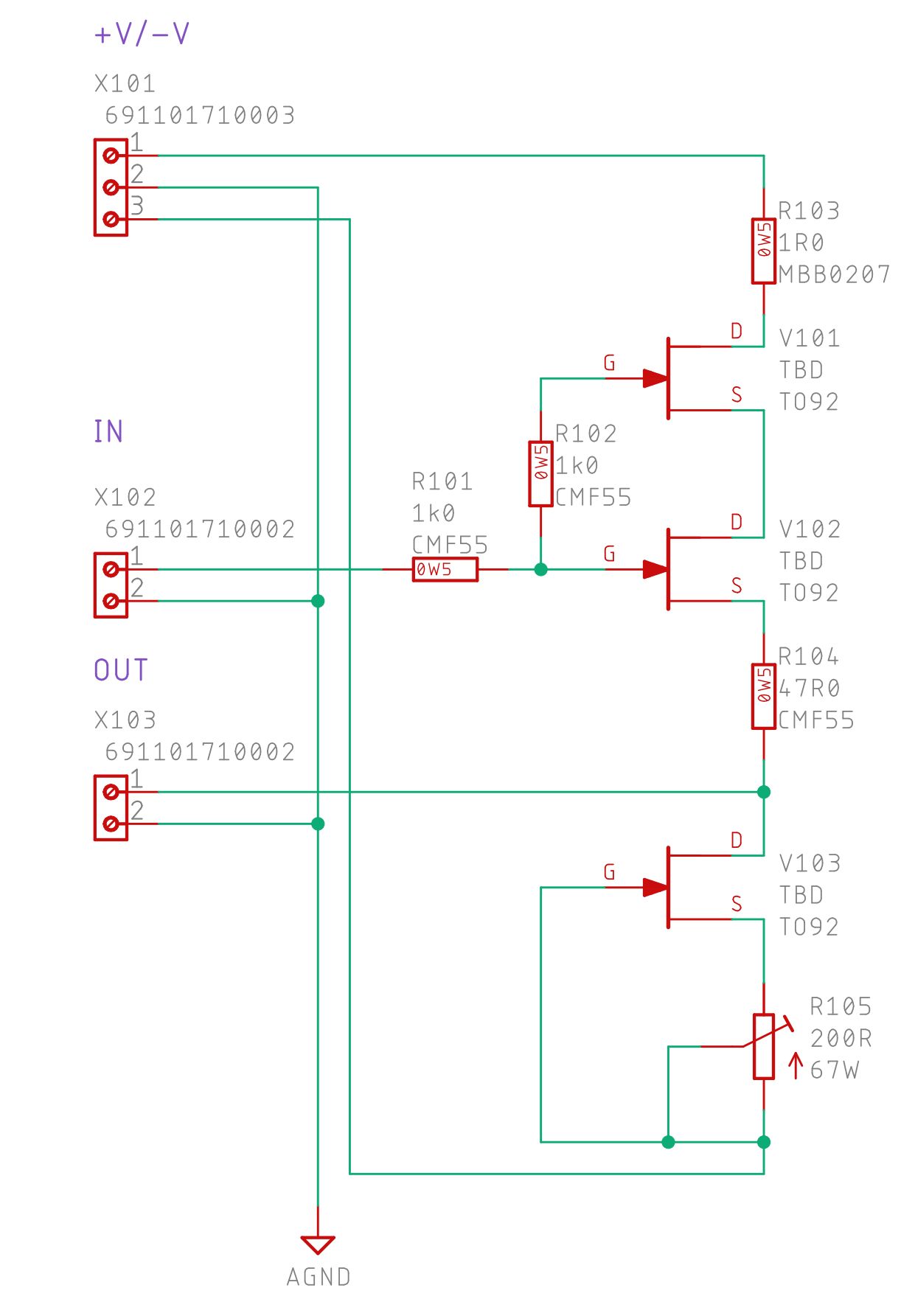

The compelling reason that I am going down the cascode B1 road is that I have some JFETs that I think will drive low impedance loads better than the run of the mill J111/J112/J113. If it turns out that the compelling reason does not exist, then the cascode is a waste of an additional JFET.
For my newest PCB version with a cascode, the PCB can be populated to ignore the cascode by shorting that JFET D-S pins and not populating the resistor for the cascode JFET gate.
Using a J113 in the cascode positon creates less than 1V across the gain JFET. That means that Id will be less then Idss.
Using a J111 in the cascode position creates between 5 and 6 volts across the gain JFET and Id is every bit all of Idss.
The tradeoff is that a J111 in the cascode position requires 5 to 6 more volts in the + power supply to make clipping symmetric.
The J113 in the cascode position allows symmetric power rails but does not squeeze out all of the current from the gain JFET.

The POT is next to a J113 acting as the current source. The JFET in the middle is the current gain device. The JFET farthest from the POT is a J111 servimg as a cascode.
The IDSS of the gain JFET is around 20mA. The source resistor of the gain JFET is 1 ohm.

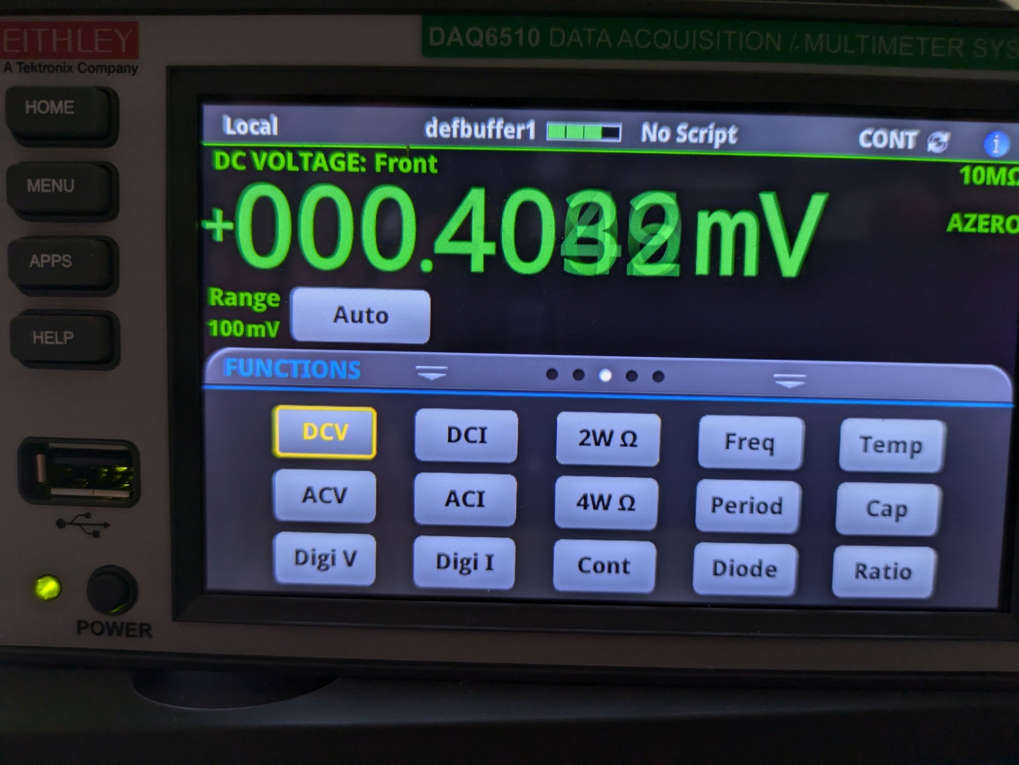

DC output offset is less than 1 mv.
The cascode voltage is around 5v. I added 5v to the + supply to attempt to have symmetric voltage clipping.
No capacitors in the signal chain. Fully DC coupled.

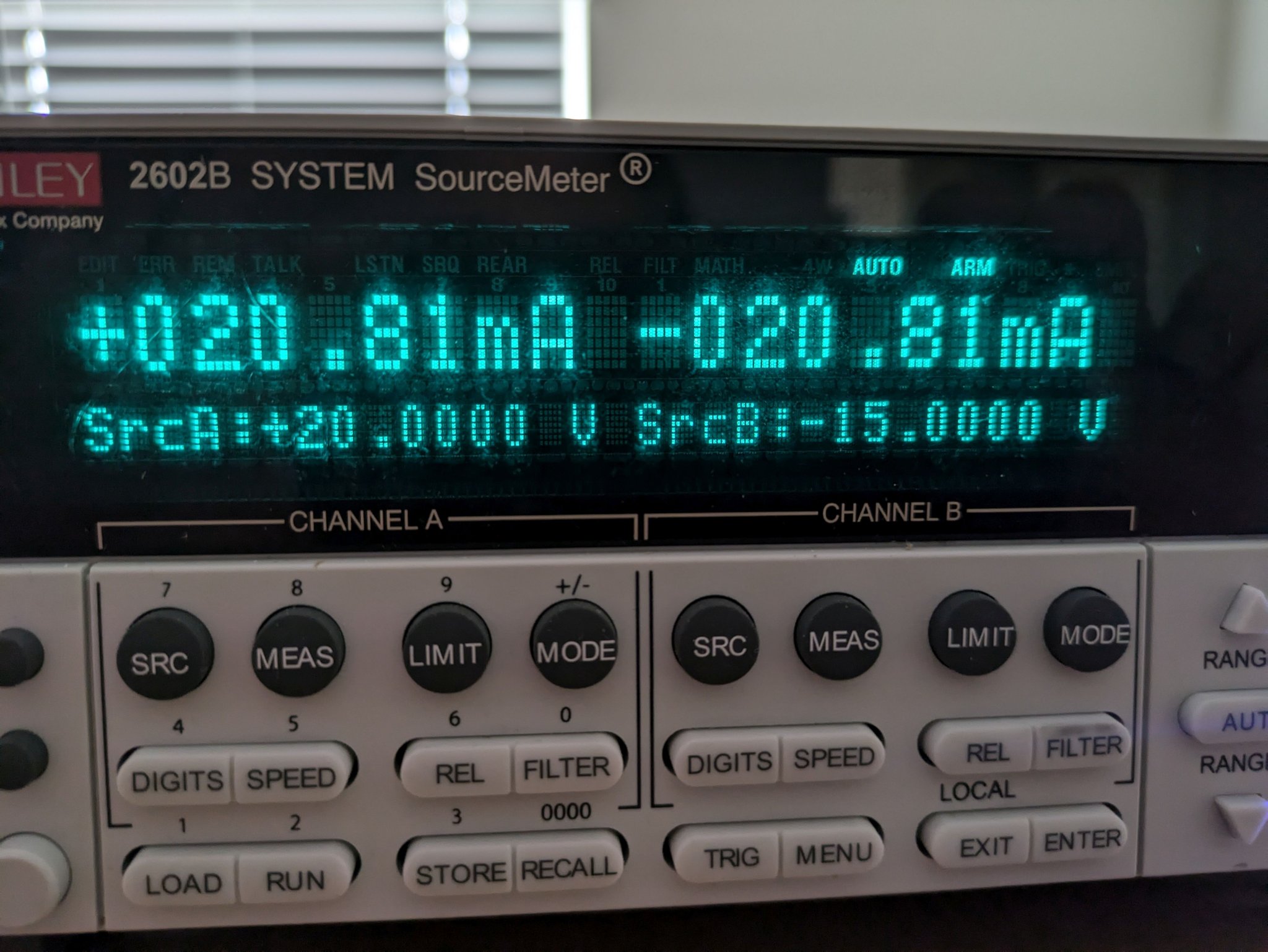

The buffer idles at ~ 20 mA.

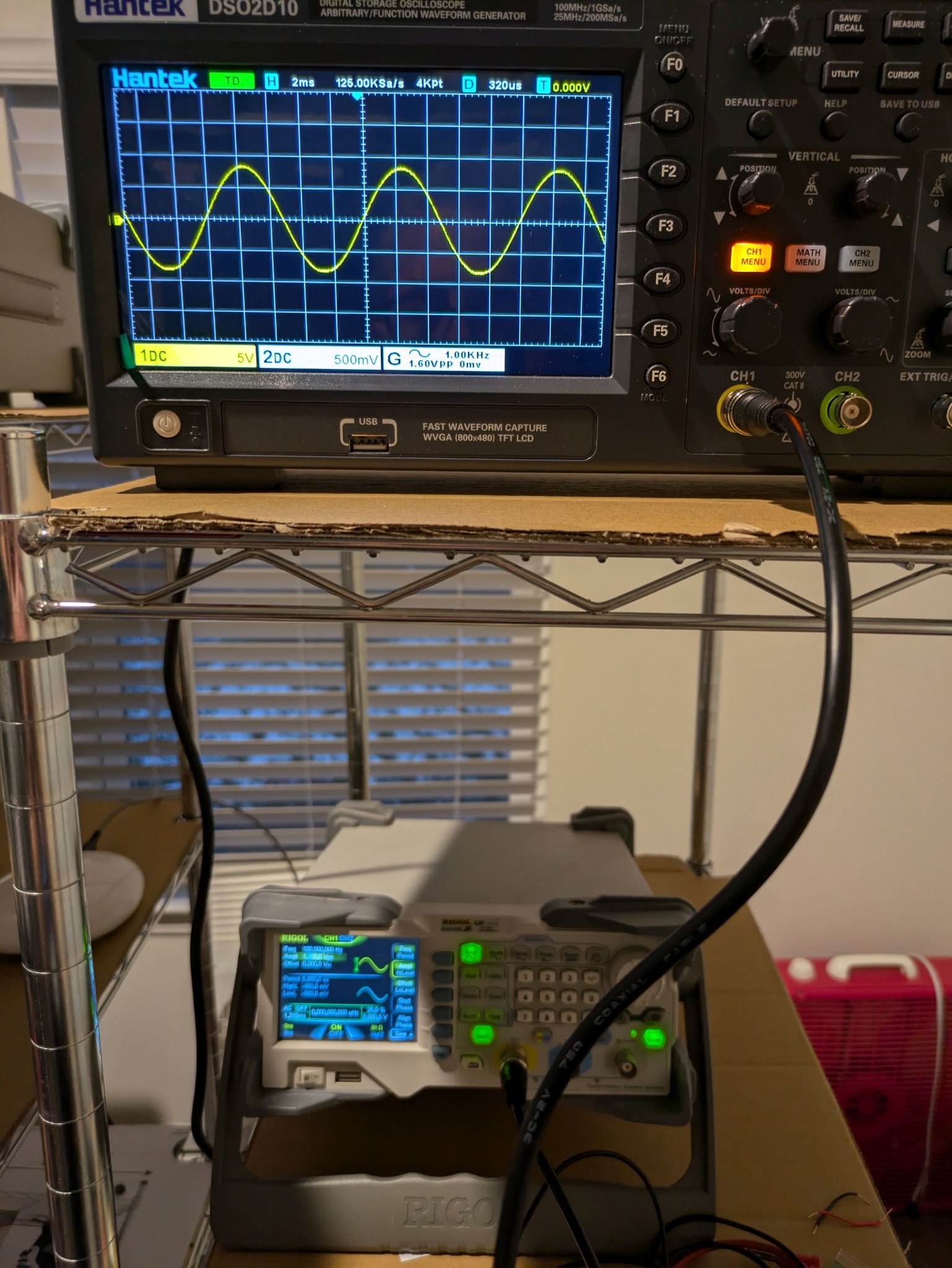

My sig gen puts out 20v p-p max.
Sig gen freq 100Hz.
Unloaded, buffer output is 20.011 v p-p
With a 500 ohm load, the buffer output is 19.044 v p-p with no visible clipping
With a 400 ohm load, the negative going half has visible clipping.
Delta V is 0.967 p-p
Delta I is 19.044 / 500 ohms = 38 mA p-p
Output impedance is Delta V / Delta I = 0.967 / 0.038 = 25 ohms
RMS output voltage = 19.044 / 2.82 = 6.753 v RMS
6.753 ^2 / 500 ohms = 91 mW power delivered
A 10-cell board could deliver 910 mW into 50 ohms.
A 72-cell power stage could deliver 6 1/2 watts. 72 cells is what my latest PCBs have for the power stage.

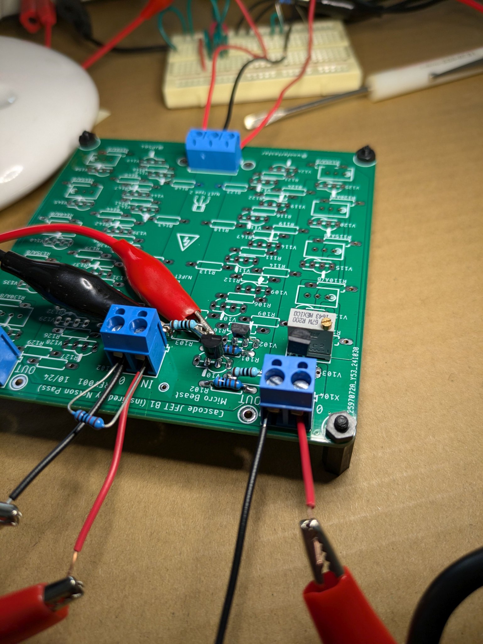

Here is the first 10-cell board layed out by JPS64. It is the Cascode series B1.
I have populated the first cell in order to shake down the PCB.
I plan to populate two versions.
1. 20 mA per cell with + / - 15v rails
2. 10 mA per cell with + / - 30v rails
The idea is to operate the J111 and J113 at 300mW each of which is about 1/2 of max power each.
The cascode voltage of the gain JFET is around 5V.
I am populating this PCB with ~20mA Idss gain devices.

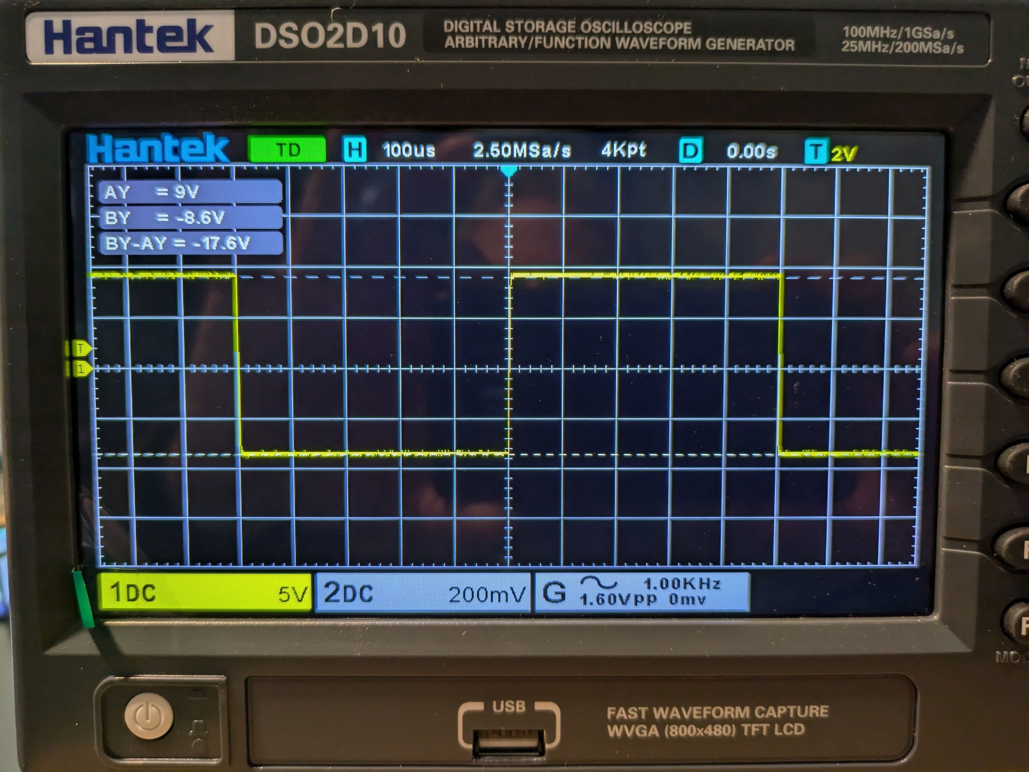

I sorted out the sig gen. Got a good square wave capture. 1kHz, 18v p-p square wave output into 8 ohms.
This is just about 10 watts real power for the square wave. It is essentially 9 volts continuous into 8 ohms. The 8 ohm resistor is nicely warm on a cold day.
