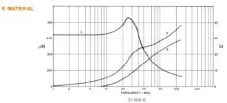

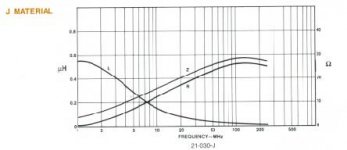

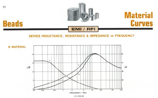

Beads are inductors; put one on a LCR bridge with an extremely low test voltage or current and you'll see an inductance value. The datasheet probably has an inductance vs current curve too. They just happen to be extremely bad inductors which saturate under extremely low currents, and have an ungodly amount of core loss. So much that when you put any MHz signal through them their impedance is dominantely resistive.
They're incredibly useful because they dissipate EMI instead of radiating it or "bouncing it off a capacitor" in a typical LC filter, their low L avoids inductive flyback trouble with changing power supply loads, and they pick up very little EMI.

Yes sort of. They have a reactive part (inductive) and a resistive but the inductance is hardly wL and the resistance is hardly R. Compare the graphs from Mr. Homo.gmarsh said:Beads are inductors

They are a part which have two properties, an reactive part and one resistive part _but_ both those two components are unlinear and frequency dependent. The good thing is that they can absorb energy.

They are a resonance circuit with loss to dissipate energy in a certain freq area.
\Jens
They certainly behave like inductors when the higher frequency material beads with a couple of turns of wire are used in video filters and in rf amplifiers. The low frewuency materials have the useful property that they go very lossy before they go self resonant so they present a useful impedance and attenuation at high frequnecies
