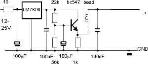

"Bead", what is that?
Beads are inductors; put one on a LCR bridge with an extremely low test voltage or current and you'll see an inductance value. The datasheet probably has an inductance vs current curve too. They just happen to be extremely bad inductors which saturate under extremely low currents, and have an ungodly amount of core loss. So much that when you put any MHz signal through them their impedance is dominantely resistive.
They're incredibly useful because they dissipate EMI instead of radiating it or "bouncing it off a capacitor" in a typical LC filter, their low L avoids inductive flyback trouble with changing power supply loads, and they pick up very little EMI.

This is what they look like. Typical mix.

What I am refering to is placing a bead over the AC mains cable to to your computer, or any other EMI making gizmo, so that you can watch TV or listen to the radio again. Yes, sometimes you have to use a toroid.........make several turns...........
The point is: an inductor could not remove noise by just being placed over the mains cable. Just because it does have some inductance is no reason to think of them as such.
Go read the sites of the guys who make them.........let them 'splain the technical mumbo-jumbo how they work.
Jocko
They certainly behave like inductors when the higher frequency material beads with a couple of turns of wire are used in video filters and in rf amplifiers. The low frewuency materials have the useful property that they go very lossy before they go self resonant so they present a useful impedance and attenuation at high frequnecies
