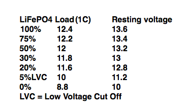

Art do you have any tables that show voltage vs charge percentage for LiFe batteries? Just curios so I know what percentage I'm at while using the radio....
I know that may be tricky when the radio is in use, because most tables are for resting voltage, not in use.

That would make sense, the LiFePO4 have a higher full charge voltage than LA batteries.Art do you have any tables that show voltage vs charge percentage for LiFe batteries? Just curios so I know what percentage I'm at while using the radio....
Just from the few times I checked over the weekend while using the radio, with the panels connected, in full sun, the voltage with the LiFe battery was still higher than even the big lead acid batteries were at full charge, In full sun!
I have seen no state of charge tables for LiFePO4, the very narrow range from full charge to discharge makes it difficult to estimate.
I made my own chart, the one below is the second revision (version one resulted in me pushing the bike when I thought I had about 30% left 😱), divided by four from my 48 V pack estimate.
Your radio won't average 1C (40amp) draw, so your "load" voltage will be higher.
The LiFePO4 recover to a resting voltage much faster than LA.
If you don't have a LVC, get one, the LiFePO4 just go from good to nothing in a heartbeat.
A $25 LVC will save your batteries if you don't happen to be looking at your VOM when the sun goes behind a cloud and the voltage falls off the cliff.

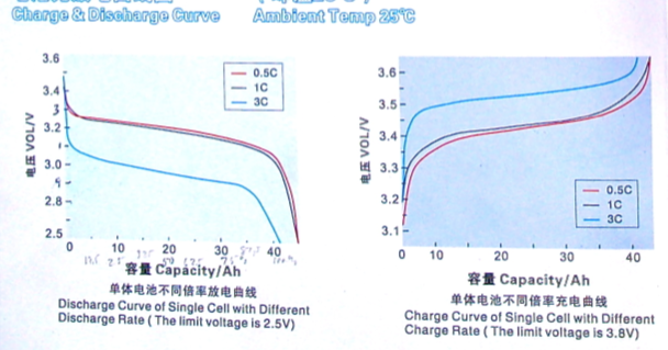

14.6/4 is 3.65v, considered "safe" for these LiFePO4.
The topped off voltage drops from 14.6 to 13.6 very quickly which is why I used 13.6 as 100% charge in the state of charge chart, when 100% could actually be as high as 15.2v for a few seconds.
Good idea to initially check the individual cells, if one is not accepting charge, even at 14.6v finish some of the other cells can be overcharged.
I over discharged my pack, had to individually charge a few cells that went "over the cliff", they seem to have not suffered damage, but had me worried.
When I was testing my bike for distance, I individually tweaked all the cells to 3.8v, compared to just letting the charger quit at an average of 3.65v. It probably only amounted to a few % more distance covered, not worth the effort.
You can see in the discharge curve that anything above 3.2 volts per cell is gone in a hurry.
