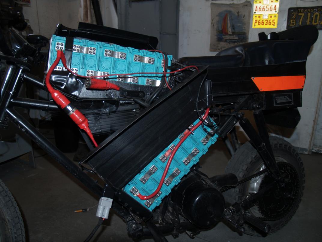

I recently upgraded my electric bike batteries from SLA AGM to LiFeP04.How about just the sub in the cooler and some small satellites you could stash in a backpack?
I was looking at the lithium motorcycle batteries for a burningman bike project. 36ah/ 5lbs.
Went from an effective range of only 4.2 miles before voltage sagged too much to be ridable to 39 miles.
Less weight, a lot more $$, but worth every penny.

I am using the GBS-40Ah from GBS Lithium BatteriesHmm how much are we talking for a comparable battery?
I used to work at a truck part store, they deal exclusively with deka, I can get the group 49 for around $75. And it will fit in a sturdy duffle bag that I have, at 50lbs it should be a breeze to carry strapped around my shoulder.
Four in series are nominally 12.8 Volts, would weigh only 12.4 pounds, cost $248.
The amazing thing is you can pull peaks of 400 amps out of the pack with hardly any sag.
You can get by with much lower rated Ah LiFP04 than lead acid because they have virtually no Peukert's effect. Discharge of 80% causes no problems with them (over 1500 charges), but drastically shortens the life of lead acid batteries.
You would want a voltage regulator for the PV panel, LiFP04 can be damaged with too high of voltage in, though the size panel you have would probably be no problem under load.

If you put connectors every 4 batteries, you could use them in parallel for a nominal 12V or series for a nominal 48V, or series parallel for 24V.I have a E-scooter that I would love to upgrade with 48v lithium batteries , then hope to use them with a portable PA. (Price of lithium packs is still too high)
Still debating if a decent 12v car amp will work better than TAS5630 chip at 50v
My 24 volt motor really has some "get up and go" with non-sagging 50+ volts.
Turned the bike from a toy to something that can actually climb the mountains around here.
I just have to be aware that I can do 24 mph all day, but 48 mph for only short bursts or the windings will smoke...
