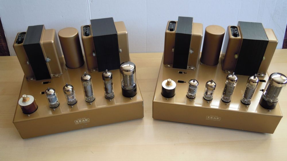

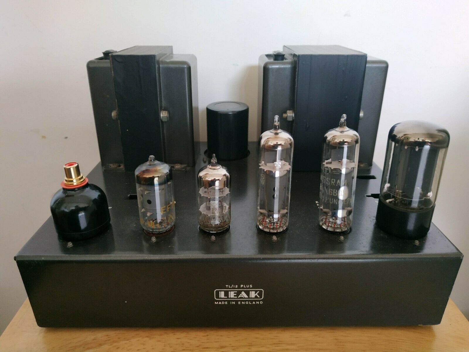

I just could not stand not to by one Leak 12TL+ mono power amplifier yesterday. Same color and else like mine. More than decent amp after replacing old parts. Now I am go to stereo! 😛
