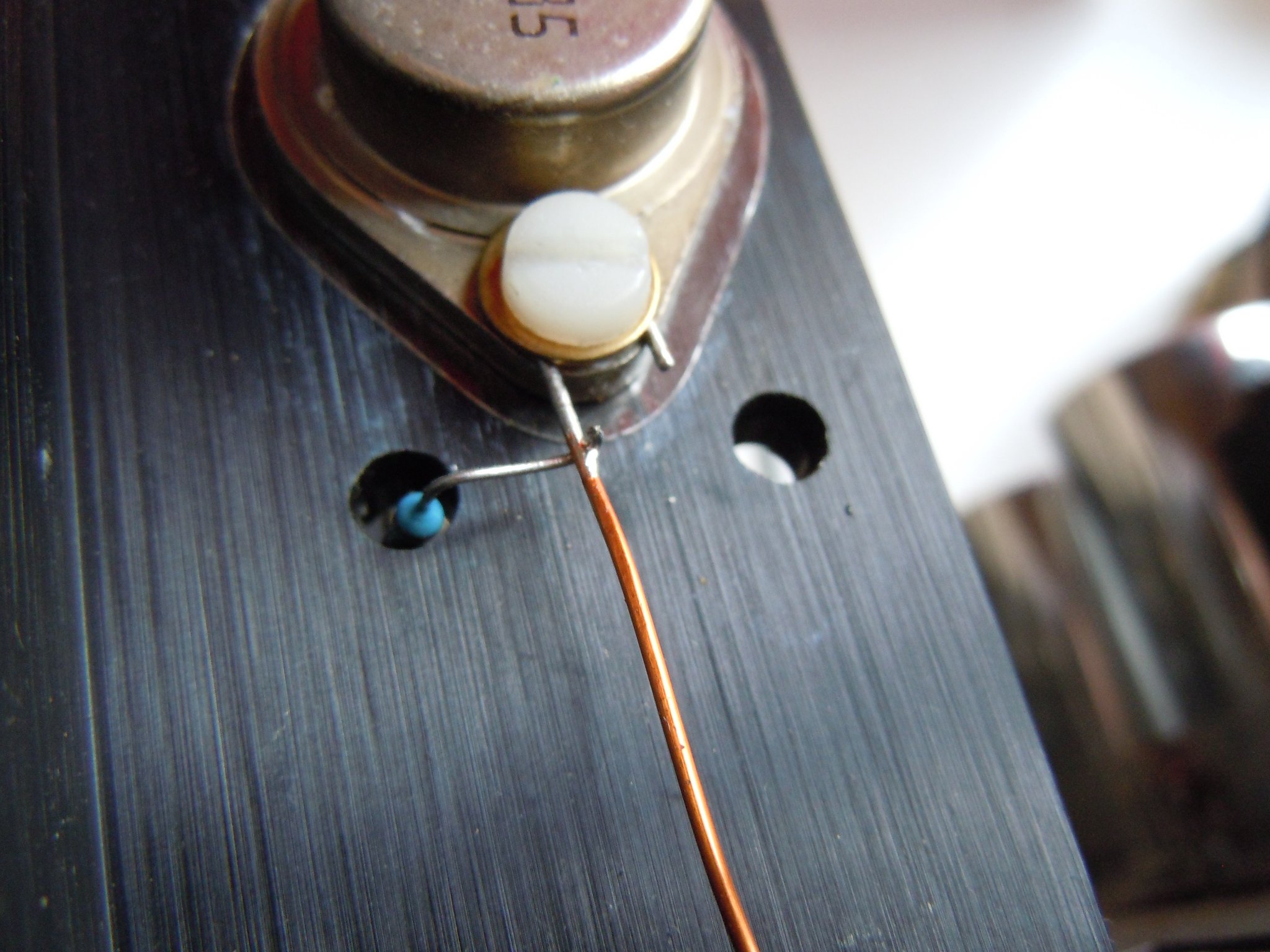

The usual problem with TO-3 casings is also their connection. Usually the collector (I also have emitter types here) is connected via a screw. This is usually not copper. Then there are washers, nuts, sometimes connection via both, two screws...-) I think there are many disadvantages here.I'm out...

By the way - regarding TO-3: I recommend attaching them in roughly this way to take power and signal into account to some extent - the difference is clearly audible:
