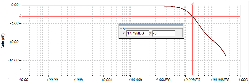

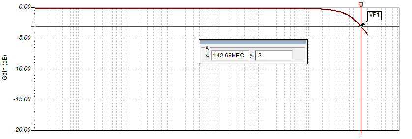

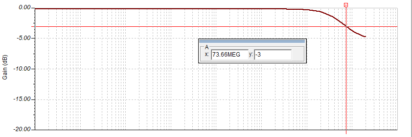

I have 3 spice Models, lets all start arguing = Dont care. Observe list for obvious reasons
1) BD139 from TinaTI library
2) BD139G from OnSemi/Modpex Model dated 2004 for current production
3) MJE243G from OnSemi/Modpex Model dated 2003 for current production
All examples tested under SAME CONDITIONS in model = 0dB gain ( emitter follower) Vce 5 volts Ic 50ma with DC bias
Frequency will be marked -3 dB ( frequency scale listed in 243 only = sorry, all graphs scaled the same)
1) BD139 from TinaTI library = 143 MHz
2) BD139G OnSemi current production Modpex Model = 74 MHz
MJE243G OnSemi current production Modpex Model = 18 MHz
