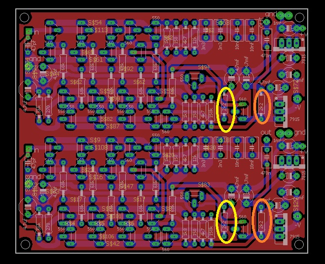

what about resistors in orange oval in PSU section, is it correct value? what about in yellow oval? do you have some accurate schematic?
22k is rightwhat about resistors in orange oval in PSU section, is it correct value? what about in yellow oval? do you have some accurate schematic?

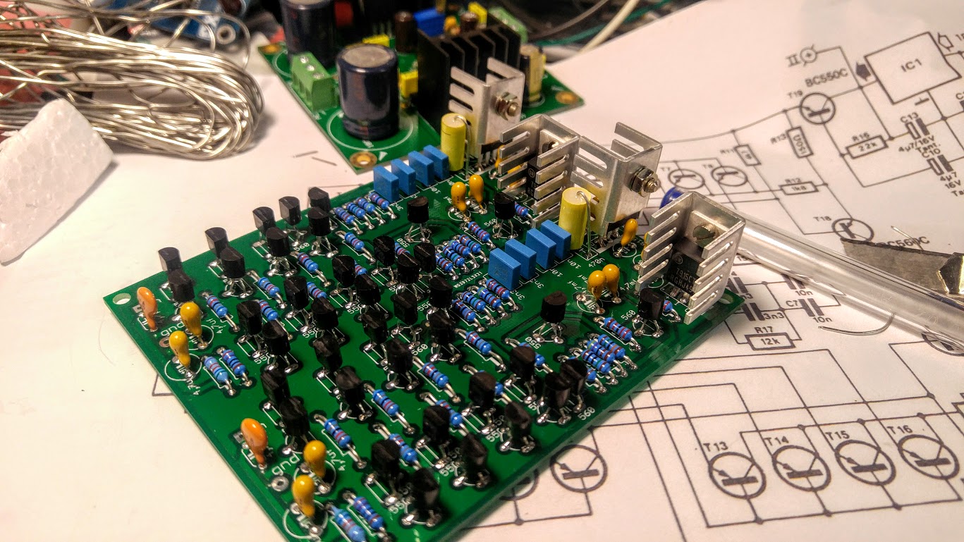

The original SLN Elektor preamp was the first RIAA preamp I assembled. I made the pcb myself following the original Elektor design. This was about 35 years ago, so some of you weren't even born yet!
The sound was very good, but what I could not control was a hum that apparently the supply was causing. The brain cancels the hum after some time, so I could listen and evaluate the sound quality anyway. But I ended up discarding it and later on extractin the parts for another project. That was a mistake.
But I think there're two parts I would suggest everyone to change: the regulators. Use at least 3X7 types instead of the 7X15 types. I remember substituting one 317 type on a single ended RIAA preamp, replacing a 7815, and the improvements were enormous.
If I remember well, the SLN highs were a bit over the top, but that also made some records to sound very much 3D, pinpointing jazz instruments, for instance. The RIAA caps were a dark green 10mm x 5mm I could never identify. They were 2% types. At the time I knew little of capacitor types. Certainly I would use polystyrene or polypropylene now.
Recently I thought of redesigning the pcb, routing the grounds in a different way. I wonder why all the secrecy involving the Supra 2. When I first saw the pcb I didn't know the ICs were LT1028s in parallel. I thought every IC held two transistors. That might be cool way to assemble the Supra.

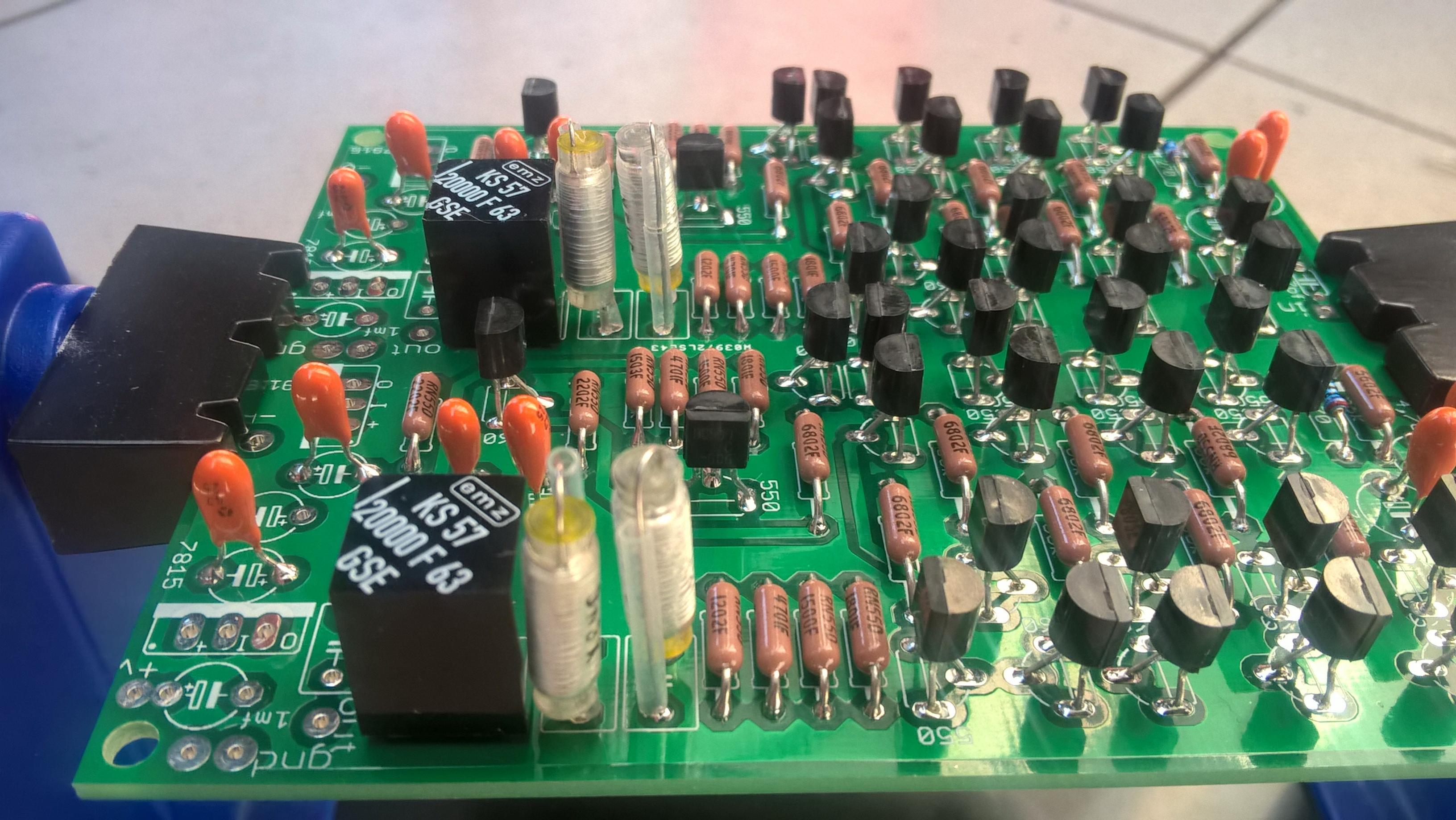

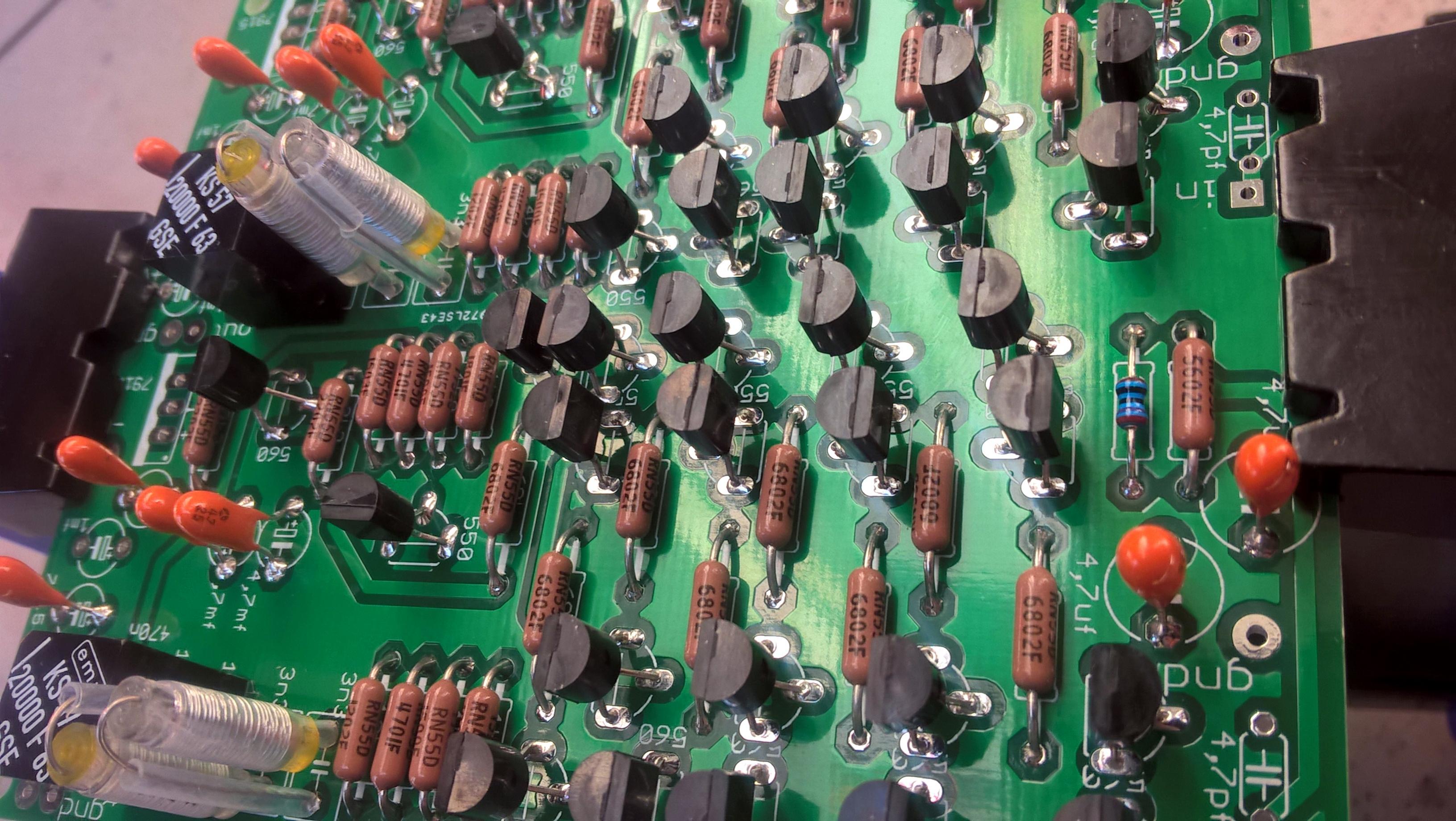

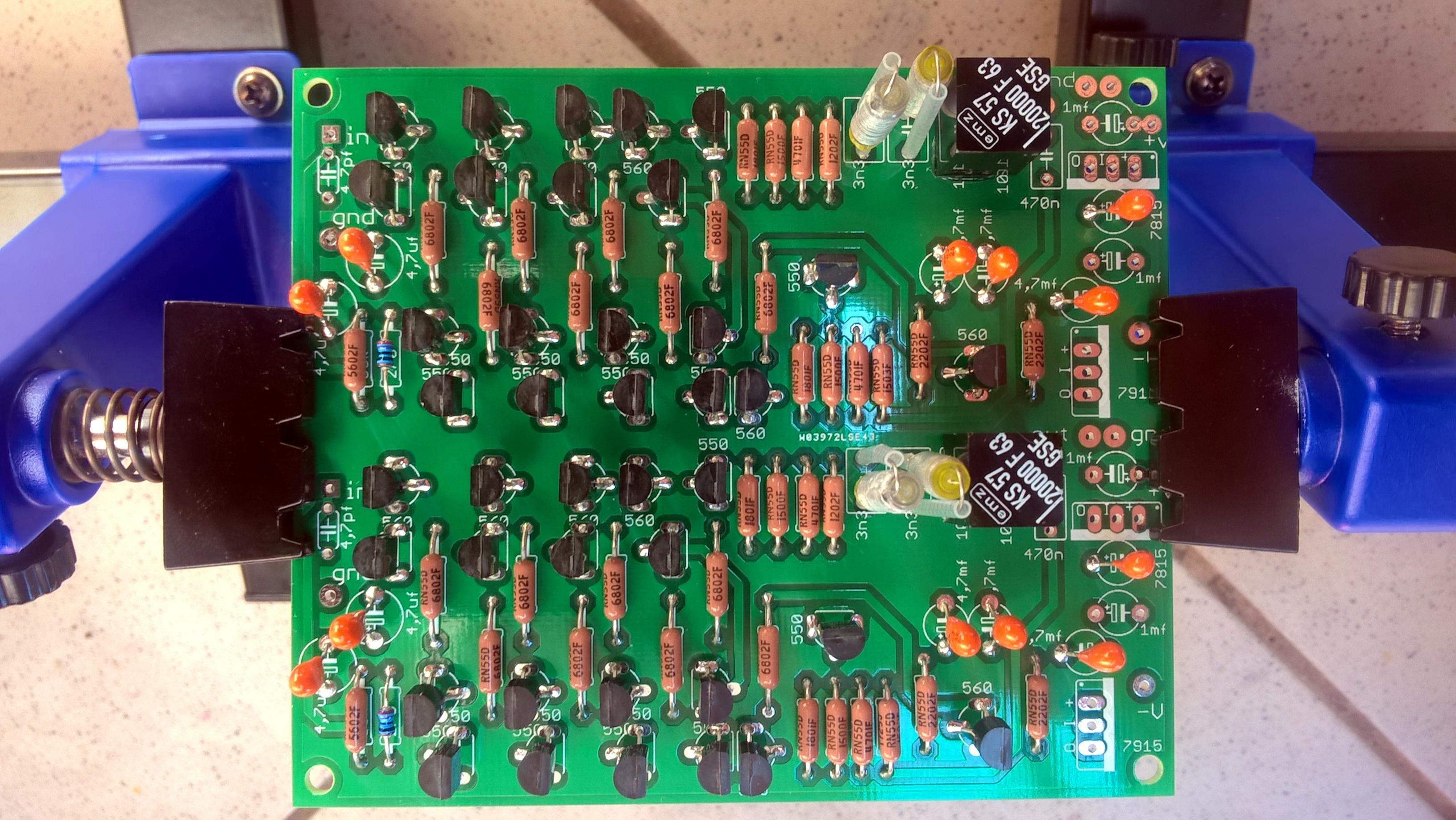

I made a PCB layout and made some minor changes to the circuit.
I did not have the exact values for some Rs and Cs, so I used some flying soldered parts for the first test.
It works, sounds OK. One board is for one channel.
Very nice! Congratulations!
What did you think about the sound quality?
What regulation are you using for it?

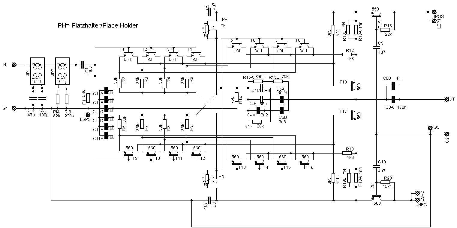

Some questions:
1) Why did you add C1 (4u7uF) that is not on the original project?
2) Why didn't you separate, at least on the schematic, the audio grounds from the supply grounds?
3) Your pcb design is single sided or double sided?
4) How do you do to see the THD on the LTSpice simulation?

Thank you carlmart 🙂
Sound:
I just tested it briefly, (with some classic music -Mozart, Mussorgsky-, and some Rock, Funk), and it sounds okay to me.
I can not confirm the exaggerated heights described by others.
I'm currently using an ortofon OM-pickup
Regulation:
You mean power supply? Currently it's a simple circuit with LM 317/337 regulators.
#1.)The offset DC voltage at the output (before C8) is also dependent on R1. I want the offset to be as small as possible and constant. If you connect the pickup and/or additional resistors to adjust to the pickup, the offset changes. The C1 prevents this. The offset then would change in the range from approx. + - 500 µV to approx. + -10 mV. But one can perhaps tolerate this, because there is also the output capacitor C8.
The output offset can be matched with the trimpots.
#2.) ???
That is probably due to my handling of the layout program. There is only one "ground" there.
But don't worry, there is no hum or anything like that.
#3.) Both. 🙂
The top layer is just ground/shield
#4.) e.g.:
- replace the semicolon at the "tran..."-line with a point
- replace the point at the "ac oct..."-line with a semicolon
- then run the simulation.
- view error log
I just realize that the parts indices are different between the circuit pic and the .asc-file. Sorry.

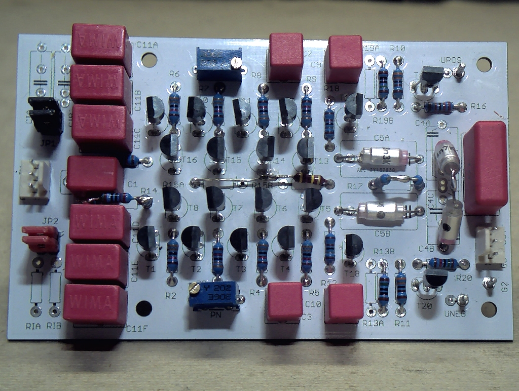

Back at the time of the first publication of the SLN, I built it using the same pcb they published, and I had hum.
Unfortunately I was impatient and inexperienced, because in spite of the hum the preamp sounded very realistic.
No cap at the input, and nothing wrong because of that.
The 7X15 regulators should have been replaced with at least 317/337. Nowadays I would use a pair of Jung superregulators.
What I think happens when you connect the pickup is surface noise and motor noise, particularly on belt driven record players. What should take care of the offset is a DC servo, also eliminating the output cap.
