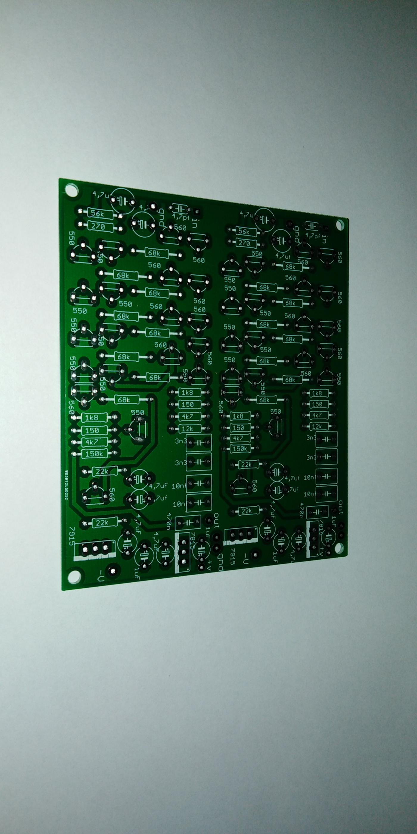

OK, let's go back to using these 2SA/2SC pair on the SLN.
What things could or should be changed/adjusted to better tune it to an MM cartridge?
Someone had mentioned the LTP current. To how much should be it be adjusted?
Increasing the power supply voltage seems to reduce THD, but is it worth it?
Should the output transistor pair be the same 2SA/2SC?
What about using a DC servo or not? If we don't, a large feedback cap should be used, and an output cap too.
Theoretically, the noise optimum should be around 70 uA tail current when you use a single NPN and a single PNP differential pair, otherwise 70 uA/n per pair when using n NPN and n PNP pairs. I would recommend that value if and only if it results in an acceptable loop gain, so in good RIAA conformity and not too much distortion. Otherwise as close as you can go without degrading the RIAA conformity and distortion too much. The noise optimum is broad, so using a somewhat higher current will not do that much damage; you have to exceed 430 uA per pair (at hFE = 400 and assuming a single NPN and a single PNP pair) before the base shot noise starts to dominate over input termination resistor noise.

I just checked now on the simulation, with 68K tail resistors per pair, and current is at 196uA on each tail.
Should it be better to lower it?
Assuming that you have only one NPN pair and one PNP pair:
The noise should improve when you use 180 kohm tail resistors instead, but only slightly and the distortion and RIAA conformity may get worse.
Assuming four pairs each:
The noise should improve when you use 820 kohm tail resistors instead, but the distortion and RIAA conformity may get worse. You may have to find some compromise value.
