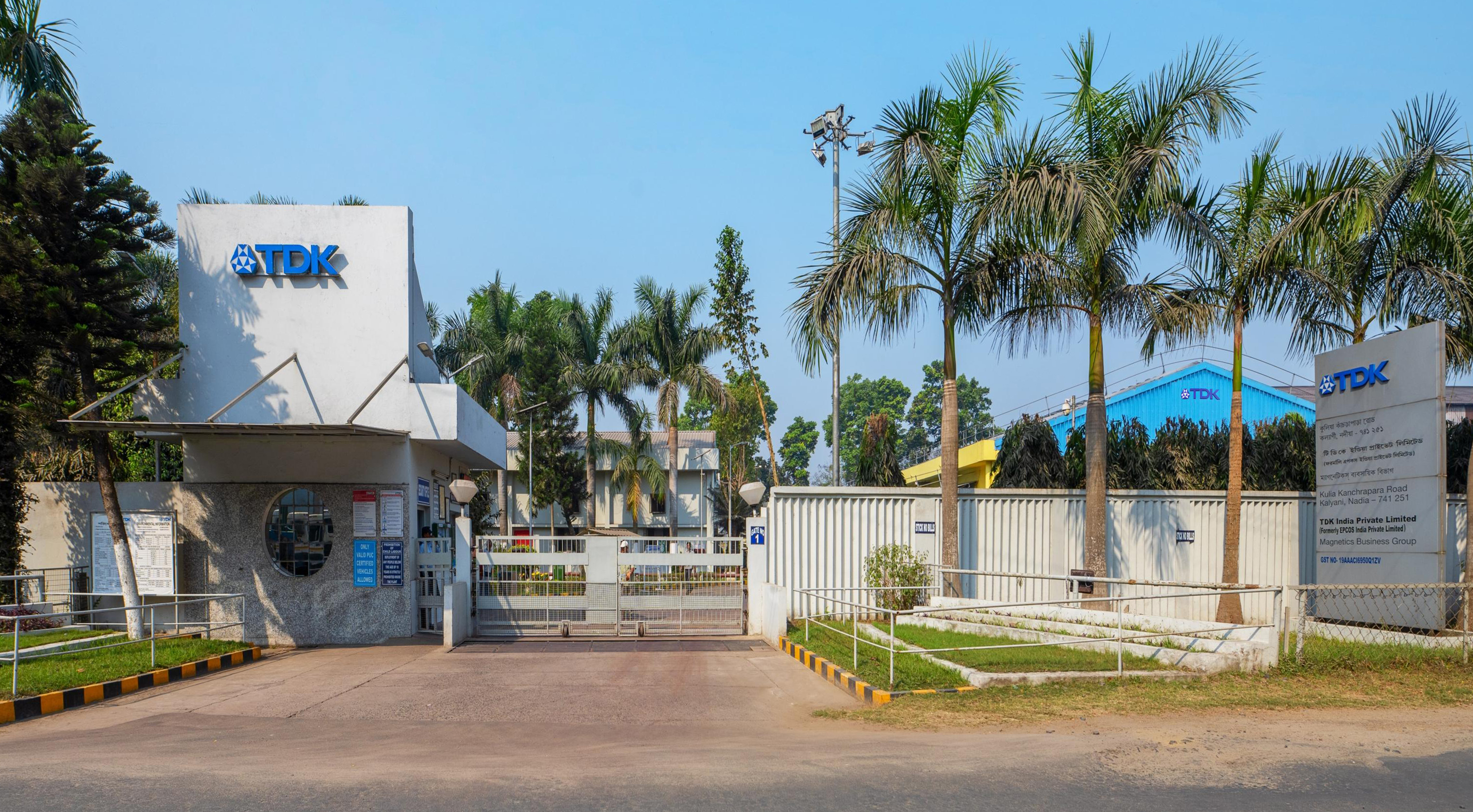

WHY do you say so?That CDIL maker I believe is located in India, which doesn't entirely inspire much confidence.
Sound like bias and prejudice to me.
There must be some reason for very high quality component makers such as EPCOS/TDK install plants in India, don´t you think?
A couple TDK capacitor and ferrite factories in India:
