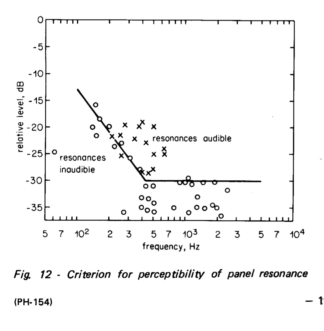

Panel resonances not only vary with panel thickness but also with panel size and more specifically with the ratio of panel dimensions. So very generally, smaller panels have higher resonance frequencies than bigger ones and more specifically, longer, narrow rectangular panels also have higher resonances than square panels (depending on actual dimensions of course). Also, adding mass without adding stiffness (ie. damping) not only reduces the amplitude of the resonances but lowers the resonance frequency as well.
So you should take note of the size of your panels vs the size of BBC's because I suspect that the BBC was using larger side panels than 33cm x 13cm. I'm not that versed in the BBC's methodology but it might be good to know what their target panel resonance frequency was. Was it 300Hz? 400Hz? The attached chart suggests that the resonance needs to be down 30dB for frequencies that are above about 400Hz to be inaudible and that it can be progressively louder than that as you go lower in frequency and still be ok as well.
Using Steinberg's formula for panel resonances that diyAudio lists here, I calculate that your 7mm x 13cm x 33cm side panels if made with Baltic Birch plywood will have a resonance frequency of about 750Hz. (Would a poorer quality plywood have a higher resonance frequency?) That frequency will be lowered with 8mm of damping but it still doesn't look that good to me. It still looks like you'll end up with audible resonances somewhere in the 400Hz to 600Hz range.
Now if you just changed your cabinet depth from 13cm to about 20cm, you'll be starting with a panel resonance with BB closer to about 350Hz and now that would be looking a lot better. Theoretically anyways.

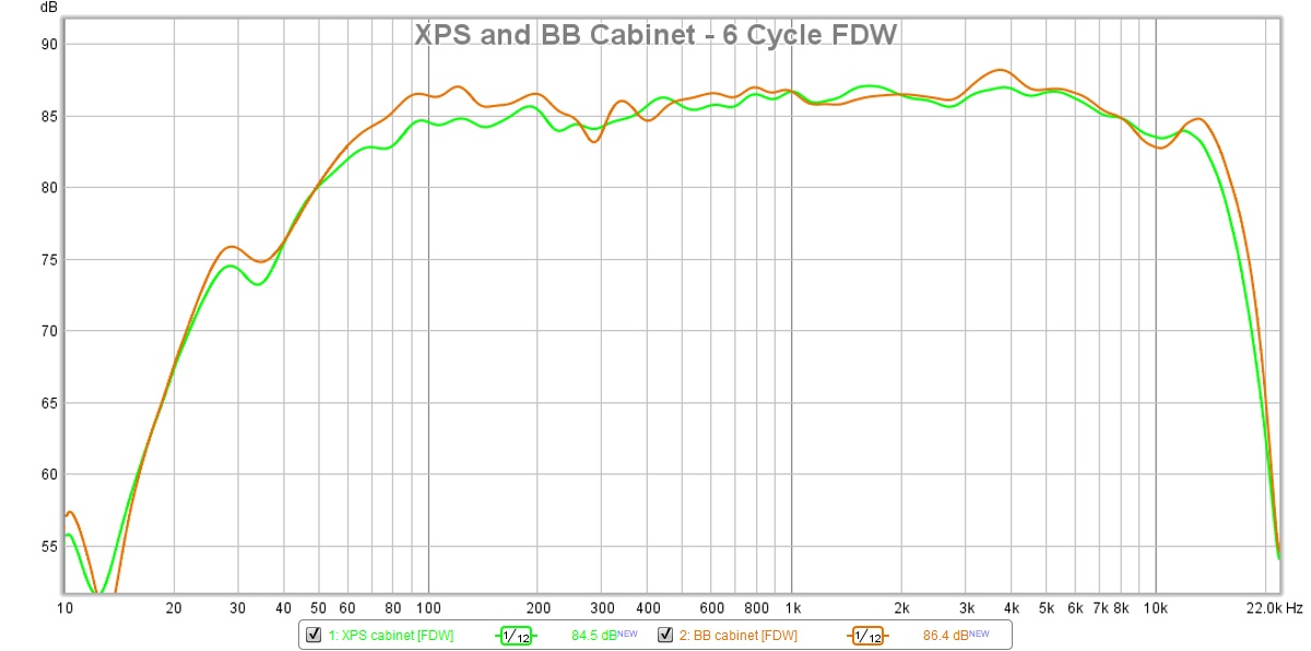

Heavy “dead” panels are not necessary for a good sounding speaker. You can have a box that is about as light as air using XPS foam, and if well-braced and has a thin wood veneer to allow drivers to be mounted via screws, the measured frequency response and harmonic distortion are very similar to a good Baltic birch plywood box.
10F/8424 & RS225-8 FAST / WAW Ref Monitor
Here is the internal construction of the XPS box (no butyl mass loaded sheets, no eggcrate foam, just polyfill or fiberglass stuffing):
XPS: Distortion and frequency response measurements...
18mm BB plywood (with mass loaded butyl sheets on the inside and full eggcrate foam on inside with polyfill stuffing):
I always prototype in foamcore or XPS and build in wood later. However, the foam speakers often end up sounding just as good after I make the wooden ones. The wood looks better and is more durable. But I have seen that light foam panels that are braced can make excellent speakers. Even larger synergy or tractrix horn type speakers or large TLs. If you are interested, here are dozens and dozens of speakers made of foamcore or XPS:
Foam Core Board Speaker Enclosures?

Thanks for posting this! I checked the LS3/5A dimensions and its 11.9" (30,4 cm) high by 7,4" (19 cm) wide by 6,4" (16,5 cm) deep. So even though side panels are somewhat deeper, its not a night and day difference, its somewhere between my 750 Hz and 350hz of a 20 cm deep panel.
I checked the 1977 BBC paper and it looks like LS3/5a panels didnt have much resonance between 100 and 200 hz. Resonance bahaviour of side panels was pretty smooth without distinct peaks and dips (thanks to damping) but it was elevated between some 450 Hz and 1500 Hz.
So I should either brace for the hope of pushing the resonance closer to 2kHz territory where tweeter takes over or use a different or thinner material.
BBC approach doesn't seem valid for such small boxes, though panel damping is always a good thing (unless its a sub). Thats a huge surprise.

This is not a fair comparison, given that the enclosure will have timing and directionality aspects that a response plot can neatly sweep under the rug.

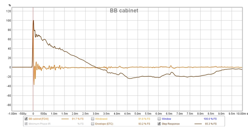

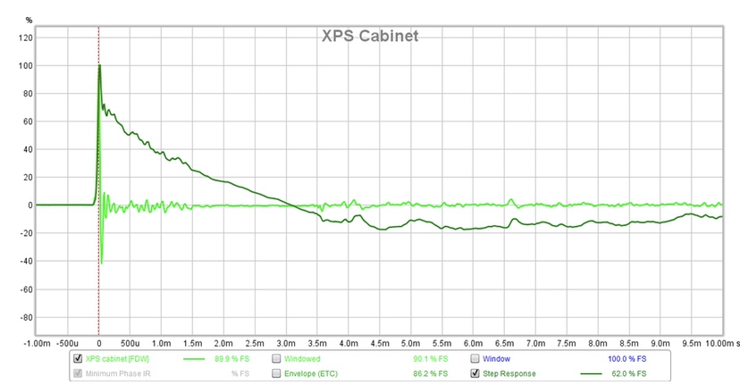

Timing wise, the step responses are nearly identical. Polar plots also don’t have much of a difference. I lost that data in a hard disk crash but remember it was not notable. About the same. So not sure what else is “swept under the rug”. I’m not hiding anything - if there is data you want to see please ask for it.
When removing my inline figures in a previous post where comparison data was shown makes it hard for people to appreciate the data without actually reading the other thread.
Here is step response in XPS:
902397d1608154412-bbc-style-thin-wall-enclosure-thin-44204f89-9eba-41e4-bb17-b0ce30ab4a9b-jpeg
And here is step response in BB plywood:

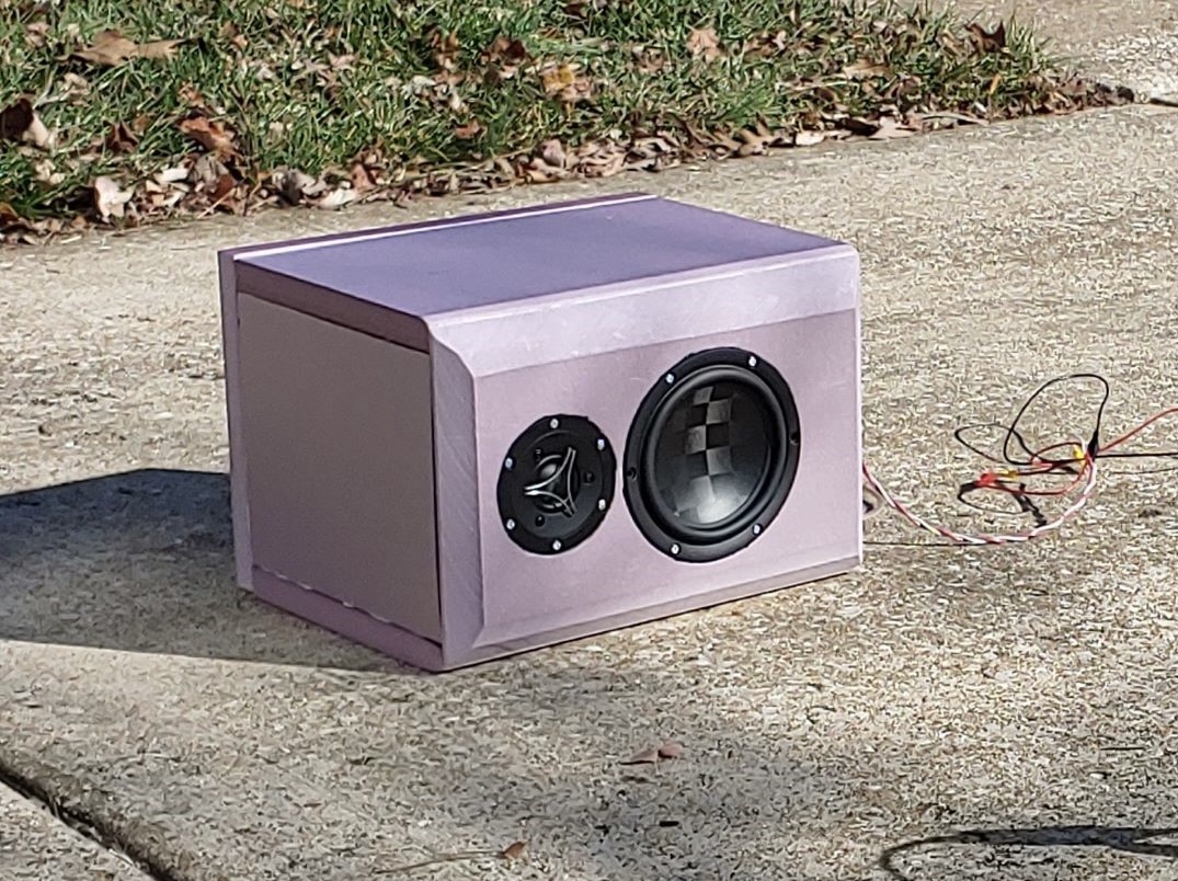

Btw, other members are also starting to use XPS to build speakers. Here is a nice one by hifijim:
Image borrowed from this thread:
