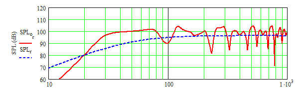

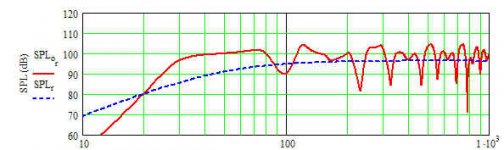

These specific cabinets will be very powerful to 30Hz (~ flat, ignoring a little of ripple) with a final cut off of around 18-19Hz.
Yikes! 😱 I've never heard a TQWT with really good bass, but never heard the BIB or anything like this crazy BBBIB. If it really is powerfull to 30Hz, it will be a monster.
Let me put it this way. My BIB cabinets with the 6 1/2in Fostex FF165K (which, for your interest, are 70in tall x 9in wide x 14in deep) are flat to 30Hz in-room & have a final cut off at about 20Hz, give or take. They're about 99db efficient for 1w at 1m. My friend Dan Mason has a pair of similar proportions using the FE168ESigma, which go almost as low. And no, I'm not romancing. These things thunder. So yup, this big thing really will give a lot of bass.
This cabinet is a little exceptional -it's much larger than most of the BIBs that are built in terms of footprint, but the driver has a high Vas, so it needs it. GM & I did one for the Visaton B200 which has a 102 litre Vas and a high 0.7 Qt, so that too needed to be considerable. Terminus area was 350in^2. And I had a mad moment, threw the usual conical expansion aside and did this for the Hemp FR8: http://www.zillaspeak.com/bib-hemp.asp See 2nd cabinet & you get the idea... 1x4x9 anyone? 😉
The swamping bit (that's technical language you know ;-) varies according to the driver's Vas, it's Q, the tuning frequency etc. About 3 times Vas is the minimum needed. More is good.

Hmmmm- flatter but mucho bigger!
These dims are more as I feared
yow!
I guess one can choose any size in- between and get a compromise..

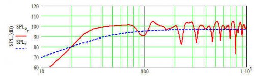

We can theoretically tune a little lower (though as Greg pointed out to me some time ago, it's a bad idea to tune lower than 0.707Fs) but that might put the driver too high, which is why I think both GM & I have restricted height somewhat. Driver height won't change with alterations to WxD.

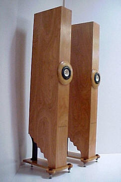

I assume that this one is "upside down" and vents to the bottom.
Doesn't seem to help the driver height that much.
So, ideally in a "conventional" BIB NOT like the photo should the driver be a bit higher or lower? ie should the closed end be longer or shorter than the number you gave me?
Top venting is actually pretty clever- In addition to being slightly easier to build, there are generally a lot less things in the way when you are that far above the floor, which probably makes for a better corner flare.
It would be interesting to know the excursion of the woofer at 30 hz. and various power inputs.... We only have 3mm xmax to work with I believe. I realize it's horn loaded, but still....

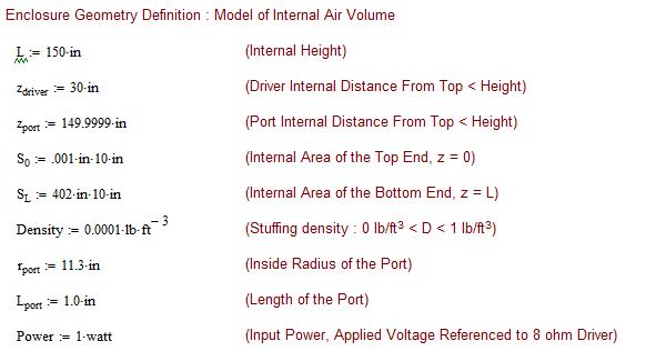

I was thinking about doing the same thing with an EV12trxb, and also with an EV15trx. I have Martin King's worksheets. Would you supply a screenshot of the input screen for the worksheet? I will modify appropriately for my dirver's parameters. Just need a starting point.
Thanks,
Paul
Thanks,
Paul
ML TQWT sheet. Use line length as per usual, set port position at 0.0001 less than length, 0.0001 lbs ft^3 stuffing. Vent radii is WxD /pi ^0.5
The reason Terry did the floor venting one is that particular cabinet is using the FE108ESigma. Fs for the 108 is a highish 77Hz, so the cabinet is rather short -too short, if venting upward, to couple properly into a corner. So he inverted it to couple to the floor instead. Upward-firing is the best option though -as you mention, & TC has in the past too, not much furniture to get in the way on ceilings!
I forgot to do an excursion graph, but if memory serves it doesn't go much beyond 2mm before cut off. I'll double check in the morning though.

402in deep seems a little excessive 😉 (see 1st entry for Sl) Other than that, yes, that's about it. Port length should be 0.0001in -sorry, forgot to mention that bit.
Scott,
Thanks for your reply.
SL is the area of the open end, isn't it? 16.5" x 23.5" = 402 in sq.
What am I not understanding?
Thanks,
Paul
Thanks,
Paul
Paul,
You entered
SL = 402*in *10*in which is equal to 4020 in^2
You probably wanted to enter
SL = 402*in *1*in
or
SL = 402*in *in
or
SL = 402*in^2
which all equal 402 sq inches
Hope that helps,
You entered
SL = 402*in *1*in
or
SL = 402*in *in
or
SL = 402*in^2
