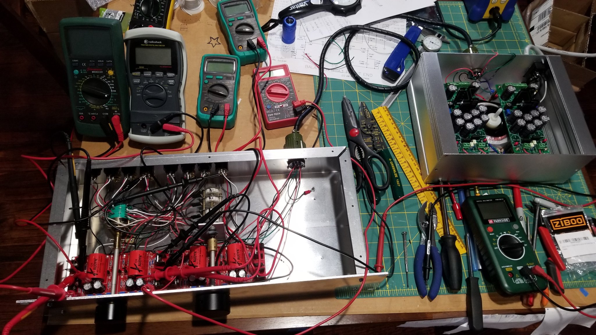

Thank you nash. I made up some XLR connectors as jumpers for the inputs. I'm too cheap to buy a single "U" shaped jumper for $8. Can get 5 male XLRs for $8. I won't lose them as easily.
I haven't had the urge to mess with P3. Maybe in the future.

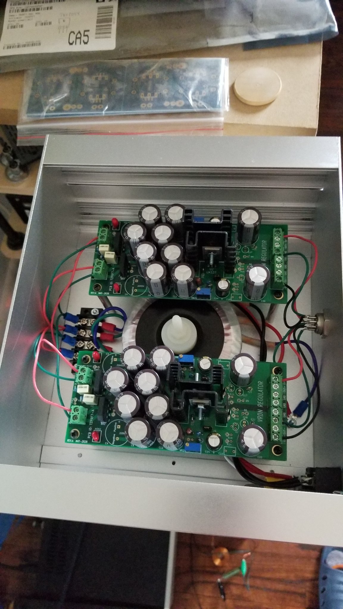

Thank you 6L6. How much current do you think they need? I want to build it as a Preamp.
It will be my second attempt at a MOSFET type Preamp. The first one years ago was that two transistor balanced one. Which I was a bit disappointed in. I put that down to the input capacitance that reduced HF detail.
Unless you can recommend something else that you think might be better?
