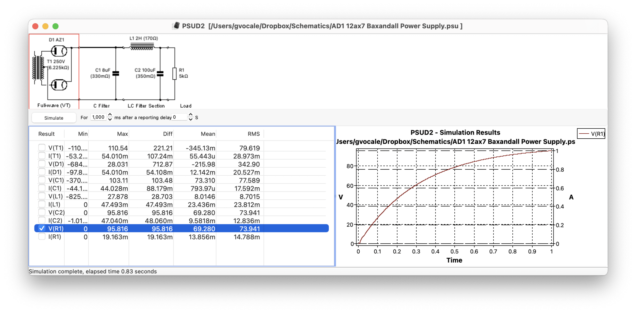

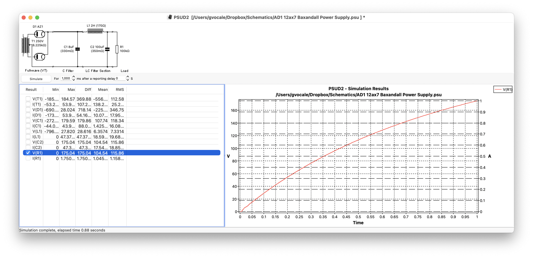

I have simulated the power supply on PSUD2. It's my first time trying to use it. I can't get the graph to populate, nor some voltages on the chart, see attached. I used 200Kohms as T1 resistance. I wasn't sure what to use so I just measured the resistance between the two 117v taps of the transformer. For C1 I used the 0.3r ESR resistance I measured on the 8uf oil cap. For C2 I speculated an ESR resistance of 0.2r. I left R1 the same, thinking is the bleeding resistor.
I was thinking of using the 6.3v @ 1.8a tap of the power transformer to power the 4v 1.1a filaments of the AZ1, using 1r 2w resistor on each of the filament to lower the voltage.
What's wrong with my PSUD2 model?

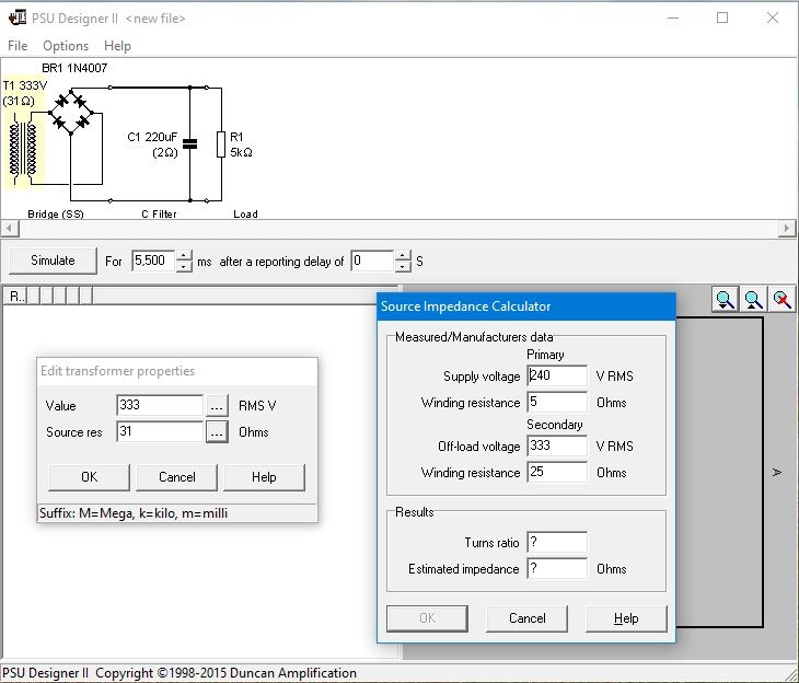

Yes the source impedance is incorrect. To establish the correct value right click on the transformer; then left click the three dots adjacent to "source resistance." That brings up the screen to enter the appropriate values.

The R1 on the circuit board is a different R1 from the PSUD estimated load. By chance, 100K is a reasonable estimate for your circuit's load, so keep it. Someone please correct me, but I think PSUD wants you to spec the transformer secondary as 500VRMS. Looks like it, anyway.
If the transformer primary (or secondary) really measures 200K there is something seriously wrong with it. Should be a few ohms, maybe tens, at most.
Where you are getting the current 6.2k for the secondary is anybody's guess, but it explains why you're aren't getting 250VDC. Again if this is a real measurement it's bad.
In any case it's too big. You don't need 50mA here.
