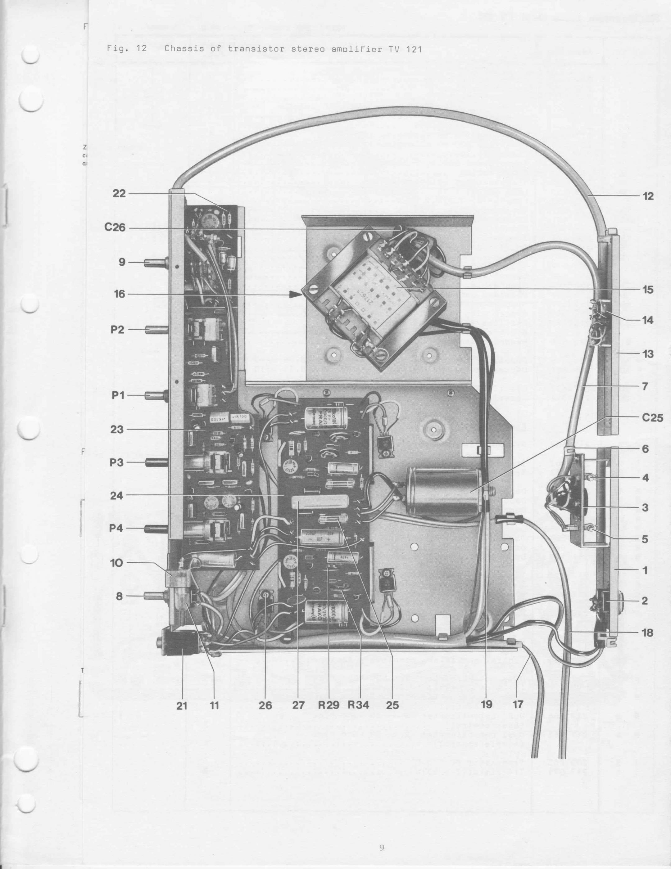

Yes, it's going to be tricky to put them in the heat sink though...Is it needed for this design? They definitely didn't do it. Just soldered them in the board like any other part. I've attached and picture where you can see the diodes between the two trimmers. Nothing fancy.
Three 1N4148 in series might work.
If the designers didn't put the diodes on the heat sink with output transistors, you don't have to. That controls output transistor heat better, but moving the stabistor there might cause oscillation, depending on how the board is laid out.
