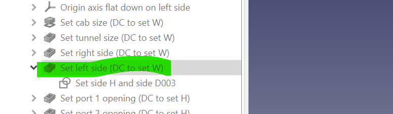

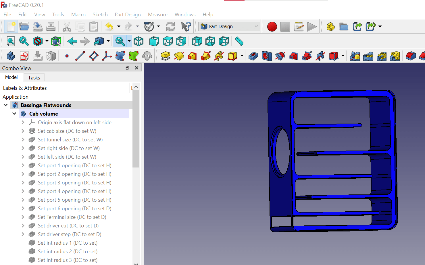

Open the template in FreeCAD and save as a new file named after your project. Now the template can be messed with without messing the template. It helps to keep the original open in the background for reference
On the left there is a list in the white sections. This is the list of all the dimensions that make the box shown on the screen
Template tips

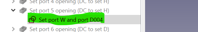

(DC to set) double-clicking on it will bring up a dialogue box with some numbers selected. Change this field to change the dimension
A little arrowhead means there is a sketch inside that can be adjusted by clicking on the arrowhead, then double-clicking on the sketch name
Cabinet features are in numbered queues on the list
YouTube tutorials demonstrate how to zoom around the object. In this template, the speaker box is laying flat on it left side

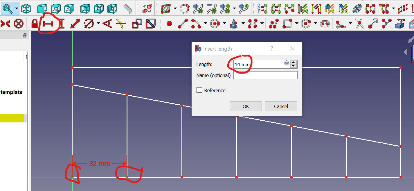

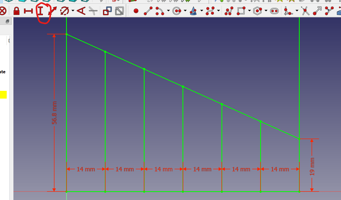

Let's load the table template and save it as 'flatwounds 4 inch 80hz'

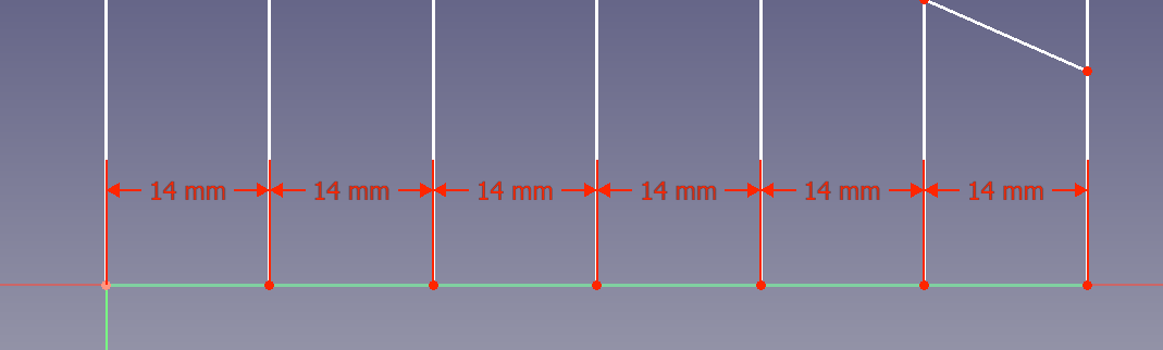

Click on the green line and first dot as shown, and they will turn to green. Click on the insert length icon on the toolbar and set to 14 mm. The table does not care about the units as long as they are the same. We will imagine that we are reading 140 mm. If we enter 140 mm, then the table will shoot out really wide and be a pain to handle
Repeat dot to dot to the last dot

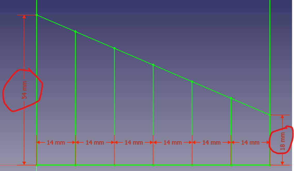

Use the height icon to set the first and last vertical lines. These are the mouth and vent worked out in offline audio modelling. The table should turn a happy green and is ready for conversion. Set the length of the second vertical line, and the table will get angry. It will show a length, that's the opening area of port two. Cancel to make table happy again
Save the file and let's work out the tunnel heights
Now make a list of tunnel cross-sections
Opening height = opening area 56.8 cm2 / cab internal width 106 mm
Opening height = 54 mm
Vent height = vent area 19 cm2 / cab internal width 106 mm
Vent height = 18 mm
Change the first and last vertical lines to 54 mm and 18 mm, like so. Double-click on the numbers to edit them
Now the vertical lines will show each port height instead of area, and you can get those numbers by making the table angry at each vertical line

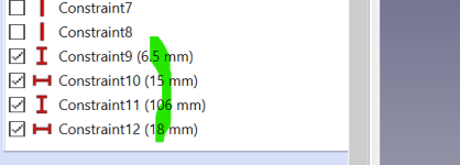

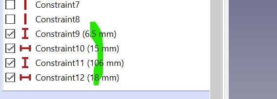

As can be seen in the attachments below, all the parameters can be edited and the template formed to just about any 6 segment volume, but this is not how to exploit the template. These are tools to use to extract numbers and get a visual on shape. There are a zillion steps to get to the end result, which is the jig/trim. Once the model is fully formed, it is sliced using a rectangle to create separate files for each jig area. This is the work that I have already done in the background over the last couple of days and extracted the numbers for the jig only. Since print speeds are slow and material costs are high, further manipulation of the template will be at member request
The template is the one to use for a fully printed style and the jig sub templates are for using pre-cut panels to minimise print time and material, and this will be the means to create the test cases for the 4 and 6.5" coax. I'll use the numbers extracted from the template to create the trims and present them next along with editing instructions. These trims not only align the panels, but also provides an engineered structural and mute function. The material to use is PETG or PLA+ with surface treatment
