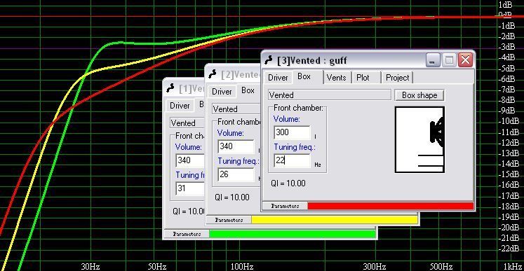

Hi AT,
Just some musings (sounds more like a Bessel than a Chebyshev) :
With a 340L cabinet and each driver Vas ~ 200L, not much point not using both.
How have you added the 120g ? Seems a good idea to do to both.
Closing off one port will tune to ~ 22Hz. Alternatively line the ports with 3cm foam.
What I would do : modify the feedback loop of the driving amplifier with an RC circuit
to boost low bass, say 12dB centred on say 36Hz. This will intereact with the low
bass roll-off of the amplifier to give a gently peaking active bass boost.
(Or simply use a passive line level circuit prior to the amplifier).
20Hz a few dB down (for room gain) should be no problem. (graph - Fs=32Hz, Qts=0.31)
🙂/sreten.

richie00boy said:Andrew, if you have plenty of SPL to spare - just desire some deeper bass, I would look seriously at leaving the cones alone (no added mass) and keeping both drivers in the box and sealing it off. Then add a Linkwitz Transform.
Model it. Its a very poor solution compared to what I suggested.
And it would not be a "linkwitz transform", simply bass boost.
🙂/sreten.
AndrewT said:
I suspect I can seal off one port effectively and make it sufficiently strong and airtight .......
You do not need to seal off a port. Line both of them with ~ 3cm foam.
350w in a domestic enviroment with these speakers is ludicrous.
Though you would need it if you went sealed. ~ same as 50W vented.
🙂/sreten.
Andrew,
Can you confirm if the cabinet already has the two drivers in?
It's not a poor solution if he doesn't want to mess with the cabinet or the amplifier.
And how can you say it's not an LT, surely if he builds an LT and designs it properly, what else can it be? 😕

My first experiment with just one modified driver with the wrong port tuning is massively better than the original (it goes much lower down and seems on tiny power to go louder than the active mains.
I know and expect it can become better yet.

Andrew, most of what you say above is correct, except the bit about boosting.
If you do manage to lower Fs with addes mass etc, and thus can tune the vent lower to supplant output to achieve more deep bass SPL, there is a danger that somewhere above tuning you might run out of Xmax.
At the end of the day, whether you add mass to manipulate Fs, or apply EQ, Xmax is unchanged. And for a given Xmax, Vas, box volume and tuning frequency the danger of over excursion is the same - the boosted case simply uses more input power.
Your only saving grace with the added mass method is that Vas will be increased, which could mean there is sufficient air load to prevent Xmax being reached above tuning.
Some extensive simulation is needed.

Back to the guidance I need.
f I were to manipulate the T/S parameters by adjusting Fs and the Qs, I suspect, nay am convinced, that improved low frequency response (and low frequency SPL) is available from this box and driver set up than the optimised set up that the standard model has achieved for music reinforcement.
Absolutely.
Starting off with a lower FS is always a good idea if you are after low bass.
What are the main speakers and intended c/o point ?
Retuning to 22Hz will increase max SPL at low frequencies.
The other changes really just increase efficiency low down.
🙂/sreten.

richie00boy said:.....what I should have said is that the required box is now bigger due to the increased Qts......
True. The box is too big for the "standard" drivers in terms of
alignments, i.e. driver Vas and Qts do not suit the box. One
reason why two drivers is better than one. By adding mass
and increasing Qts the match to the "too big" box improves.
At the time Fbox (sealed) drops - always good for transient response.
The added mass route (and both drivers) is the way to go.
🙂/sreten.
