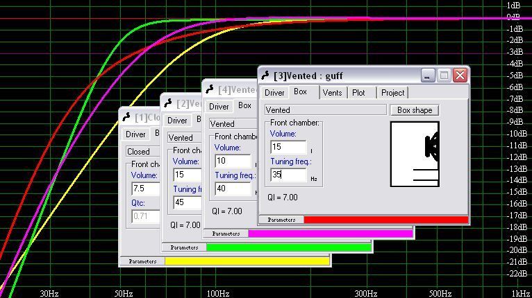

Hi Sreten,
Could you explain?
is this to do with room effects?some alignments - i don't like the classic green one, prefer the red
Could you explain?
AndrewT said:Hi Sreten, is this to do with room effects?
Could you explain?
Yes, better match with room gain, less group delay, i,e better transient
response, lower effective cut-off point, better low bass power handling
(at the expense of upper bass) so less bass overload etc.....
In practise the red does kick drum in a fashion, the green doesn't IMO.
🙂/sreten.

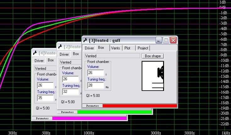

REALFLEO said:I know but I can't find where.

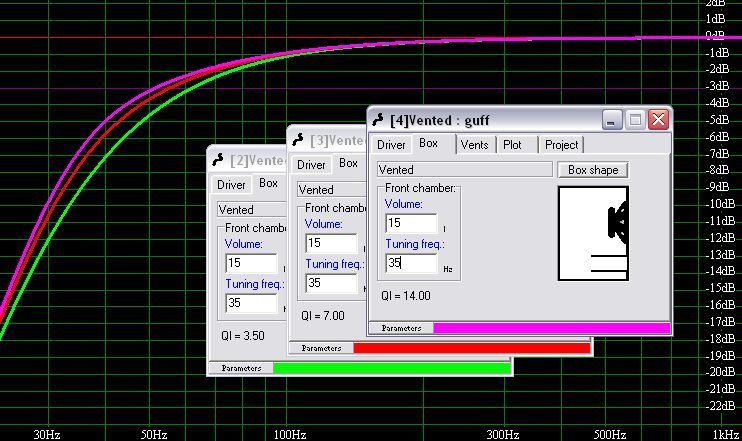

Maybe you did the calculations wrongly. There is a full T/S procedure and Ql calculation spreadsheet on my website www.readresearch.co.uk just try your data in the Ql calc spreadsheet first.
Hi, your box - note Ql = 5, /sreten.
The thing is I'm not using a tuning freq. of 28Hz but 40.6Hz. Could it be the reason why my Ql is so weird=-0.12 ?
Wich program are you using ?
Do you use special ratio when designing your box ?
Thanks for your help.
REALFLEO
