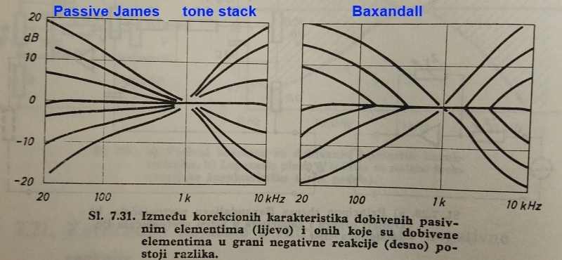

There is a difference in curves between Baxandall and James tone stack (passive or in the NFB).
Not in the maximum positions of potentiometers, but for example at half max.
I will try to find picture for that.

Curves in James tone stack and Baxandall are different.
With James turnover frequency is fixed, with Baxandall it vary depending on potentiometer position.

Is this?There is a difference in curves between Baxandall and James tone stack (passive or in the NFB).

original bax circuit (in the 1952's article) was in the NFB of valve but a passive version exists (this is the james tone stack tab in the TSC software). The passive version shall use Log potentiometers. Linear are better for active version.Did you read Baxandall's paper. He's all about the NFB.
Clearly most folks here do not want to think in terms of math. 🙁
You can always use CCW pots(counter clockwise log) pots with caps and resistors with a 10 to 1 ratio to get a flat position with a gain of 20db ie 10x. Crown did this in the IC150 preamp. I also did it in the 70's when tape decks and tuners put out 0.250 Volts or so. CCW pots are harder to find.
Not again please. The James control predates the Baxanlall by several years and is not a version of it in any way shape or form, nor the converse. They are completely different beasts. The need for log vs linear pots is evidence enough on its own.original bax circuit (in the 1952's article) was in the NFB of valve but a passive version exists (this is the james tone stack tab in the TSC software). The passive version shall use Log potentiometers. Linear are better for active version.

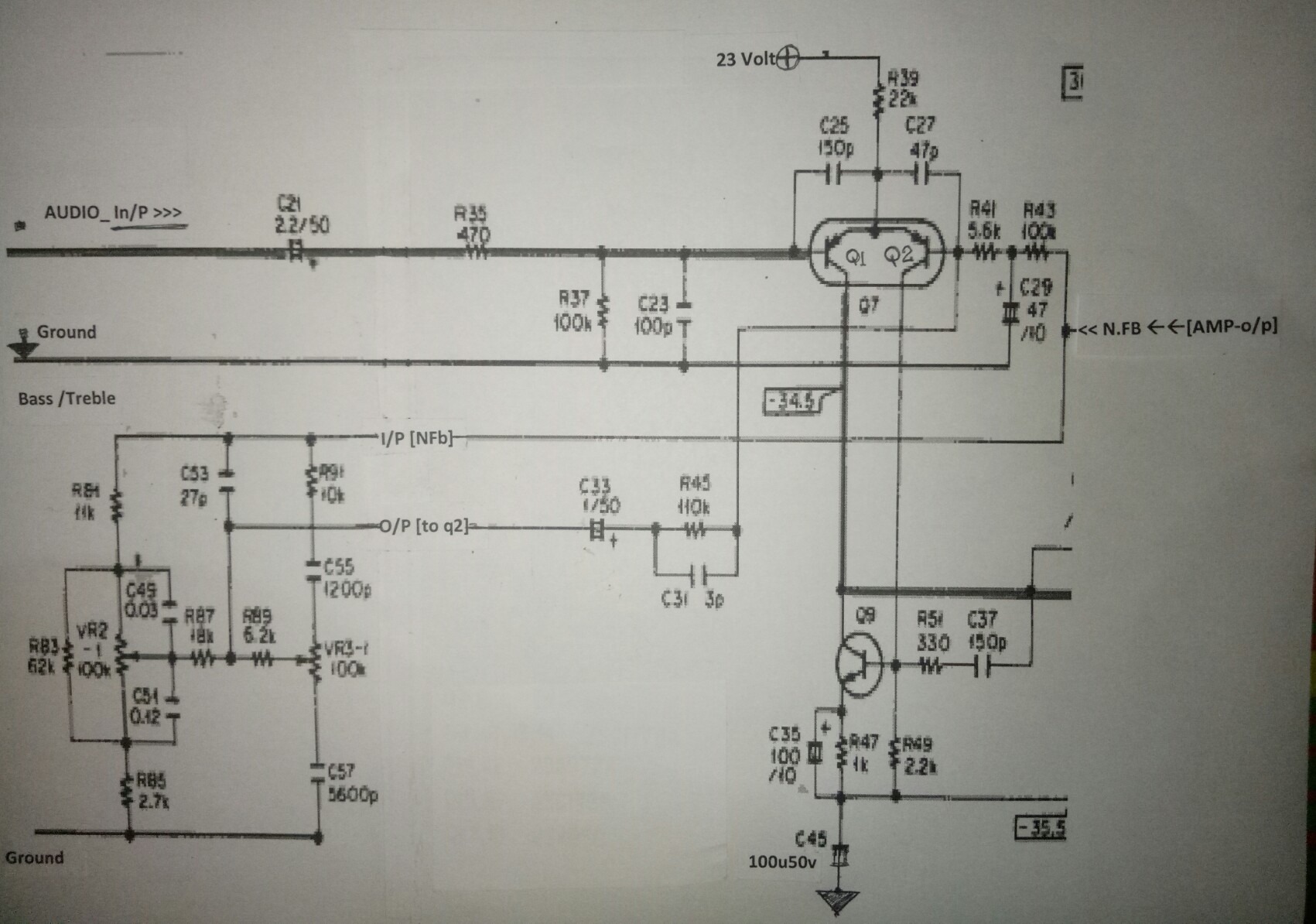

With reference from another member another thread,I located feedback Tone control of Pioneer sa520 successfully used in their amps 1970s.
