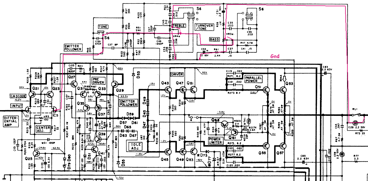

A majority of MONO hi-fi used James or similar. With the rise of STEREO, the poor tracking of audio-taper pots led to most hi-fis using LINear in the Baxandall connection.
...the only place I've ever seen a tone control entirely in the feedback network was the treble control of the Radford SC-22. And you certainly can't put them in the feedback network of a power amplifier.
ejp: I guess you never came across any Kenwood amps (KA-1000) for instance, or the like, which used those types of "feedback" tone controls.
Tone all in line-amp NFB is seen in Dynaco and in QUAD.
There's a whole family of hi-fi boxes using tone in POWER AMP NFB loop. A couple very careful high-end designs (eg KA1000), and a lot of cut-cost boxes for undemanding users. Another 90 degrees phase shift *only* 1kHz-10kHz is not really a tough loop problem with modern transistors.
I had it.The best amp i ever listened to, compared to anything i listened up to 60 000 pounds nowadays amps.This is no joke! And Kenwood made even better amps than KA-1000!ejp: I guess you never came across any Kenwood amps (KA-1000) for instance, or the like, which used those types of "feedback" tone controls.

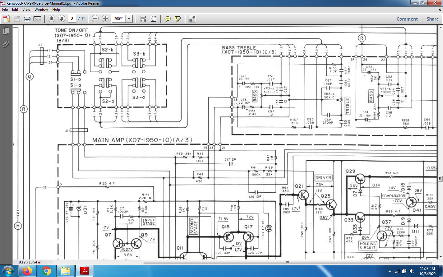

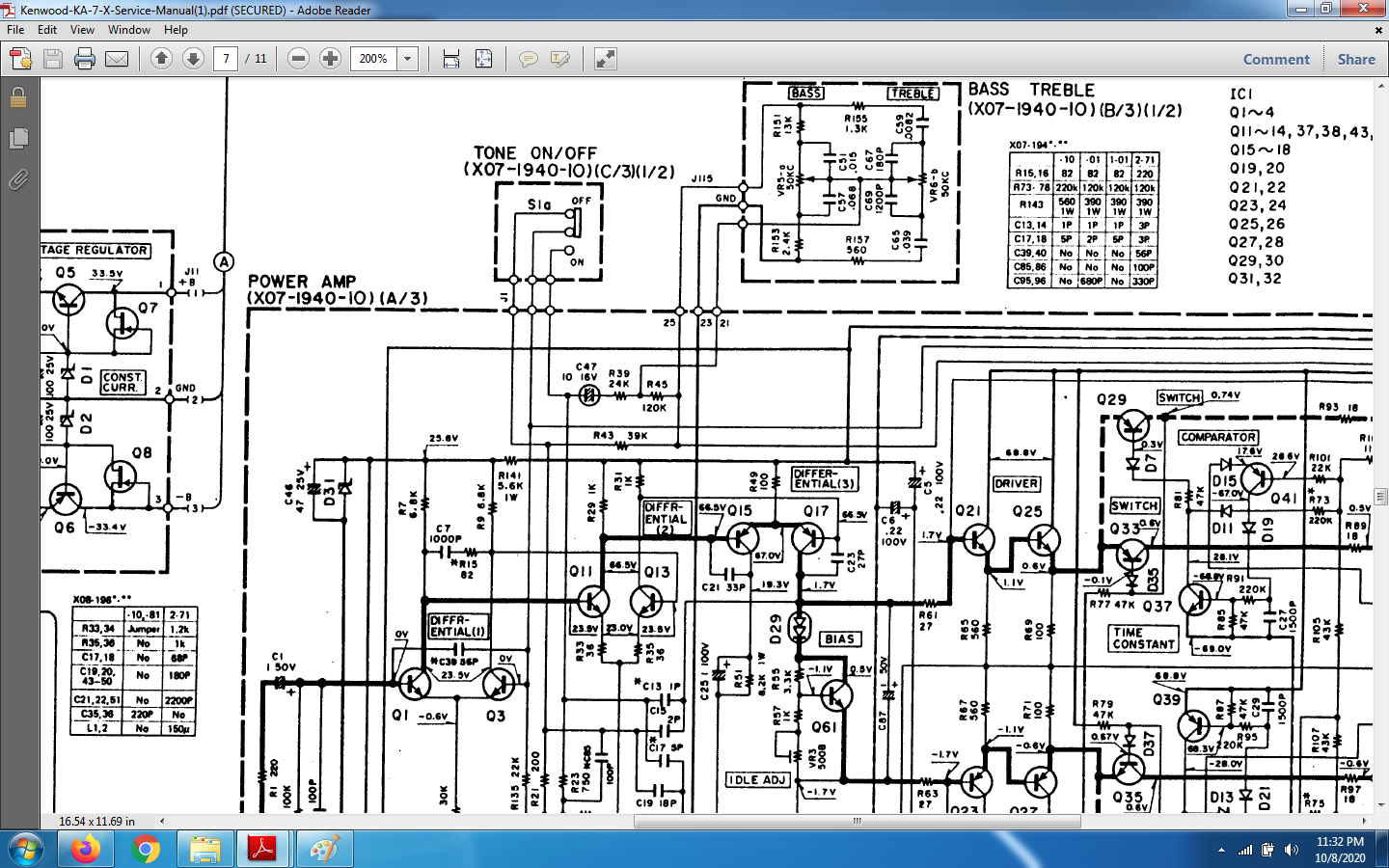

there's another kenwood model using almost the same tone stack ka-9x. and a simplified version ka-7x and also a very interesting very low impedance version indicated to me by user olddiy , kr5030 .You might like the ka-9x schematic as it contains some of the best features found in L-02a and the turnover settings of ka-1000, but the true beasts of the series, the L-02a, l-08m and l-06m have no tone control at all.There's a whole family of hi-fi boxes using tone in POWER AMP NFB loop. A couple very careful high-end designs (eg KA1000), and a lot of cut-cost boxes for undemanding users. Another 90 degrees phase shift *only* 1kHz-10kHz is not really a tough loop problem with modern transistors.
Unfortunately the L-06m schematic is nowhere to be found although it's the best amp kenwood ever did and even better than the best later Accuphase amps...

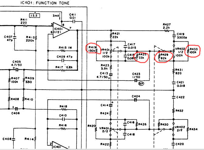

Here is Pioneer A44 integrated amp, with those type of tone controls.
Tone stack here is in the NFB of preamplifier, but principle is the same as in the NFB of power amp (in integrated amplifier or receiver).
(This Pioneer tone stack is used in many of their models, A series, sometimes in the this NFB tone controls, and sometimes as the passive tone controls.)
Those additional resistors with potentiometers make me believe that those pots are Linear?
