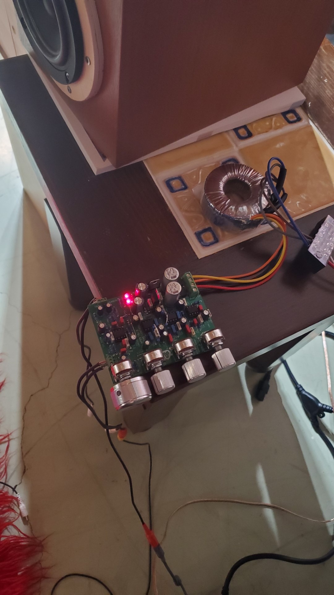

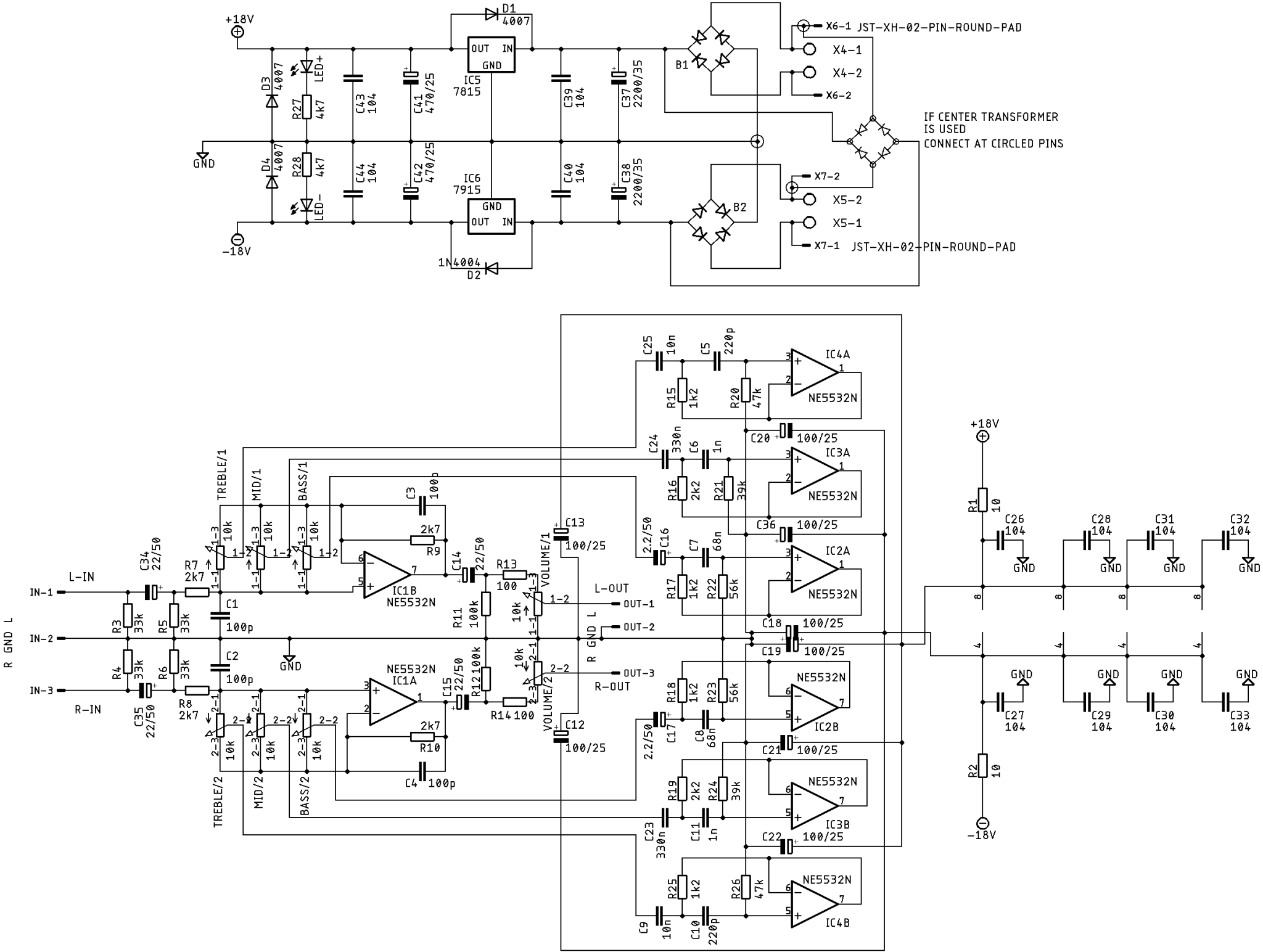

if you do a search, you will see that i like to refer people to the tone control design in old APT preamp schematic. It adds a unity gain buffer to eliminate the interaction normally seen in the Baxandall tone control scheme. the comments about limiting the active range should be seriously considered; i wouldn't have more than +/- 6 to 8dB MAX boost/cut range at whatever turnover frequencies you choose. good luck!

The amplifier I'm currently working on has a switchable tone control, which is made according to a different from Baxandall circuit.
The tone control circuit was simulated in RFSim99, assembled and fully verified. The adjustment range is from -6dB to +10dB. I think this is enough for a small correction. Unlike other types of tone controls, the circuit I used does not introduce any distortion at zero positions of the controls.
