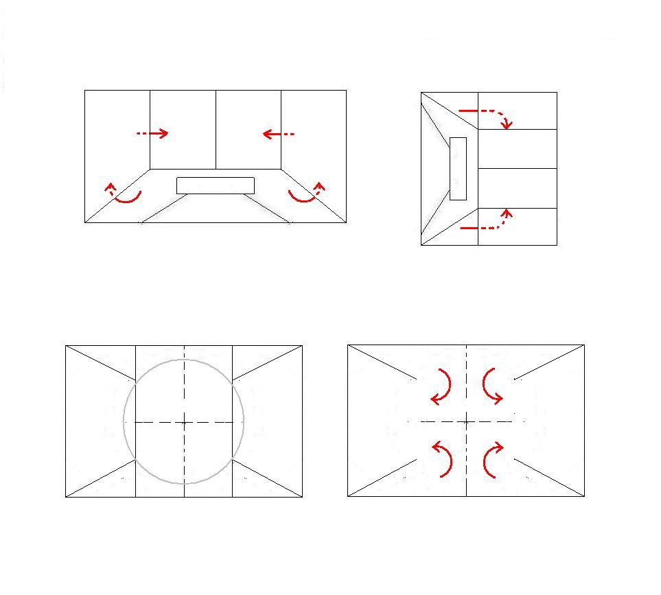

Here is a website that should be checked out by anyone wanting to build their own bass cab. The fEarful project is fairly recent and is the subject of many threads over on the talkbass forum. There are lots of contributions from builders with pics and tips and reviews etc. I myself am planning on building two of the 15/6 tube cabs this summer when the weather improves.
fEARful enclosures for bass/drums/keys
Here's the designers web site. He has in essence contributed the designs to the bass playing DIY community.

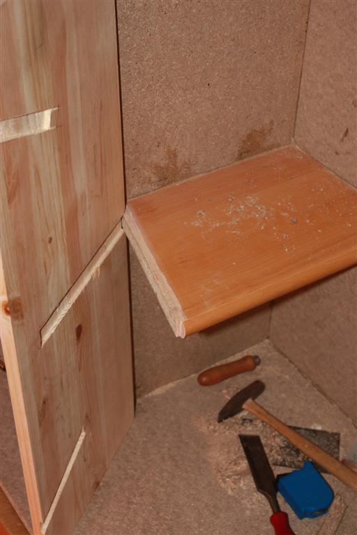

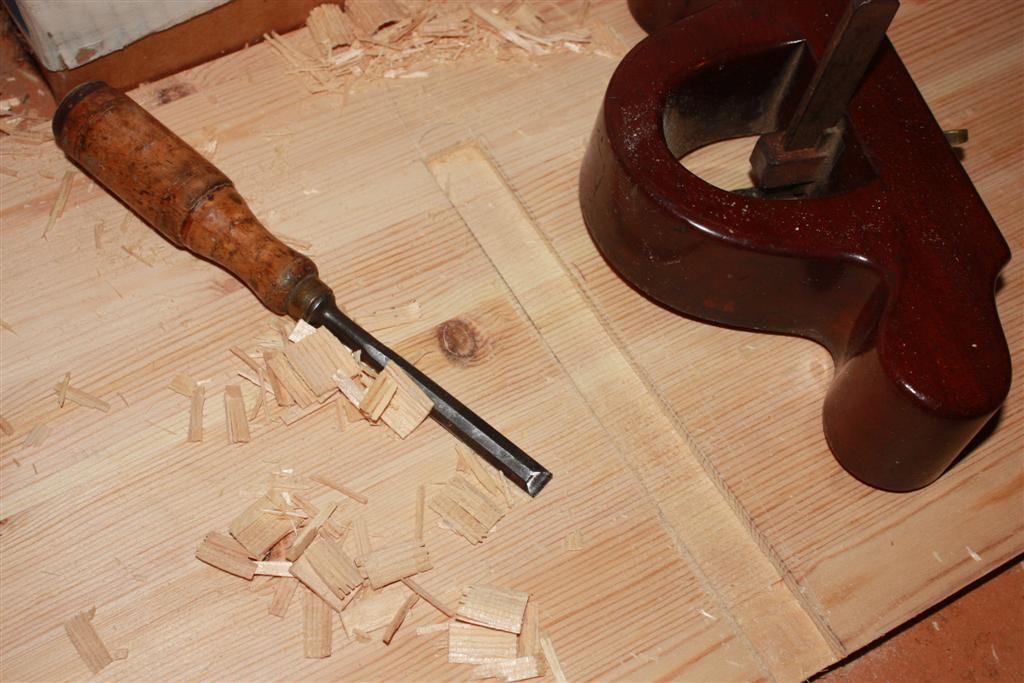

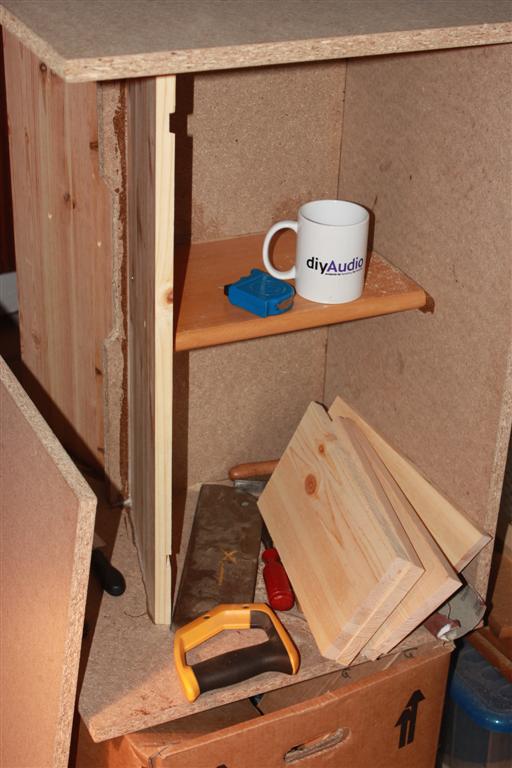

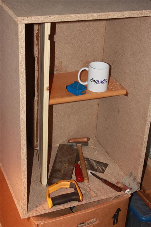

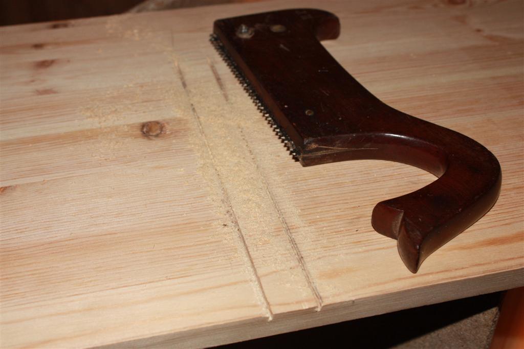

good one

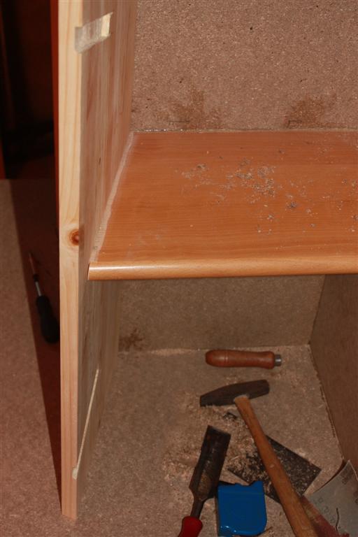

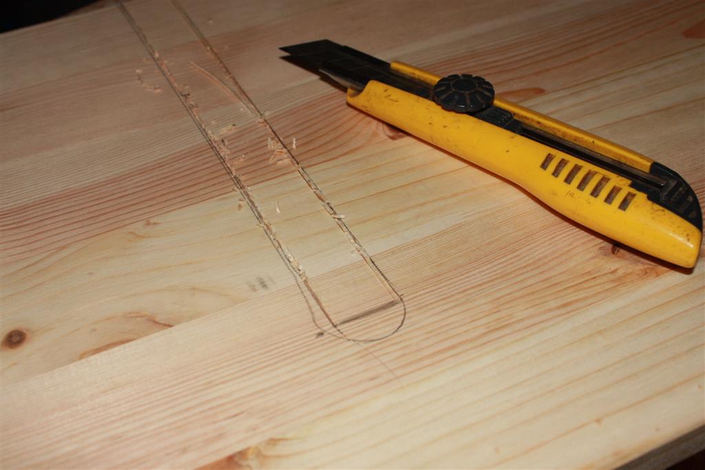

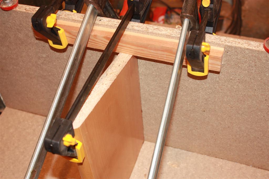

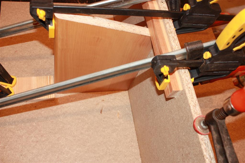

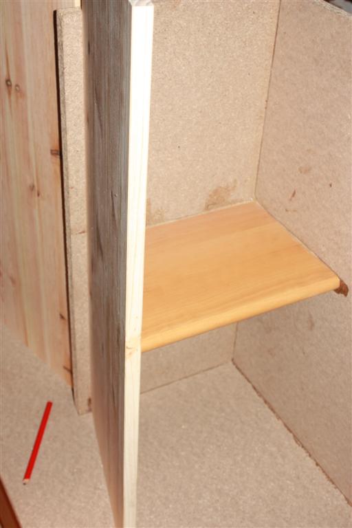

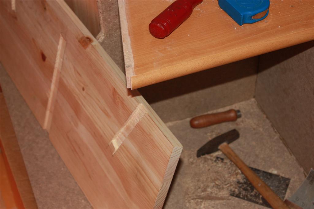

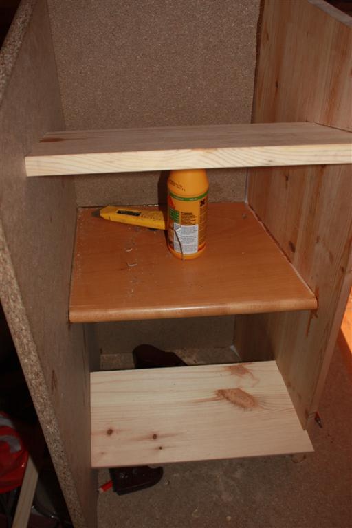

some working pictures
who needs a router when you have proper tools 😀
hey, I love them old tools....no nasty router dust

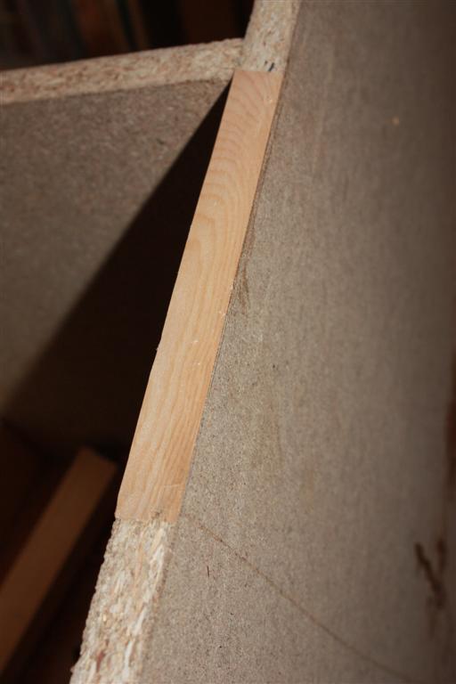

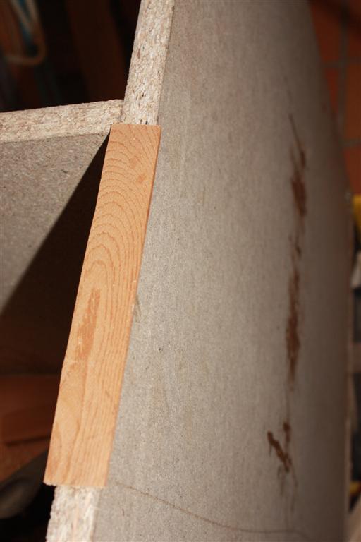

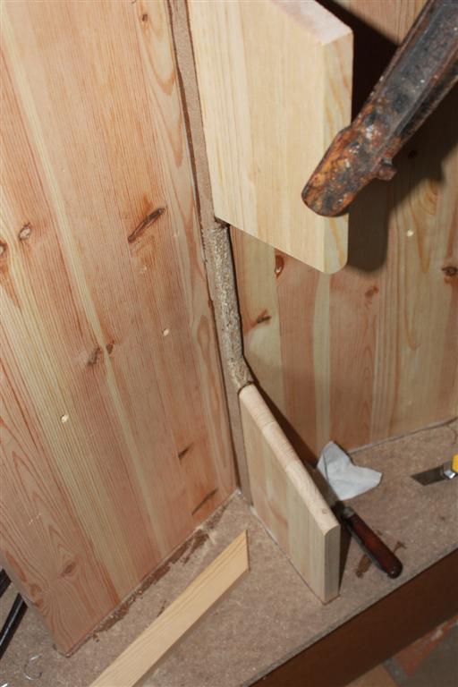

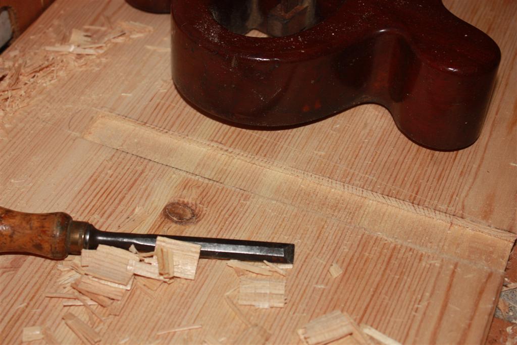

hey
I found that I made 'a hack'
well, its all cut with a hand saw
and I 'level' all cuts afterwards, with a router
works ok
though, the 'hack' was still there
so, some thick veneer and glue, and sorted
