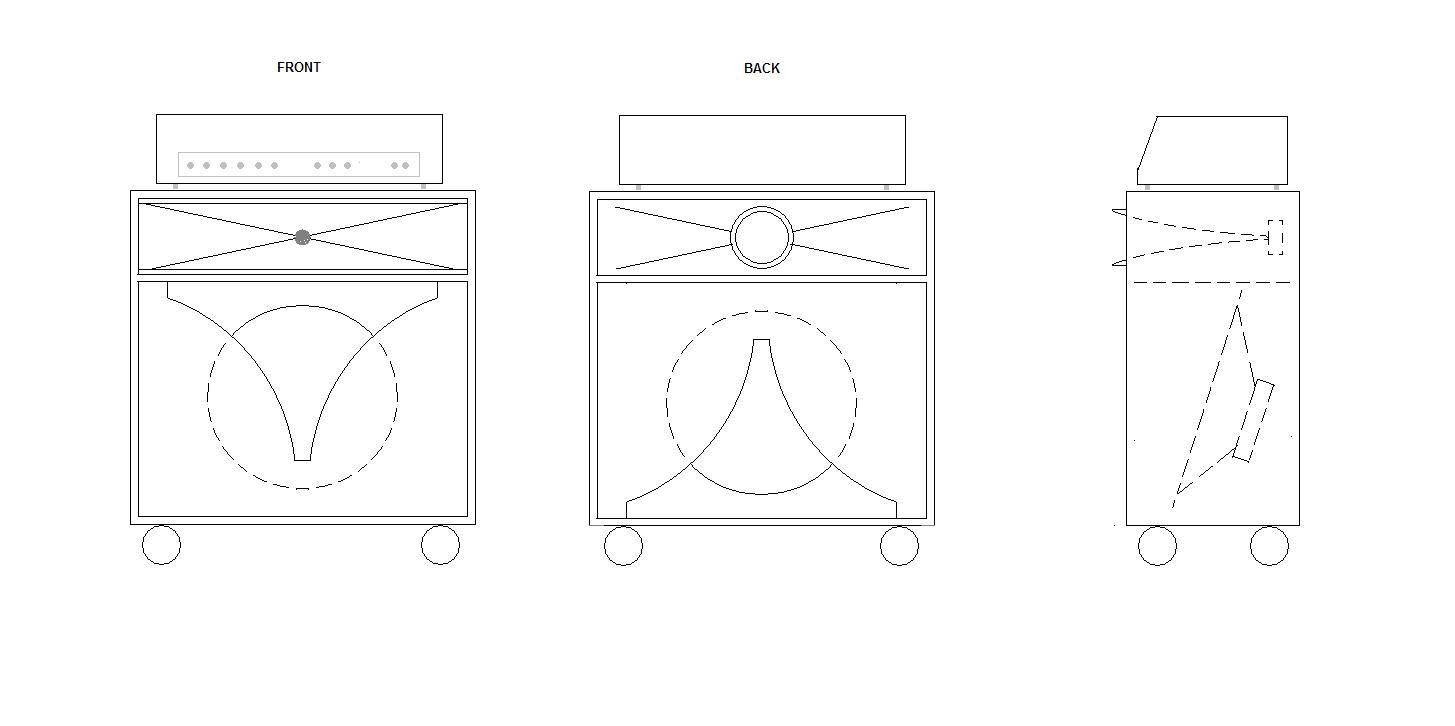

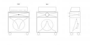

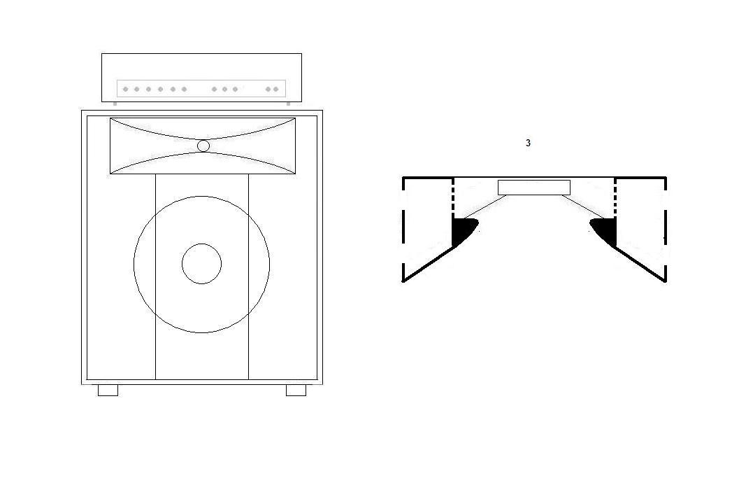

Wheels? Are you in a sixties cover band?
yeah, wheels are cool 😀...nah, makes the drawing look more real 😉
but I have some funny little wheels you barely notice 😛

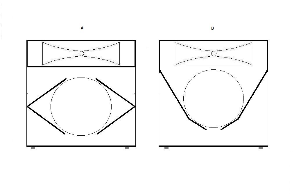

shoot, more ideas
now Im getting really indecisive
any opinions that could help me choose one ?

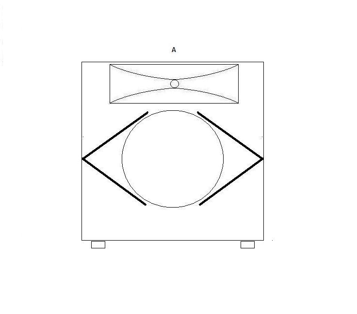

well, version A would be a really easy build
me like it

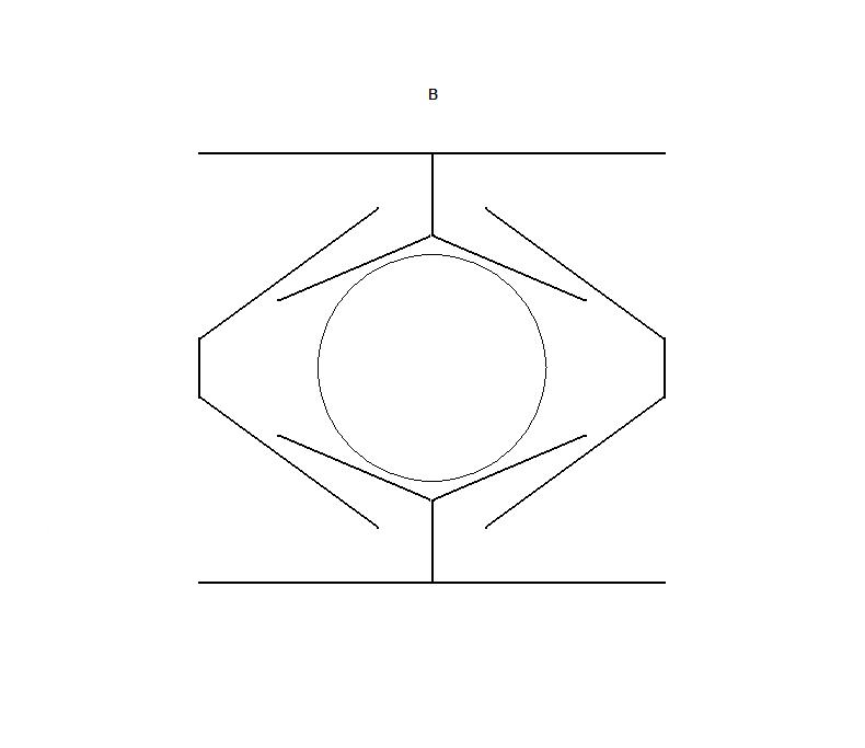

oh, ok, ofcourse thats not very clear
those indicate inner baffles
and, the box is open at both sides, in all drawings
BVR, midbass horn, folded dipole, open bass bin
I have no idea what to call it
What are the triangular lines either side of the bass driver?
Hmm, I'd guess a rear loaded horn. A compression chamber in the centre, loaded by two slots at the top and bottom that drive short mid range horns. Might well be quite crisp with all that upper mid, I'd knock up a test box if I were you. 😉
The horn is short and of low mouth area.
It will make a good Mid range horn for a Mid range driver, if properly dimensioned.
The horn is too short and too small a mouth (truncated excessively) to act as a bass horn.
actually for a heavy cabinet wheels are a great idea. with a bass cab, they should be lockable.

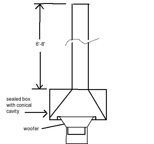

with bass, you don't need high wattages if your speakers can move large volumes of air efficiently. i've tried the device shown below as an experiment, but the real challenge will be to make it in a roadworthy version. i know it's a crude drawing, but you see where i'm going with it... the experimental version is used as a sub for a 50 watt receiver, and with a simple LC crossover, requires no bass boost to adequately fill a room. the vertical tube is made from industrial shrink wrap cores (4" diameter heavy wall cardboard tubes)
looks..ehh, B I G 😀 Im sure its good, but looks more like a sub than instrument speaker

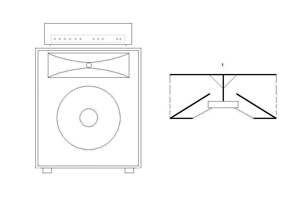

A general thought on the open-back/side idea...
Wouldn't this allow the driver to mechanically unload? And surely that'd be the last thing you'd want for bass guitar use...
Chris
Chris
yes, could be a problem
problem, this woofer needs a very big box
you could say I just bought the wrong woofer
but this is for home use only
I dont play loud, but rather 'silent'
besides, a bass amp will have low cut filter, right ?
anyway, I want to investigate if it would also do music/hifi with small amps 😉

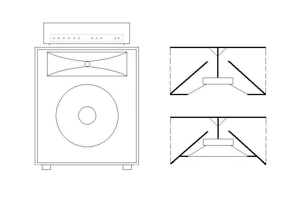

Chris
hmm, I have been aware of that
but what I wasnt aware of is that my present 'thoughts' are approaching a size that would make a closed design possible
I will do some calculations, again
btw, the one with 'open side', midbass waveguides shows low cut around 120hz
maybe it really would work

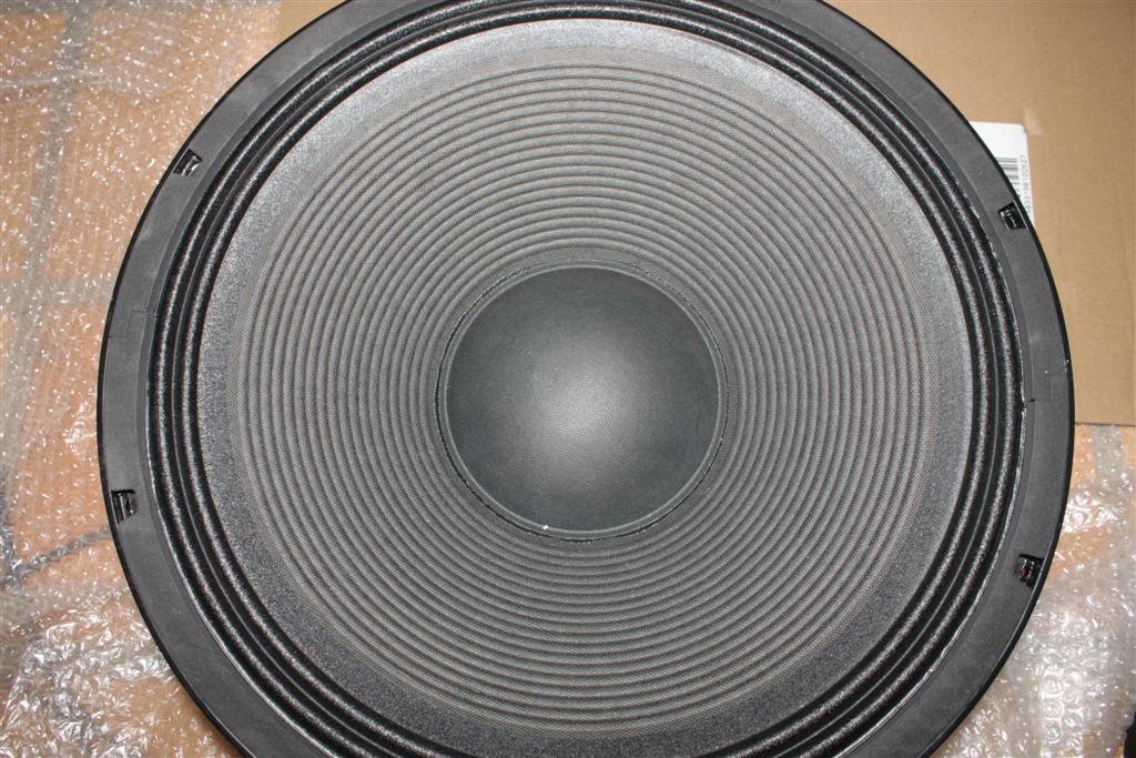

woofer is this one
the 'easy' solution
local pickup, no shipping, cheaper
SPA-15PA

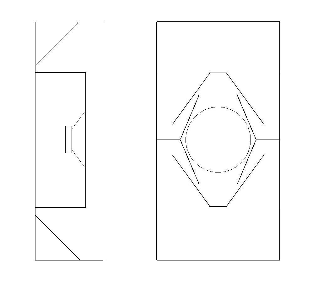

[/url]

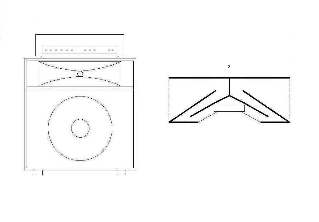

which could look like this
but now I may be facing trouble with the woofer's high Qts
but its not a front horn with a 'compression' chamber
more like a folded fronthorn, with open back, but reversed
I wonder if that will make up for some of dipole roll off 😕
and maybe even take care of some of he issues with the unloaded low end
but probably not, since its still a free air system, below the mid horn low cut off
or is it ?

Hmm, if it's for home use, then even on a simple baffle, it will probably be enough for practice levels. It would probably be an idea to keep really low bass away from it, though...
Methinks you should start building stuff, find out what does what. I think I'd try a simple sealed design first, add stuffing, and if there's still a bump in response from Q>0.7, then you could play with eq if you wanted rid of it.
Chris
Chris
Chris
yes yes, and soon 😀
right now the woofer is just standing on the floor, on its magnet
works fairly well, apart from the ressonating when loud
