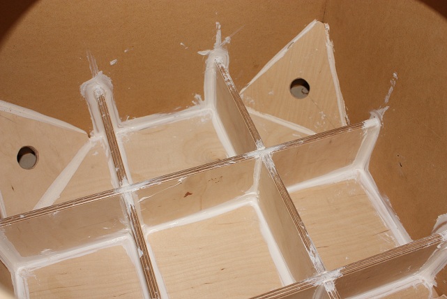

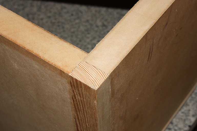

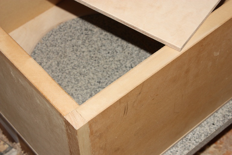

... it was an effort to eliminate resonances from the cabinet materials....
good point ;)
built a crappy proto, and now being punished with this rework job :clown:

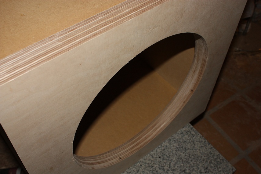

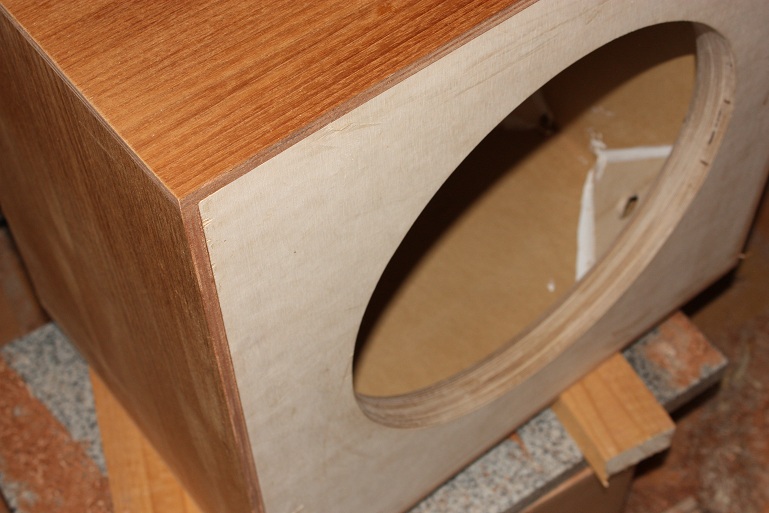

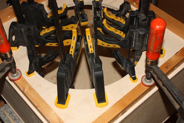

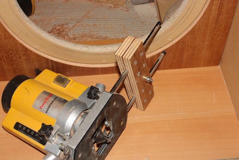

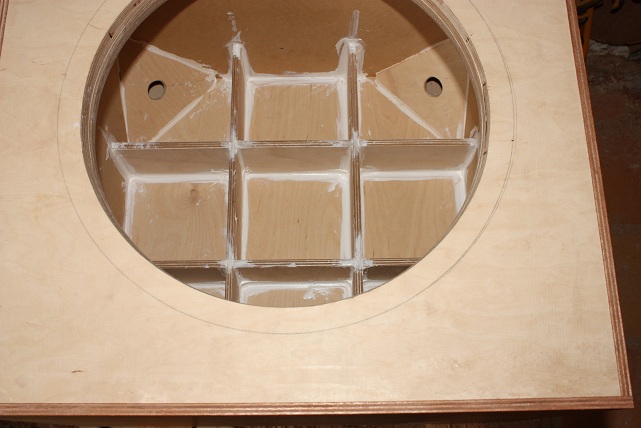

front is sorted, and decided to look at the cabinet back

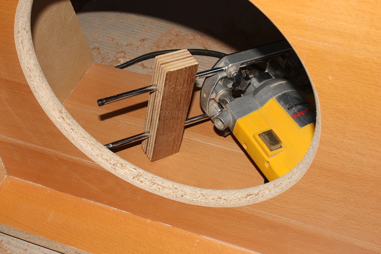

first step, to make the woofer hole slightly bigger, and improve edge shape

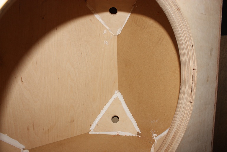

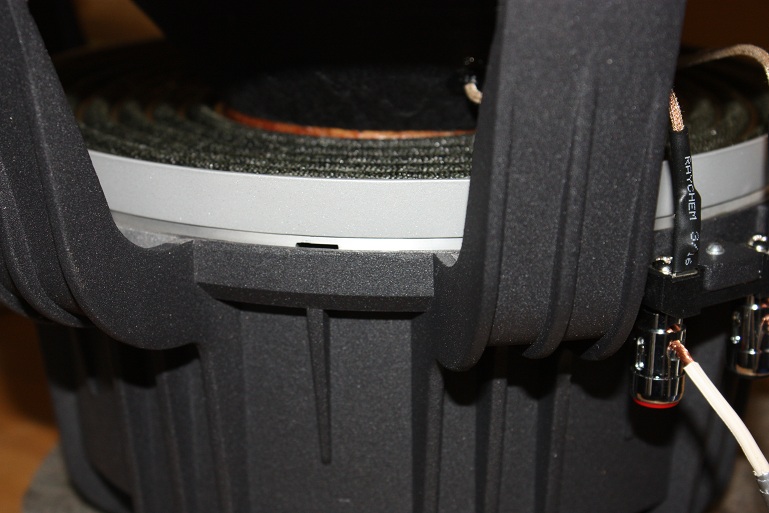

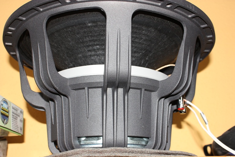

big heavy woofer, and I wanted to support the chassis, taking some load off the screws
working inside a limited space, new circle router tool needed
and then some work with file and sandpaper :eek::D

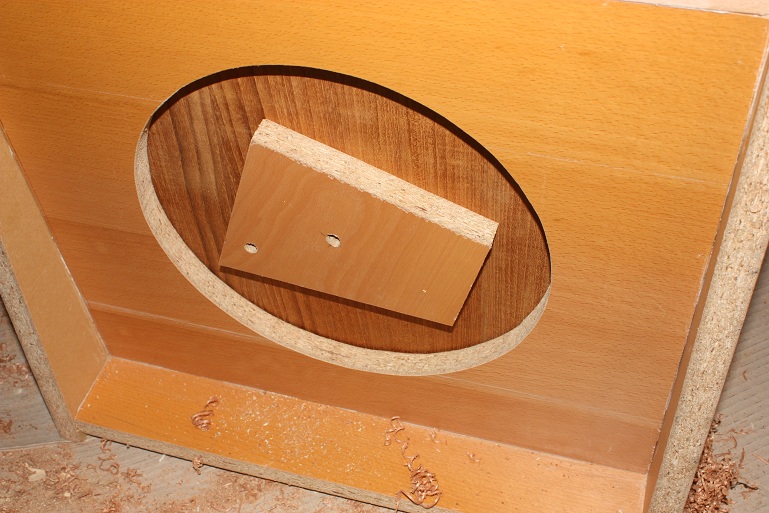

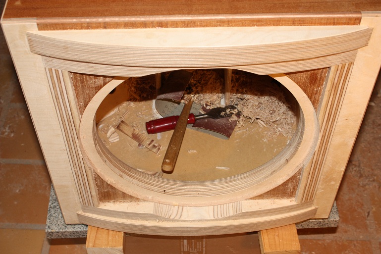

need to consider speaker cable connector
noticed a speakon which also accept a 1/4" jack
but I dont know much about this
btw, theres a really nasty ressonance when talking into cabinet
but if inserting a small bucket into the hole, it disappears
which also ought to happen with the woofer mounted

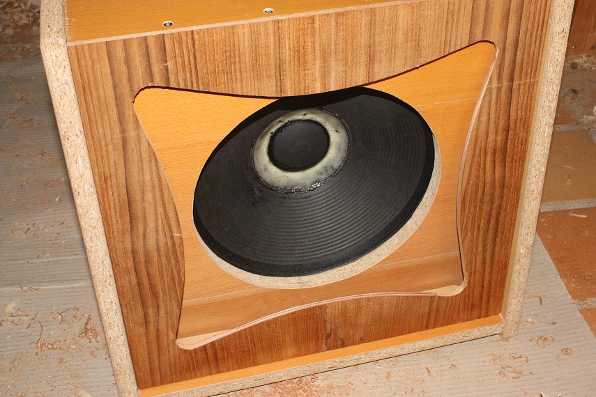

need to work on front baffle design now
