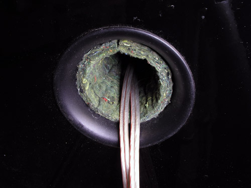

Yes, you can, but with the 10.2 it's approaching a QB3 alignment which is rarely practical. I'd aim for an Fb of 36Hz; assuming a 50mm diameter vent that's going to be 250mm long, which is a bit OTT for my taste. An alternative may be to line the vent with damping, i.e. roll up some felt damping material and insert, like this, courtesy of Troels Gravesen's site:

Thanks Dave, Scott,Octavia... OK, just did a crash google course of QB3 (how did we do this pre-internet???). So wandering into a QB3 alignment can produce boominess and an under-damped sound in the search for an 'artificial' level of bass... correct?
No, not my taste either.
So I assume the damping in the tube is to reduce that boominess and give more damping?
That's what I'll do then, start off with the longer port (180 I think) and play around with lining it, given that that's an easy retro-adjustment.
