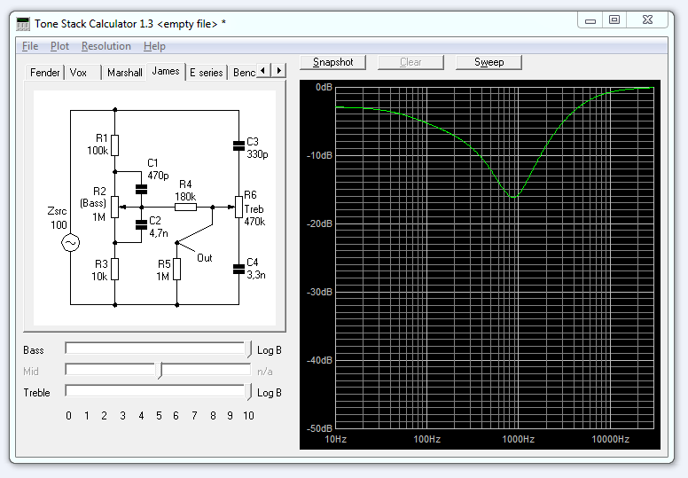

I have experimented with a graphical eq to find a suitable curve and using Duncan's Tone Stack calculator (assuming an output impedance of 100 Ohms from the first op-amp stage) I have designed this curcuit:
attachment.php

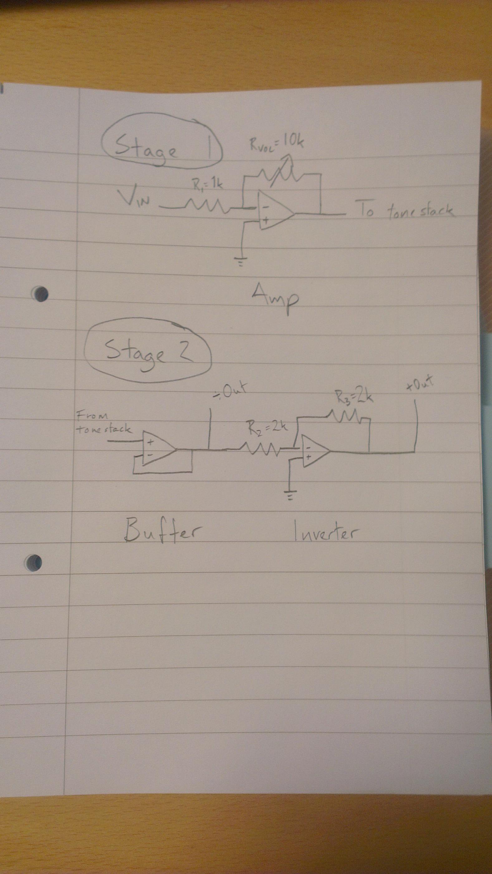

This circuit has a loss of -3db (-0.7X gain) at low frequencies (with bass control at max) and so to compensate for this we need to raise the gain from 6.6X to: 6.6X/0.7 = 9.4X or ~10X (20db). My first attempt at a circuit looks like this:
attachment.php
Questions:
- Are my gain calulations ok?
- Am i running into any impedance matching issues? See the notes on ICEPower input impedance below.
- Are the values chosen (1k + 10k) for R1 and RVOL ok? Would it be better to use 200 + 2k?
After doing some research, I've found two flaws in my design:
1) Non-inverting op-amp stages need a DC bias-current return path, so their positive input should be tied to ground using a high-value resistor (effectively determining the input impedance of the stage), ref. Planet Analog - Articles - Avoid common problems when designing op-amp and in-amp circuits.
2) The input-impedance of an Inverting op-amp stage is determined by the resistor connected between the signal source and the negative input, ref. http://zebu.uoregon.edu/~rayfrey/431/notes9.pdf. In my case this means that the bass guitar sees a 1k input impedance, which is way too low, so I need to put a non-inverting buffer as the first stage in the circuit.
I don't quite see where you get the idea of 1K impedance from?, there's no need for that, design it to ba as you wish.
However, I can't see why on earth you would want to use a passive tone control anyway, which would certainly need a buffer (even though it's fairly high impedance, it needs to be fed from a low impedance source.
Why not just look at what commercial amps do?, or have a look at Albert Kreuzer's FET and opamp design (which is easily alterable as you like).
An active Baxandall is dead easy to do using an opamp. This is the first hit on Google:
They have the advantage of using linear pots, which are much more accurate and easier to get hold of.
You would need an input buffer, but thats no big deal if youre using opamps. You could realise the whole thing using a two opamp chip.
Or, a FET or even bipolar input buffer would be easy to do too.

I'm open for any suggestions. Basically all I want is a high impedance input, 10X gain, a tone control giving a response curve similar to the one in the attached screenshot and a balanced output... 🙂

Check out the FET preamp I mentioned, and use just the parts you want - it's trivial to add a balanced output if you really want one (but there's not much point really).
