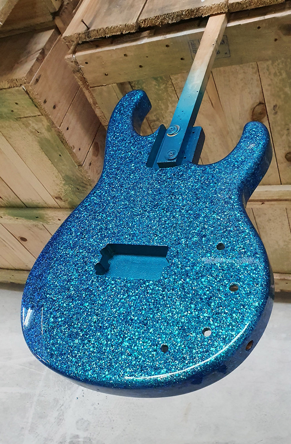

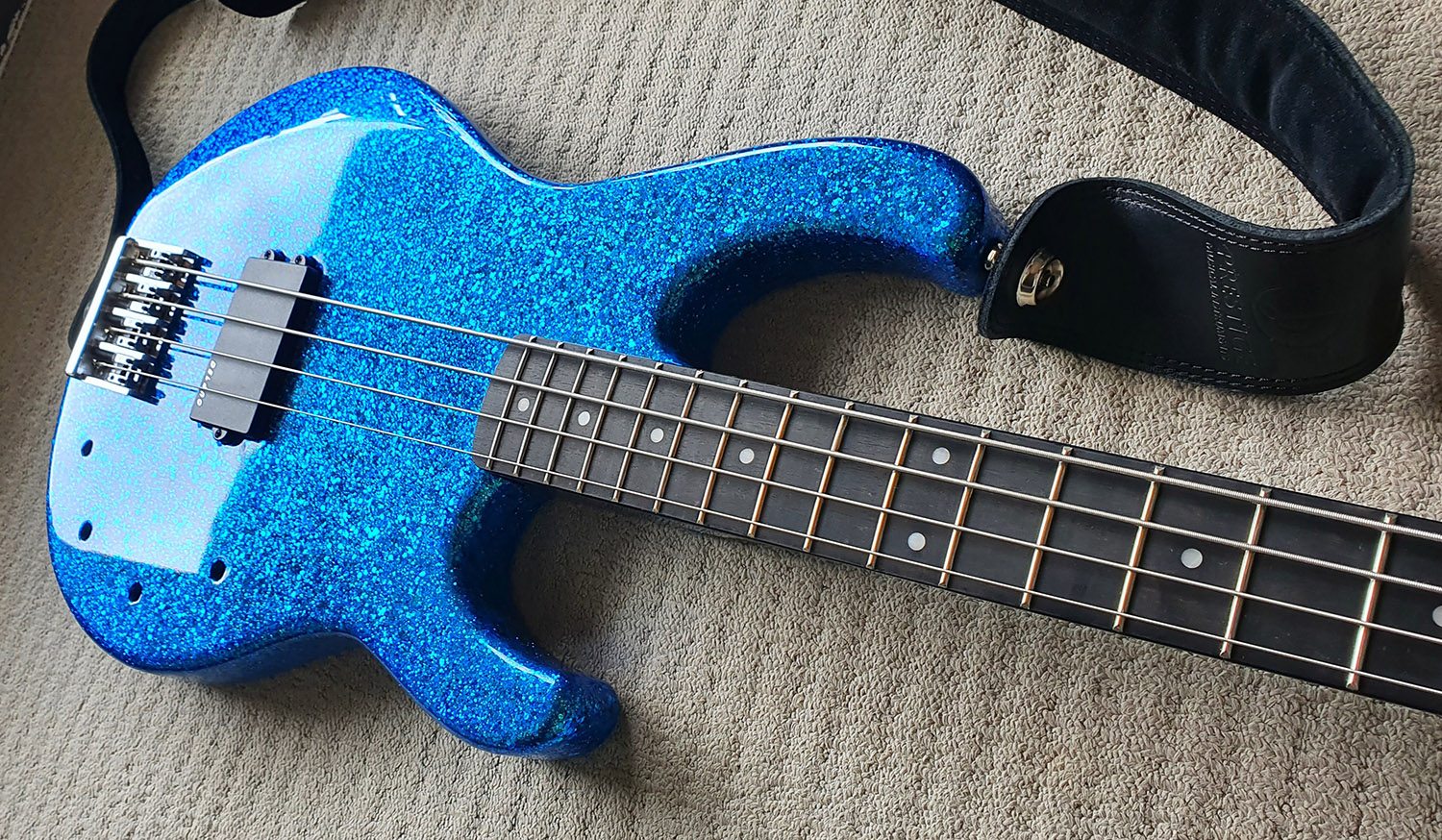

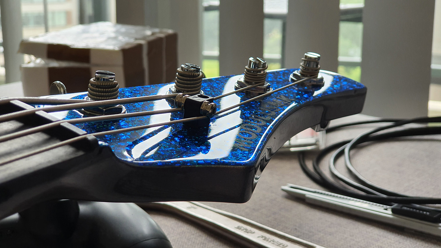

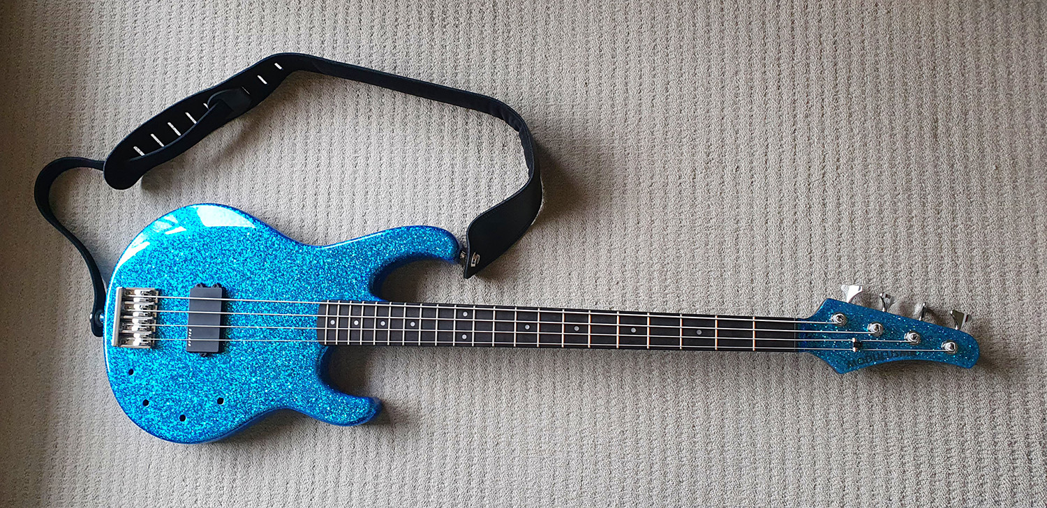

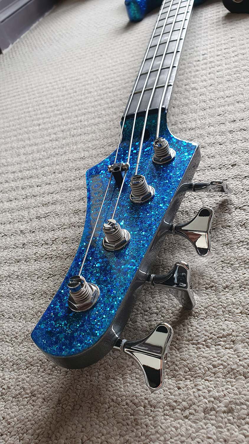

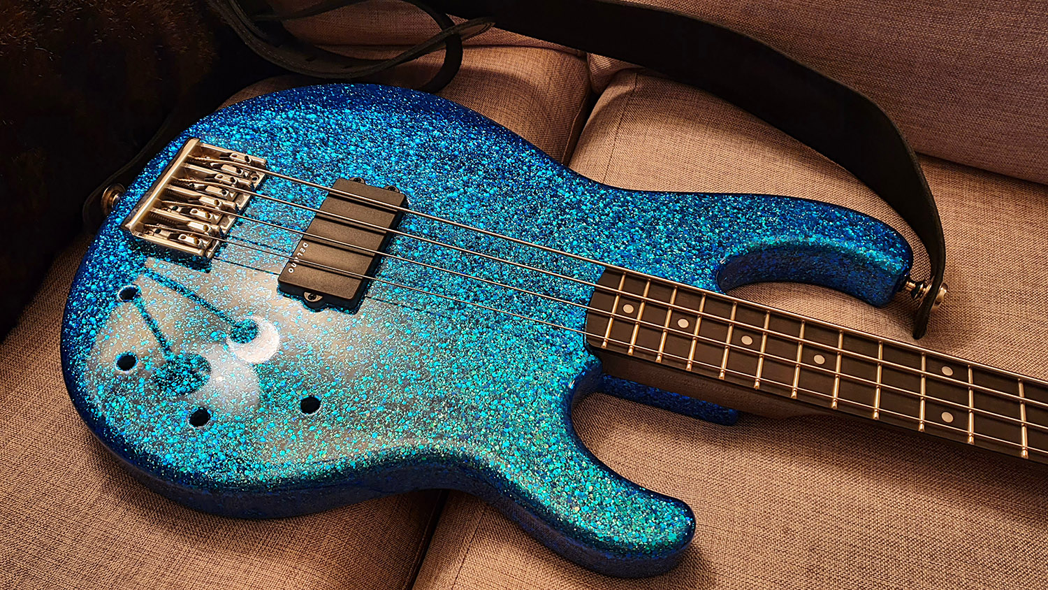

Sure thing, here are some photos of the home made axe haha. It took some time to get it where it is now cause of the huge flakes i used. That's around 10 clear coats or so, then sanded down to smoothness. The actual color is hard to get on camera from these flakes, it's pretty vibrant in person. Bright and open sounding bass, which is what i was after. Those 4 holes are waiting for this electronics, double actually, one opamp and one discreet

Wow! That is spectacular! What a huge time investment .. with a really gorgeous result.

Seriously - Just Beautiful
